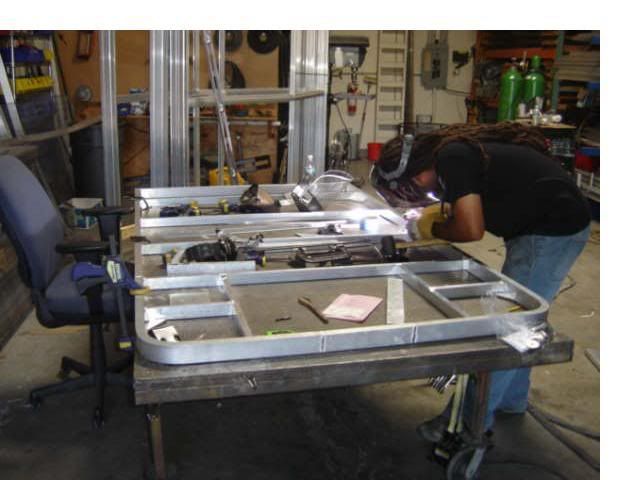

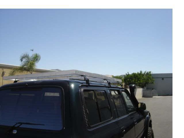

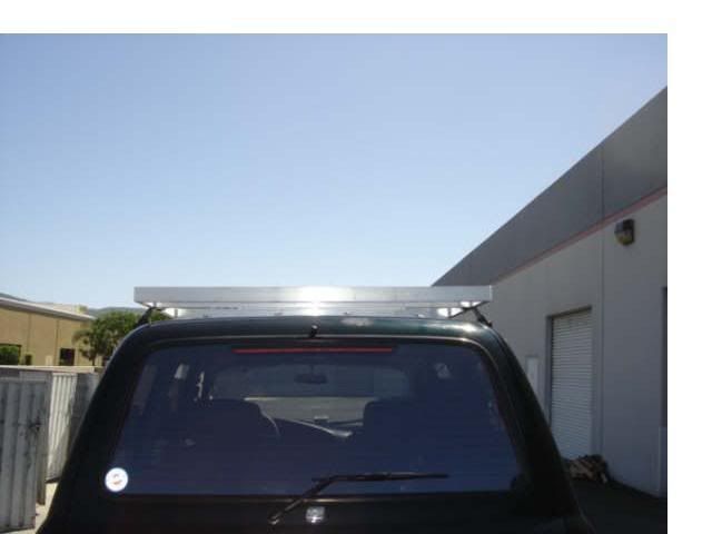

Here are some pictures of the last project, is a full size aluminum roof rack for a Fj80, i am trying to keep it low profile to avoid big wing resistance and wind noise, aluminum to keep it light and rust free, i have to work on the accessories bracket and add some light tabs.

Nice rack. What are you using for the roof rail mounts?
-B-
X2 I don't recognize those mounting feet. I am thinking about ghetto-fabbing an aluminum rack out of 1 of the 2 ATV ramps I have sitting around my folks place in UT. I'll have to do some measuring when I go home for the holidays. I know it can be done by using certain ramps.
I'm still looking into what mounting feet I should use. I'm not too fond of drilling into the roof and I would like to remove the factory rack and seal it up when I do the aluminum rack. So I am leaning towards the gutter mounts like you used. They seem plenty stout as long as you use a full length channel strip to brace it.

Any particular reason you made the back corners square instead of bent?
How much for materials (more or less)?
it looks great, by the way. I've been wanting a rack like that for a while. Good sunroof access hatch, too.
The sun roof hatch have a door and the back corners are square 'cause there is no wind coming from the back( and to cut the cost, the bends are heat treated to avoid wrinkles or cracks) today i got the material that i am going to used for flooring, i should be posting some pics this week, i don't have the cost because i use material that i already have in the shop, i hope is not much so i can offer them for a good price.
