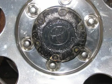

I have a 90's FJ 75 front axle and I need the flanges that bolt on the outside of the hubs. The outside of the flanges are beat to sh#t and one is cracked. does anyone have info on where to find parts? :doh:

Hmm, is this the part that houses the little electric motor for engaging the hubs? If so that part costs about 5-700 each if I remember correctly. Not sure if you can find some used. I do have a conversion kit that I have been working on with spacers and manual hubs. Let me know if interested.

I have not removed them to see what is there internally. Its the outtermost flange that has several bolts. like where the switch would go on a manual hub. I think the model year was 92. I dont have the vehicle becase the story I got was the origional owner bought it directly from japan and had it shipped here.
If the price for these flanges is 5-700 each then I am definately interested in a coversion. that is if it is cost effective.
yup, thats them.

Sorry guys,as far as I understand,I think all zcruz is looking for is the outer cover plate(flange) piece that the 6 torx head screws go thru,not the entire electric hub assembly,if you remove this you see the electric motor pinion and the driven gear..
Also , because the electric hub is 15mm longer than the manual type hub, if you wanted to fit driving flanges you would still need the spacer rings.
These converstions are OK for the average driving, but for hard on 4WDing , big tyres ,lockers etc, they tend to be a weak point.
Like braking the cap screws.
