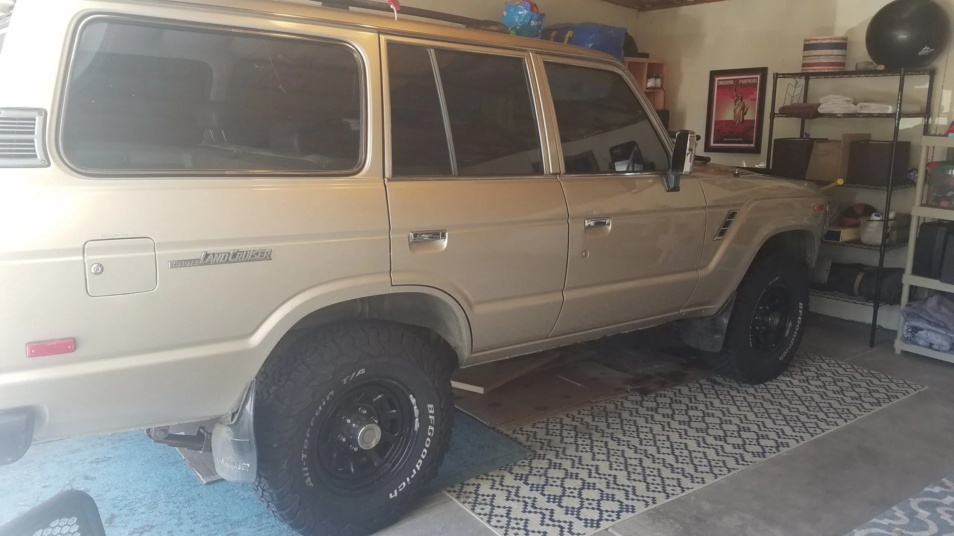

btw...that's a good looking cruiser! You took good care of it.

The tan is one of the best colors.
I can't thank all of you enough for humoring my pissin' and moanin'. Tan? Really? It definitely grew on me, but I was upset when I finally landed on this one in 2004. I really wanted the 2-tone gray, but I kept finding ones with 200k and a prices between 10 and 13k. This one ended up being in my mom's neighbor's garage. It had 100k and he sold for 6k.
