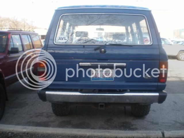

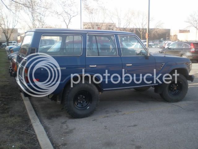

Hey guys. I bought an 85 fj60. It came with an OME suspension kit "just the springs" and aftermarket shackels. The truck is about an inch 1/2 higher than the front and it leans to the front right. Shackels look o.k but I've been told that the right front spring might be bad. Previous owner told me, and I know that the suspension is about a year old.
I want the truck to be as tall as possible, but also even. I want to get brand new OME springs, since they are not that expensive BUT I do not know if I should buy the front springs medium or heavy, reason being is because I will get an ARB bumper and a winch. I called MAN A FRE and the tech mentioned that if I get the heavy springs I shouldn't have to change the shackels to make the 60 look even because the heavy springs have an extra leaf. I was told to get the 4+ super heavy duty anti inversion shackels 6 3/8 for the front and 5 3/8 for the rear if I decided to go with the medium springs.
What do you recommend??? sugestions??? any pics that could help me. I will try to post a pic of my 60 that way you are able to see what the truck looks like.

Thanks blue. I believe is bent 'cause the previous owner used to beat up on that 60 like crazy and he ran into a rock "don't ask why". Know instead of doing one spring only i'll do both for the front.

Thanks Phil. My concern here is to make the 60 even in height front and back, as you can see, mine is higher in the rear. If I get the Heavy Heavy for the front " im only buying the front springs, Im not touching the rear ones", then the 4+ super heavy duty anti inversion shackels 6 3/8 for the front and 5 3/8 for the rear you think it will look even front and back.
I was told by the M-A-F tech that the difference between the medium and heavy front springs are one leaf.
I dont wanna spend money on the 4+ super heavy duty anti inversion shackels and end up the same way I started.

I called ARB, and this is what the tech said. I am running a A and B setting on the rear, and that is how it is supposed to be. However in some cases that setting does not work and a A and A or B and B is required in order for the truck to be even in the rear and front.
Any of you guys hear about this?????
He said that if I replace the B spring for the A spring located on the rear passenger side of the FJ60 that would take care of the problem.

...on my fj60...IIRC I ended up swapping the B to get the matching A's...sits reeeaaalll nice now.
Cardinal, thanks for ur comment. I'm glad I got an answer on that. I was about to change the front leaf. I will get that A spring on monday. By the way, does your FJ60 sit lower up front or is it leveled front and back???

unloaded mine does sit a little higher in the back, not too much. that's with winch/bumper up front and a rear bumper/tire out back and the spare underneath. however, I have Non-OME shackles so I might not be the best comparison. But loaded up, it levels out (loaded with lots of stuff)
On a personal note, when wheeling I don't mind having that loong rear end up in the air a little.
Ur right about that. But if it can be taller in the front that's better. I might mess with the shackels to see what's up. as soon as I am done I'll post some pics
