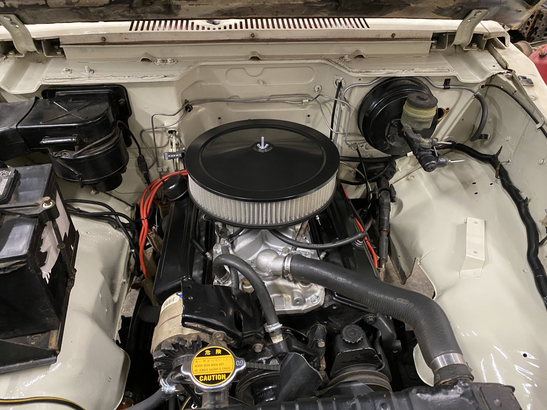

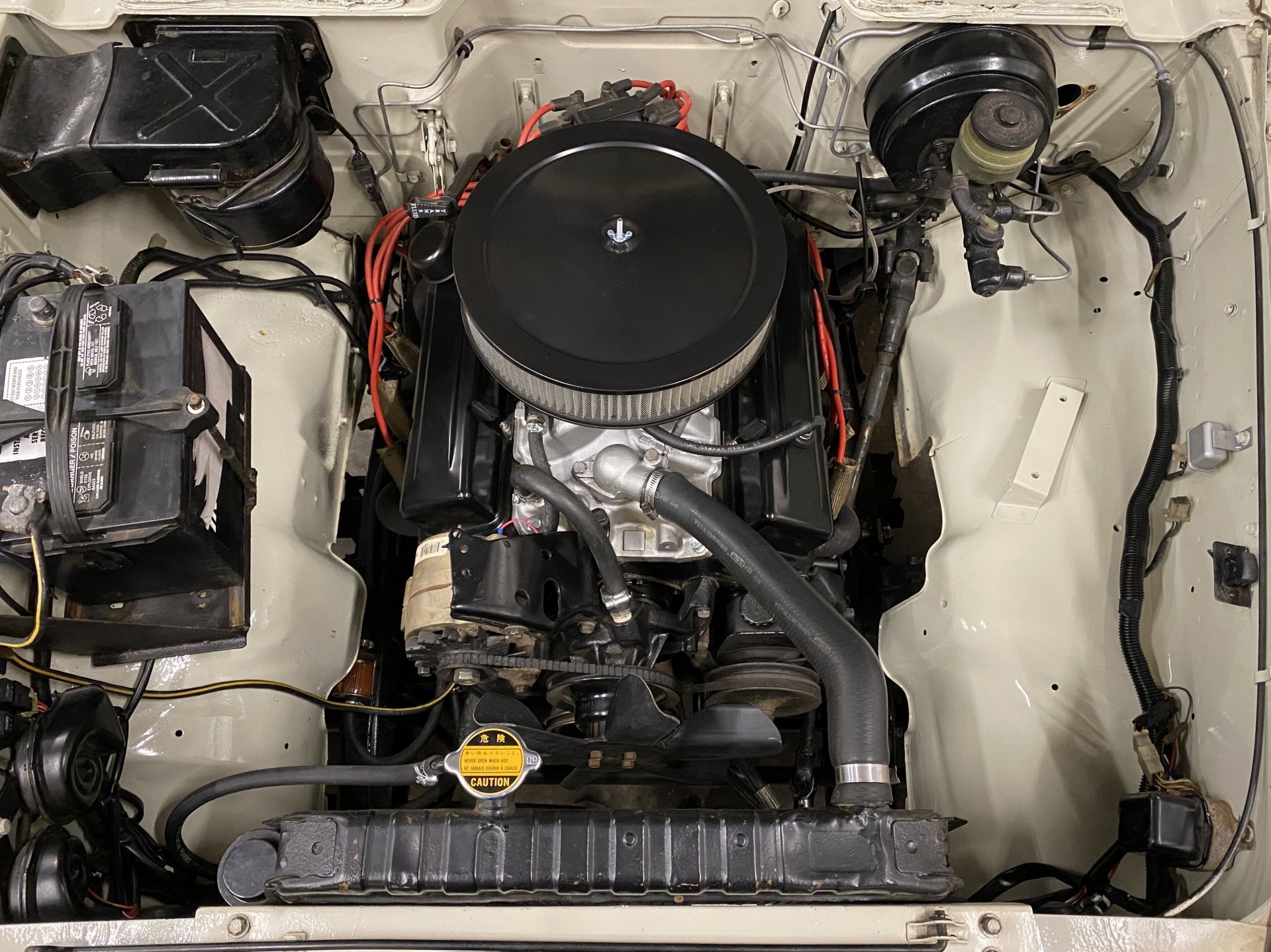

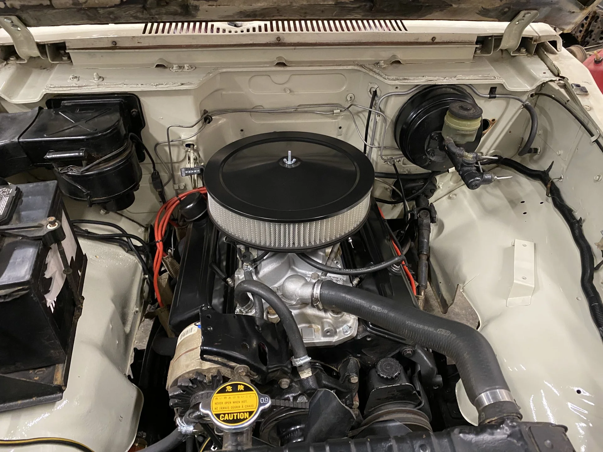

I found some pics. I know nothing about it. I used the search in the fj55 iron pig society section. I used. Pig sbc The thread was titled something like . luck of the pig. I'm sure there's more threads out there.
Ideal location for any motor swap, regardless of vehicle or engine type, is dictated by getting as close to the center of the radiator with the fan as possible. Some lateral movement left or right is acceptable but you will always want the fan as close to the middle of the radiator on the vertical plain as possible. This will make fabricating a proper fan shroud much simpler.
The rest of the drive train can be placed in line with the front part of the motor. Keep in mind the location of the harmonic balancer above your front differential, especially on a non to mildly lifted vehicle.
I always factor in the cooling effects of engine placement when doing a swap of any kind. All the mechanical things can be manipulated to work properly but cooling is either correct or not correct.
