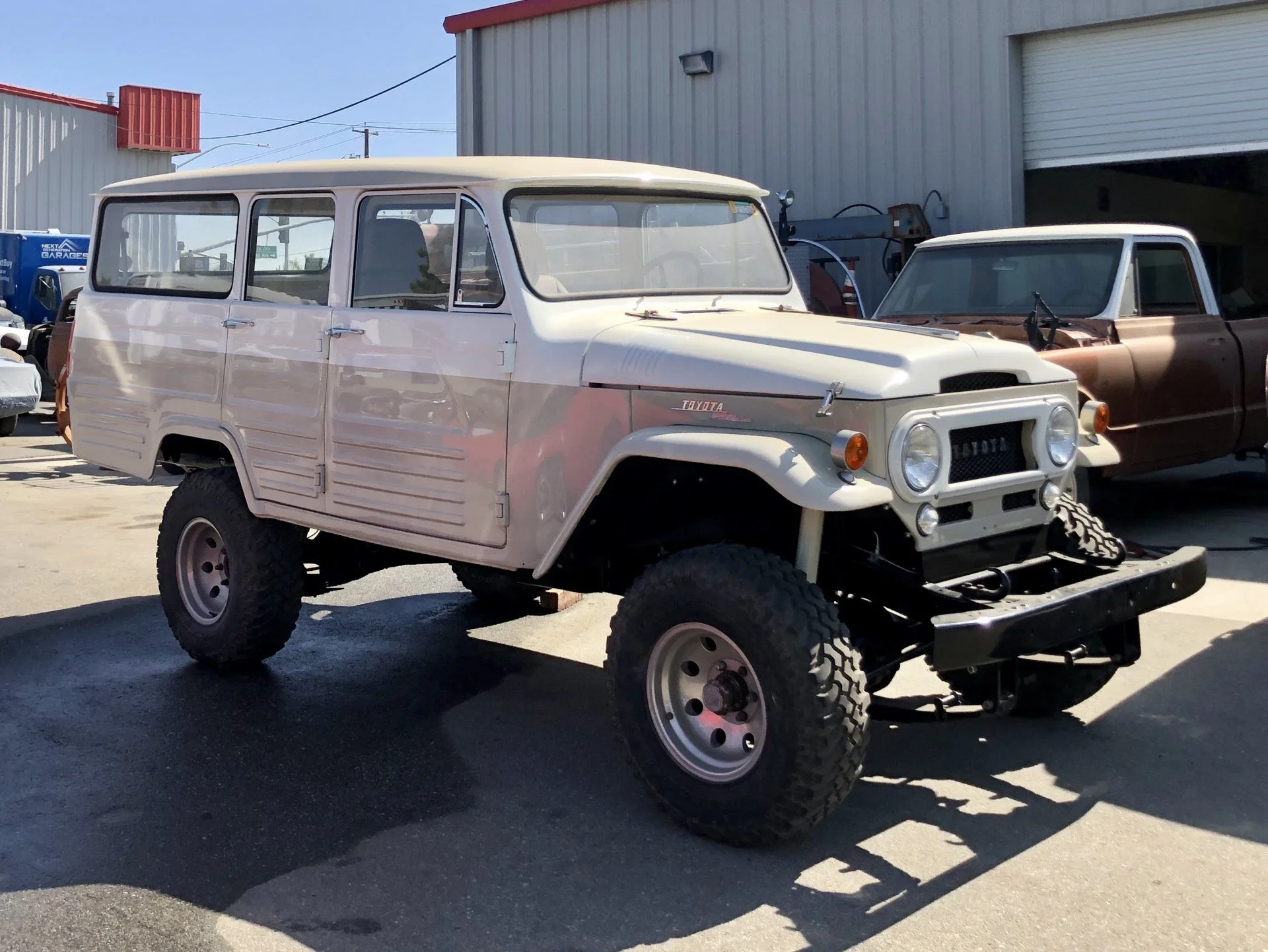

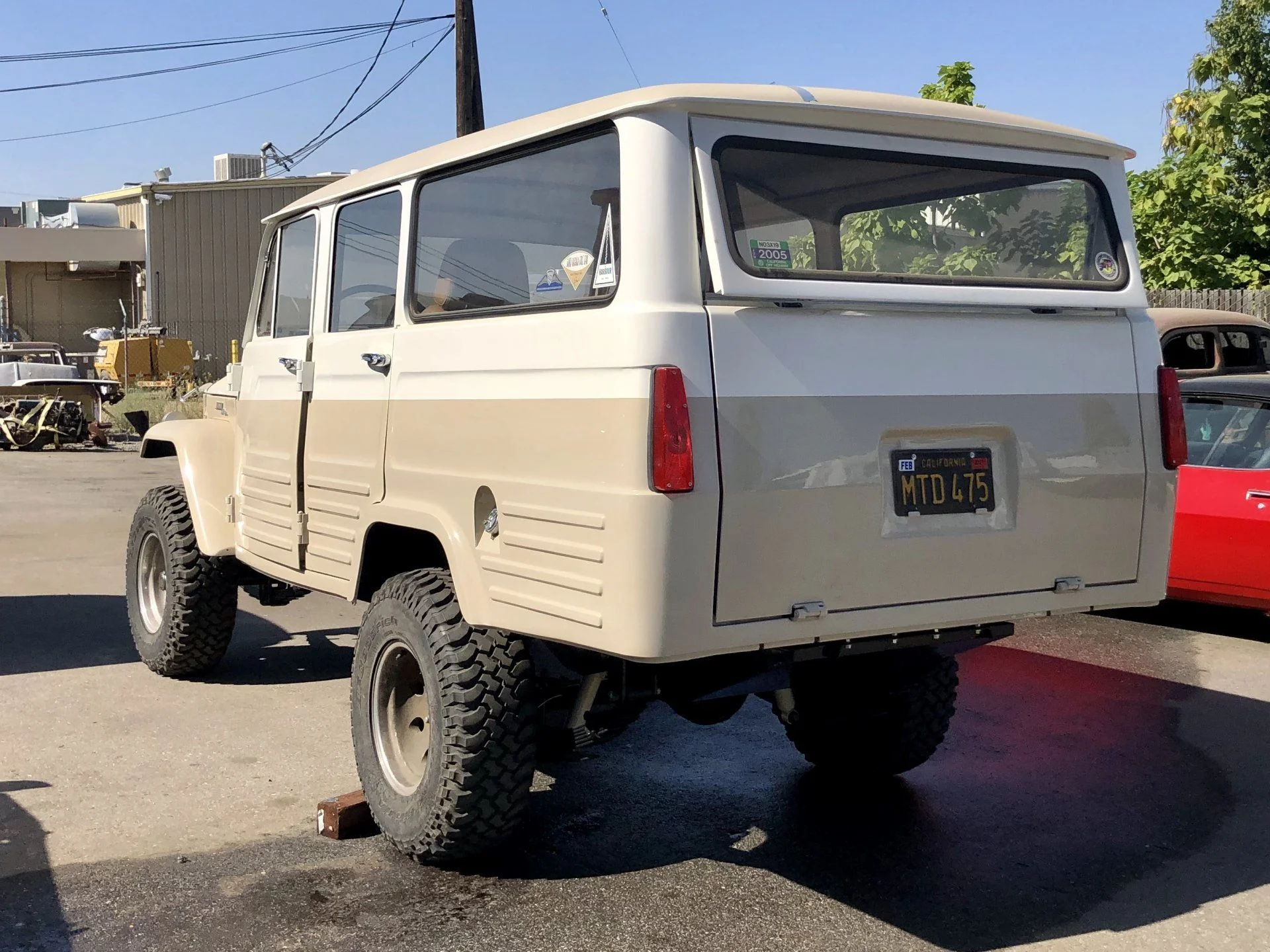

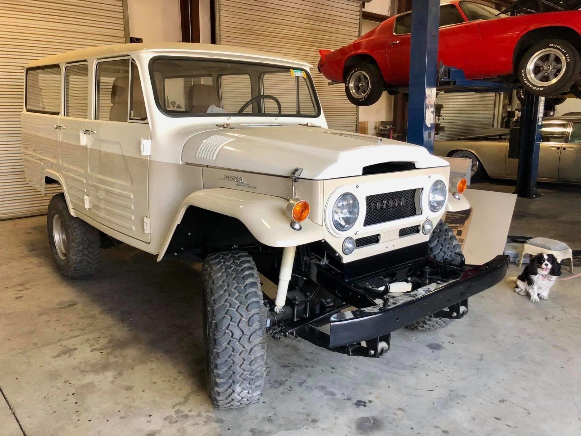

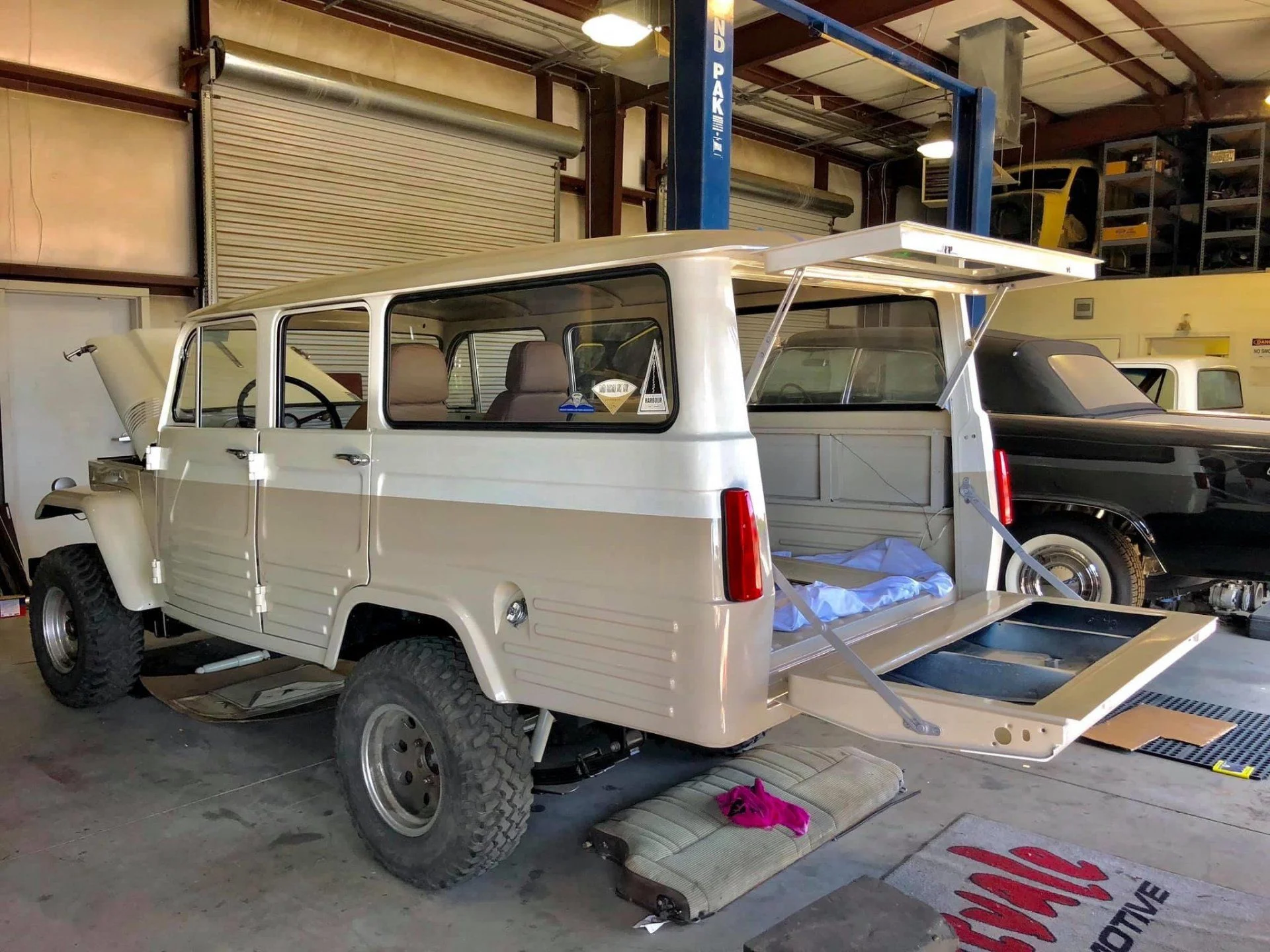

Hey all,
My 1965 Toyota Land Cruiser FJ45LV grande dame that I’ve had since ‘98 is almost ready to go back on the road after a frame-off restoration, but instead of selling her off I am going to bring her back to the stage as an overland ambassador. She deserves to be seen and heard singing along the trails again. I could use your suggestions to make her ready...
In your opinion, what are your top three things that you would recommend that I do first to have a good solid foundation for overlanding? Contrary to this post’s title, I shall not be dissuaded...

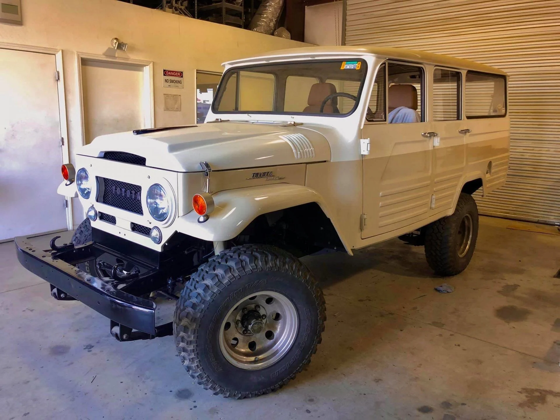

The rig is going to be used not just for daily driving around my local area, but also for overland travel. I have a 2F with an original rebuilt column 3-speed, a few mods including a Vintage Air air conditioning and heating system, front disk brake conversion, a 2-1/2 inch OME suspension lift, and a 2 inch body lift to allow tires and a better departure angle. The tires you see on it are old roller-only 31x10.5r15s, I am likely going to 33x10.5r15s so I can use my stock rims and original rechecked hubcaps. She is otherwise stock to keep a vintage look.
Looking forward to seeing you all soon out on the trails!
I think she is ready and already a beautiful ambassador, just wheel her.

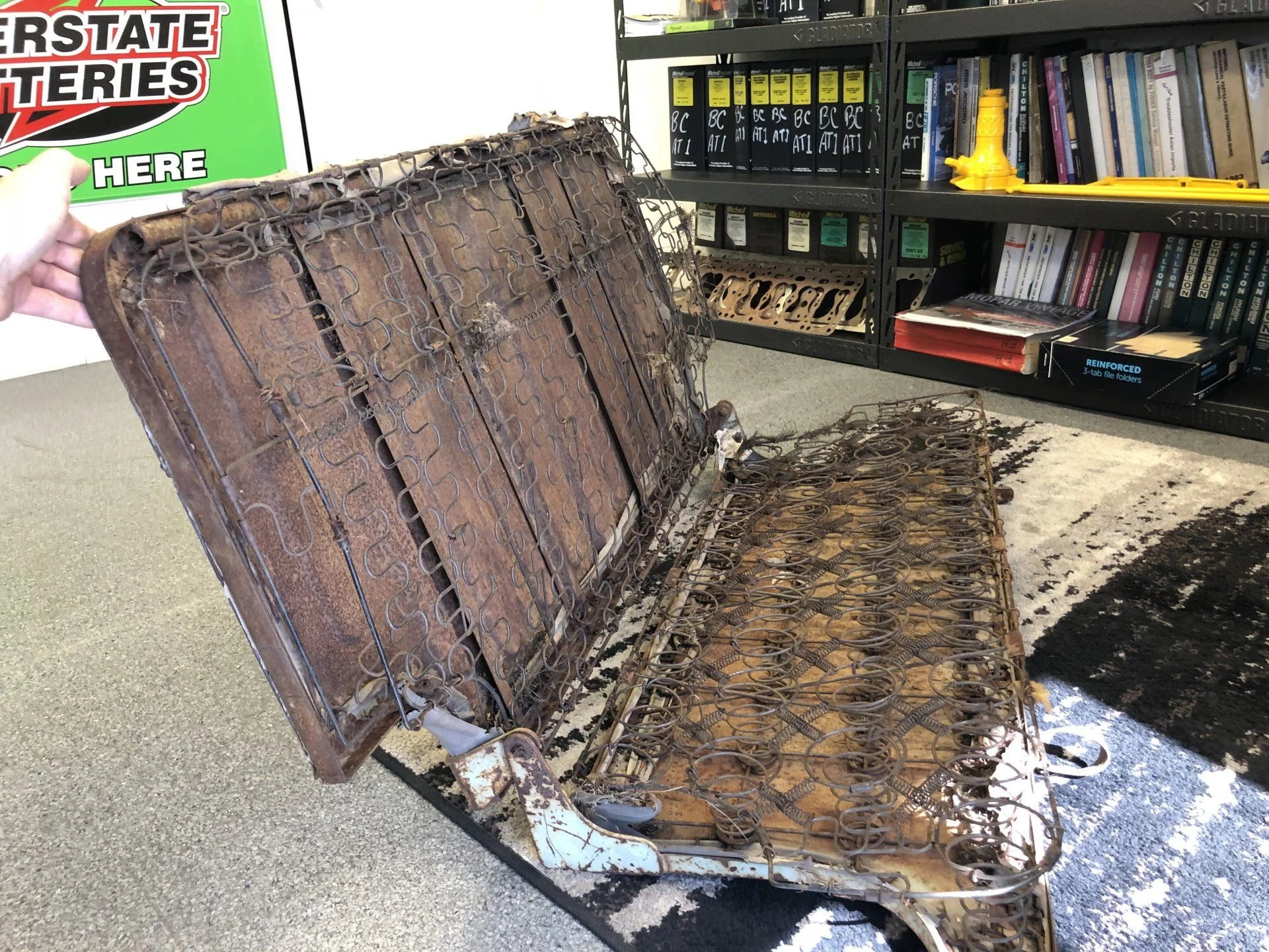

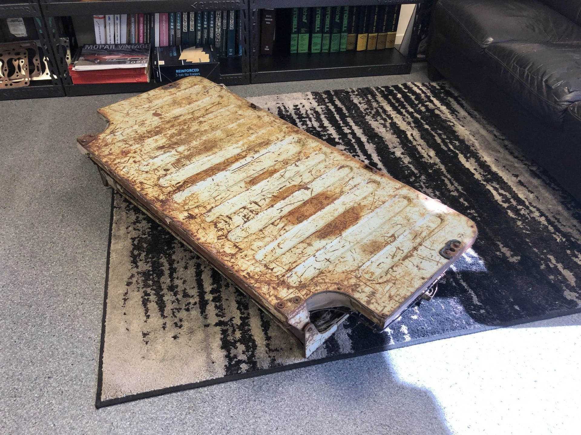

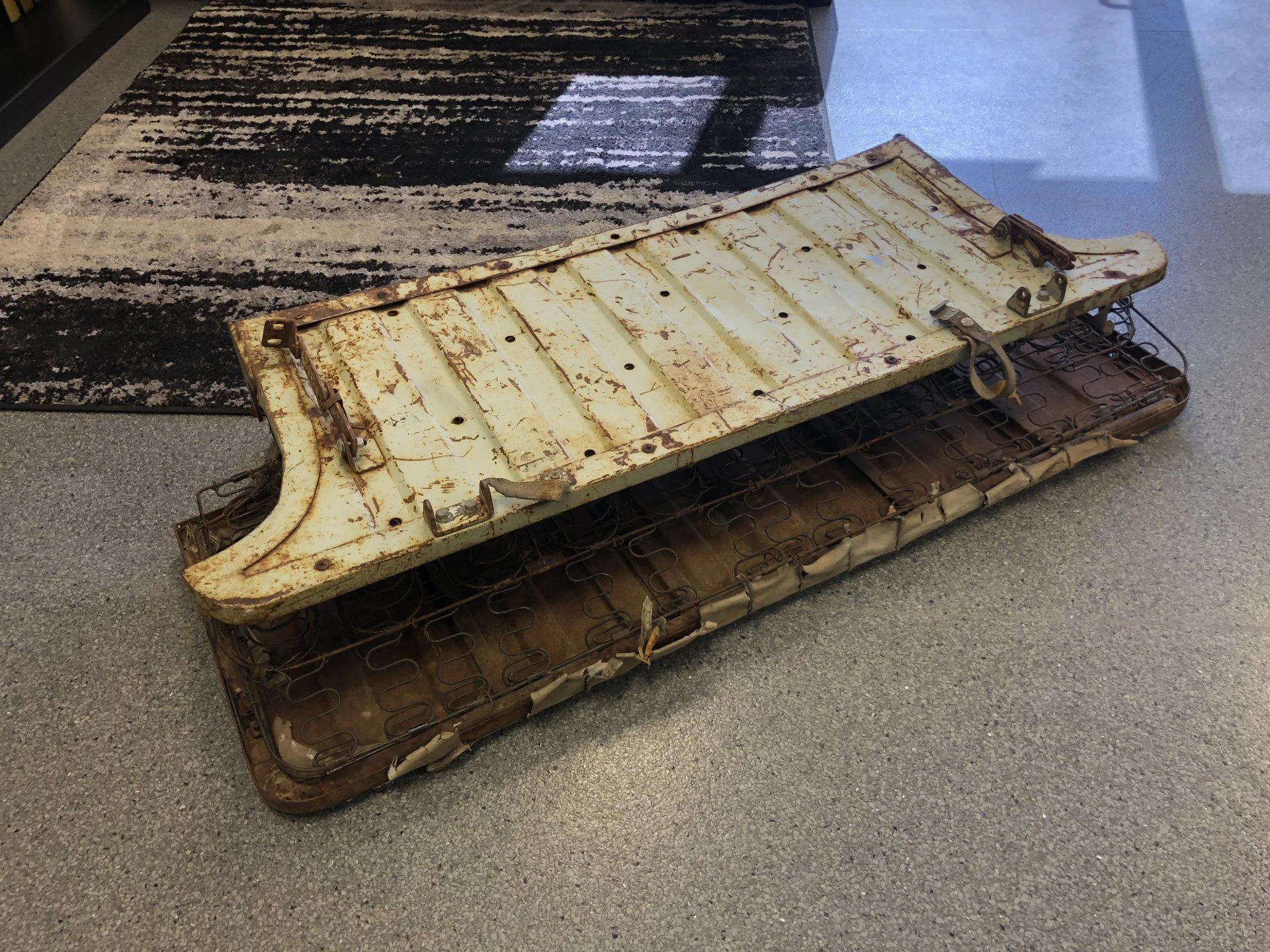

I stopped by my shop today and dropped off the rear LV seat that I picked up from jc71fj40. Naturally, it’s going to be blasted and painted, followed by new seat foam, seat heaters, and leather to match the front buckets that are going to be recovered to match.
