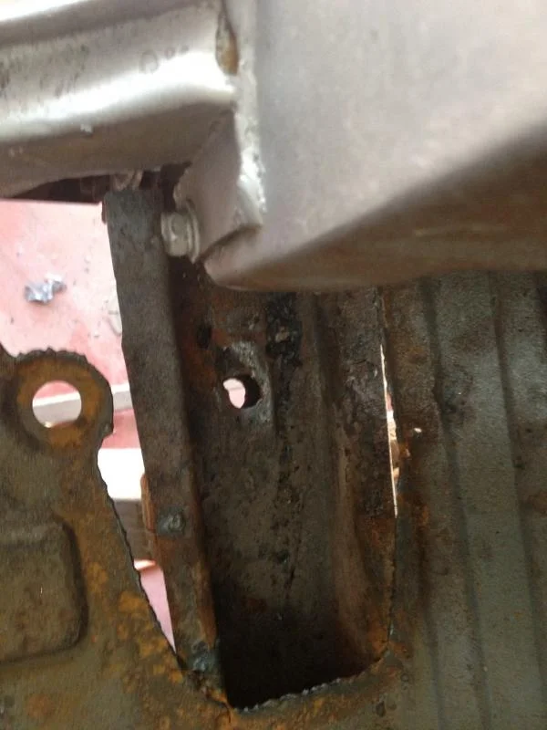

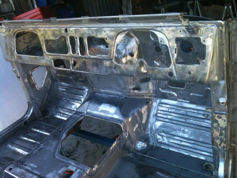

thx guys.
Alberta mac you mention that bolts drop into place from cab (i assume you mean front of cab)
On mine its a sealed body and no holes to drop bolts through!! it would appear that the front bolts come up from underneath and screw into a washer type nut that sits in the body mount on the body.
What i have had to do is cut a hole through the floor well and weld a nut in place and then replate.
ggggrrrrr most of issues im having is not having the right access to tools etc and equipment.

Yes front of cab, just below dash near door sil. usually a plastic plug covers it for purposes of the use of a garden hose to clean the inside floor.
It may be possible that the PO welded a nut in a channel and screwed a bolt into the body, the channel being welded to the underside of floor.

Hey. I know the hole you are talking , but it its not in line with body mount hole!! I have an fj40 and its exactly the same at the front cab.
https://forum.ih8mud.com/attachment.php?attachmentid=750063&stc=1&d=1366490473
I think your looking at the wrong hole. The hole you are looking for is right were the floor pan has the sharp 45 degree bend to join the firewall. It is directly next to the door pillar. Yours might be gone or never had one. :meh: You can see two of them below.
