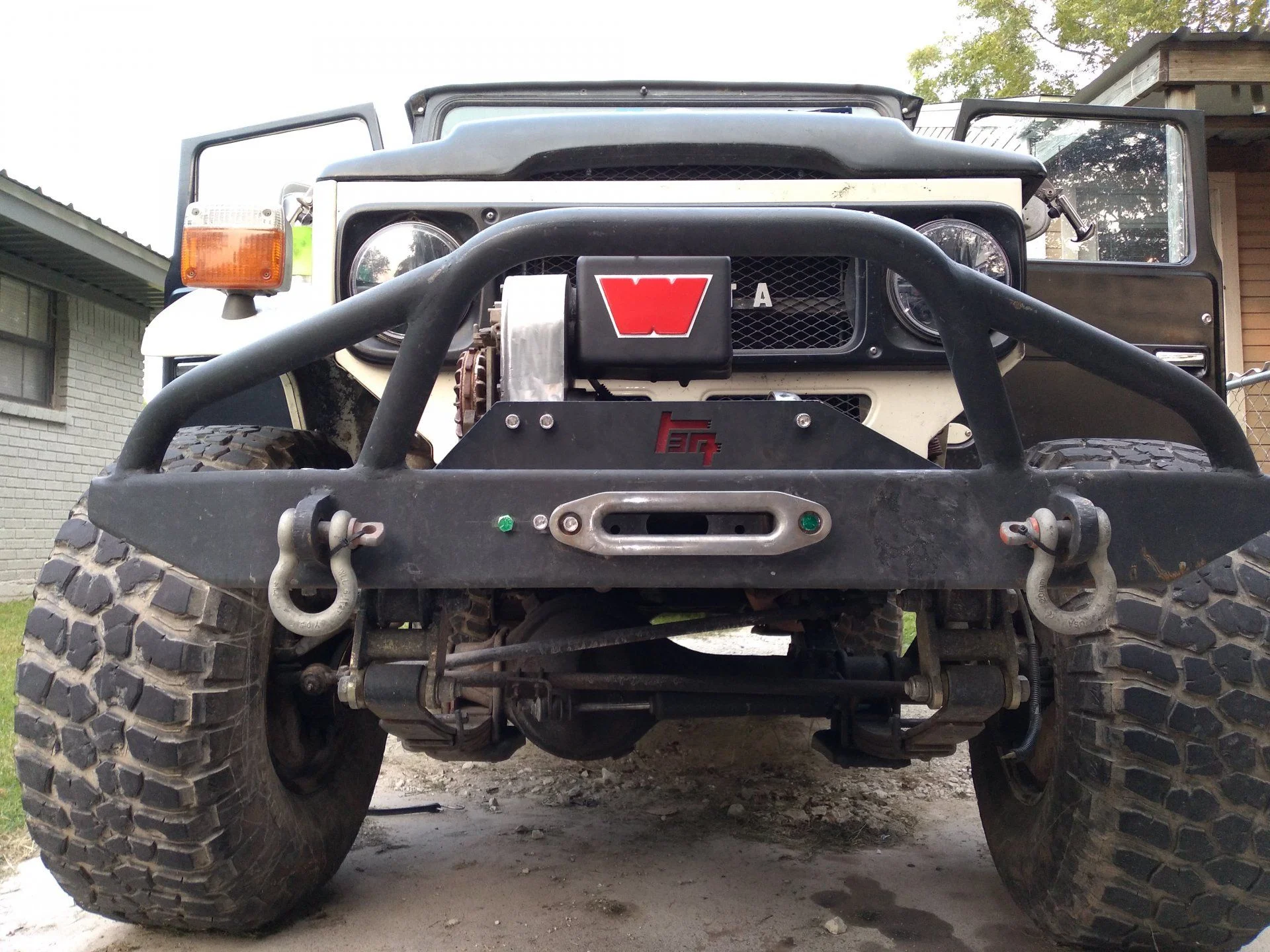

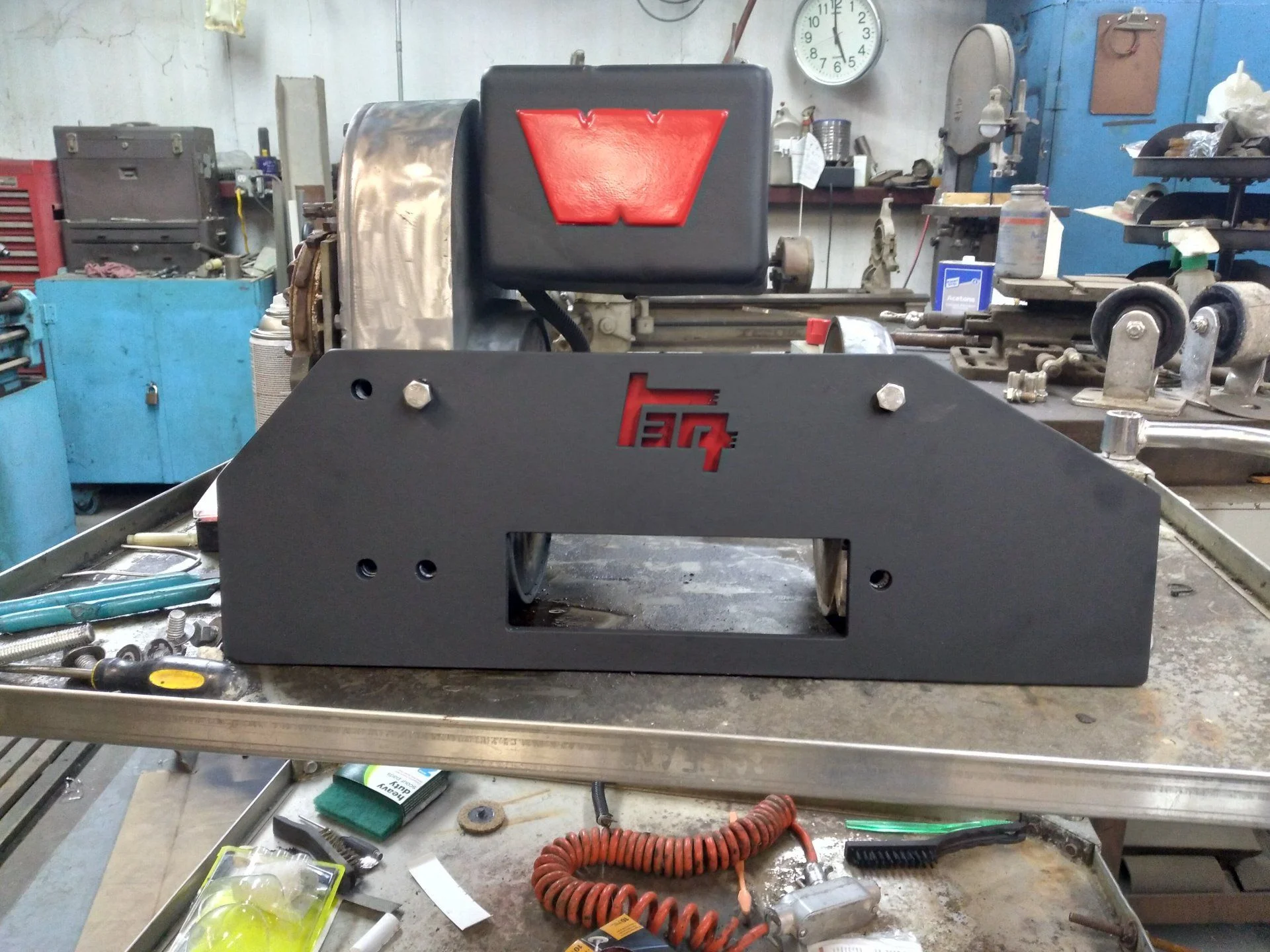

Hi Guys,
I had a fj40 bumper custom made for a warn 8274. Now I’m questioning the investment in the 8274. What winch alternatives are there for this style of front mount? Again, mounting direct to a reinforced bumper without baseplate.

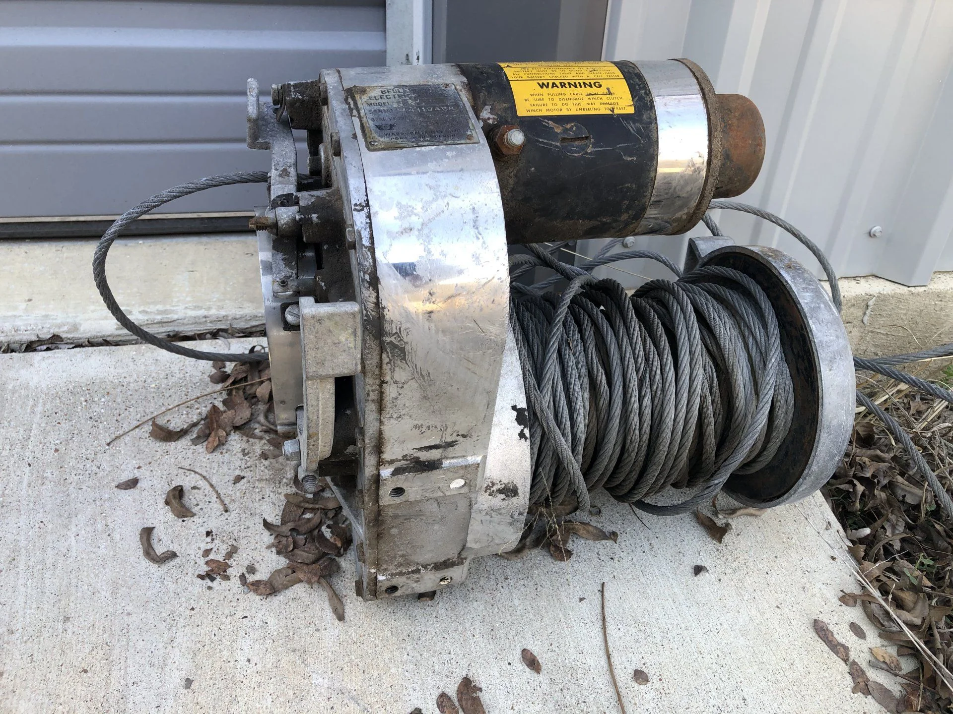

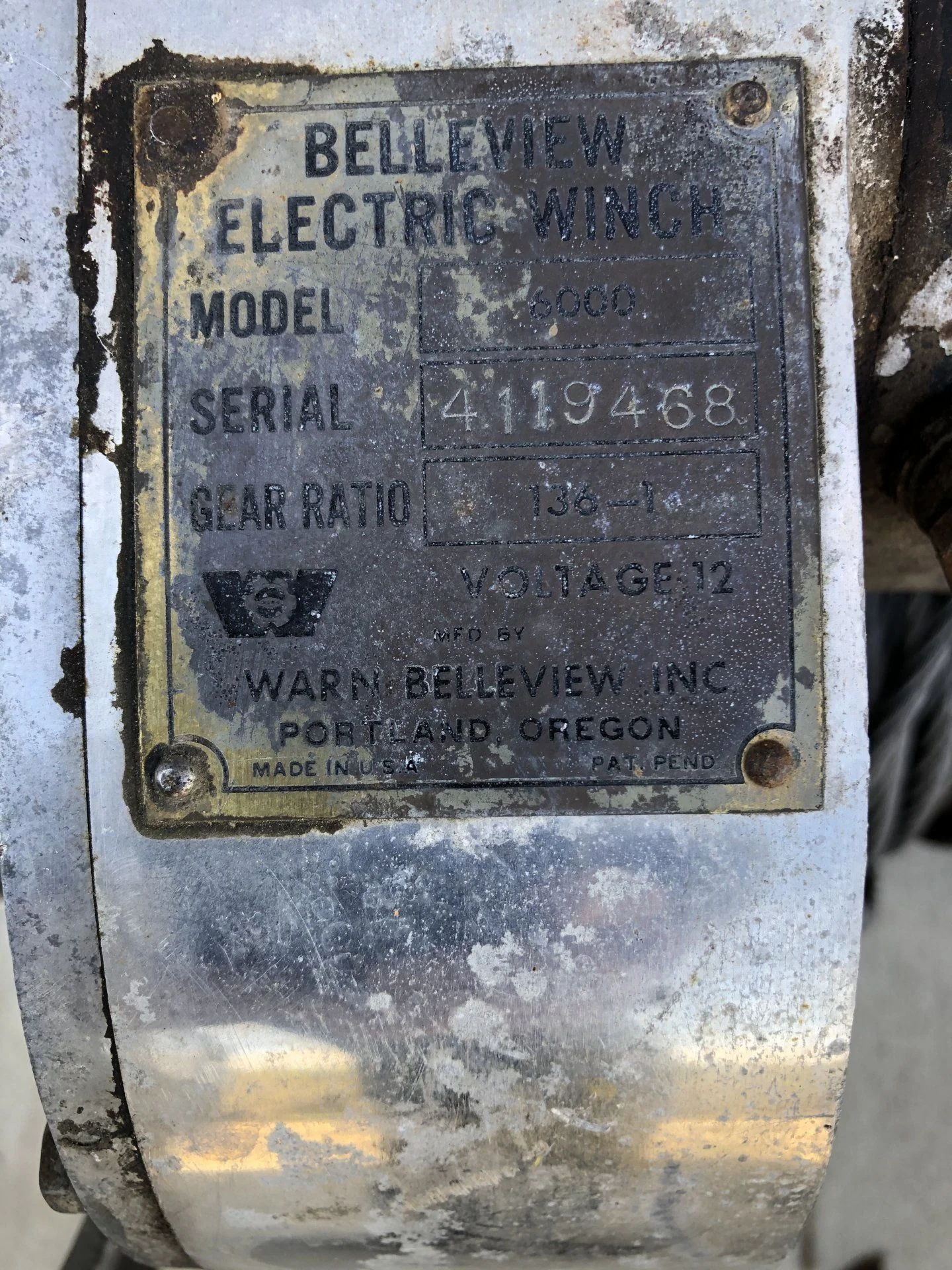

@OkieFJ40 , if you'd like something really cheap, I have a Belleview winch that I am selling for a friend that is currently out of the country. The Belleview is the original upright, spur-gear electric winch that Warn bought the whole company to get. Warn subsequently added an automatic brake, made it power out and in, and voila, the 8274 was born. The one I have was made after Warn bought Belleview, so it is labeled as "Warn Belleview Inc.". Like I said, the only difference is that it doesn't power out, and the brake is manually operated by a cable (this one doesn't have the cables that came with it). The only problem is, that it weighs a ton - it would probably have to be put on a pallet to ship and it will be expensive to ship. Do you ever make it down to north Texas? I live one county west of Fort Worth.
Photos of the winch:

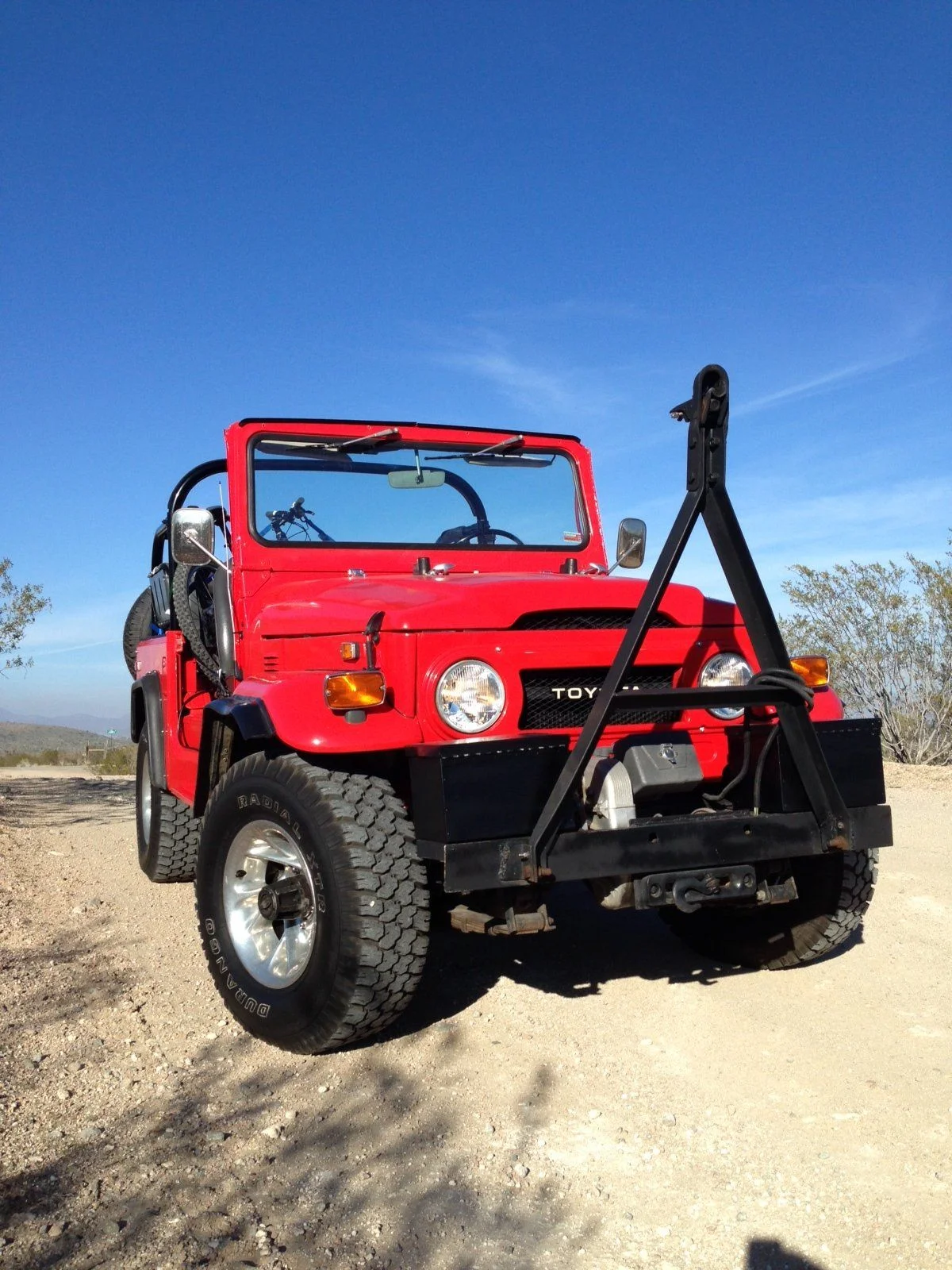

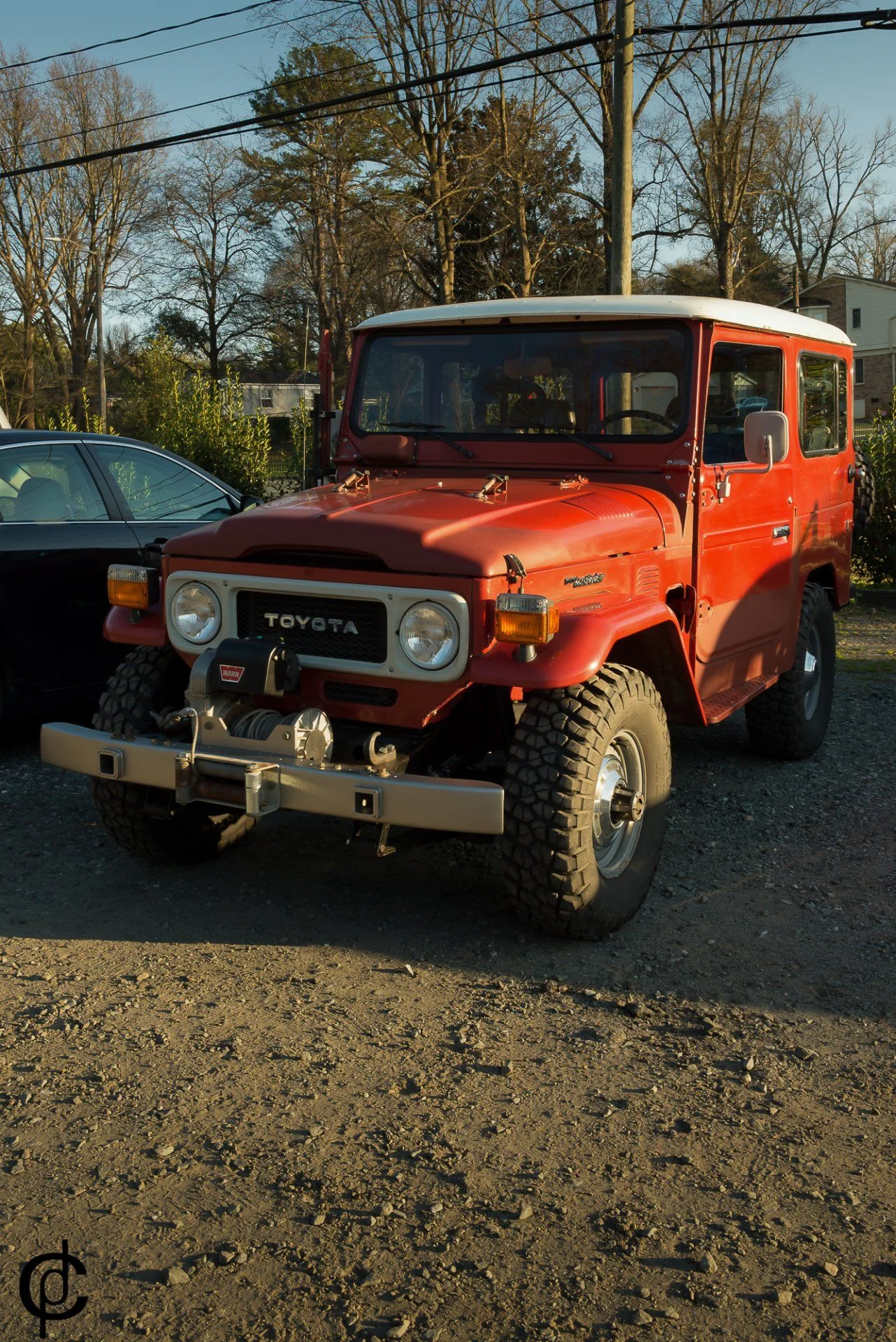

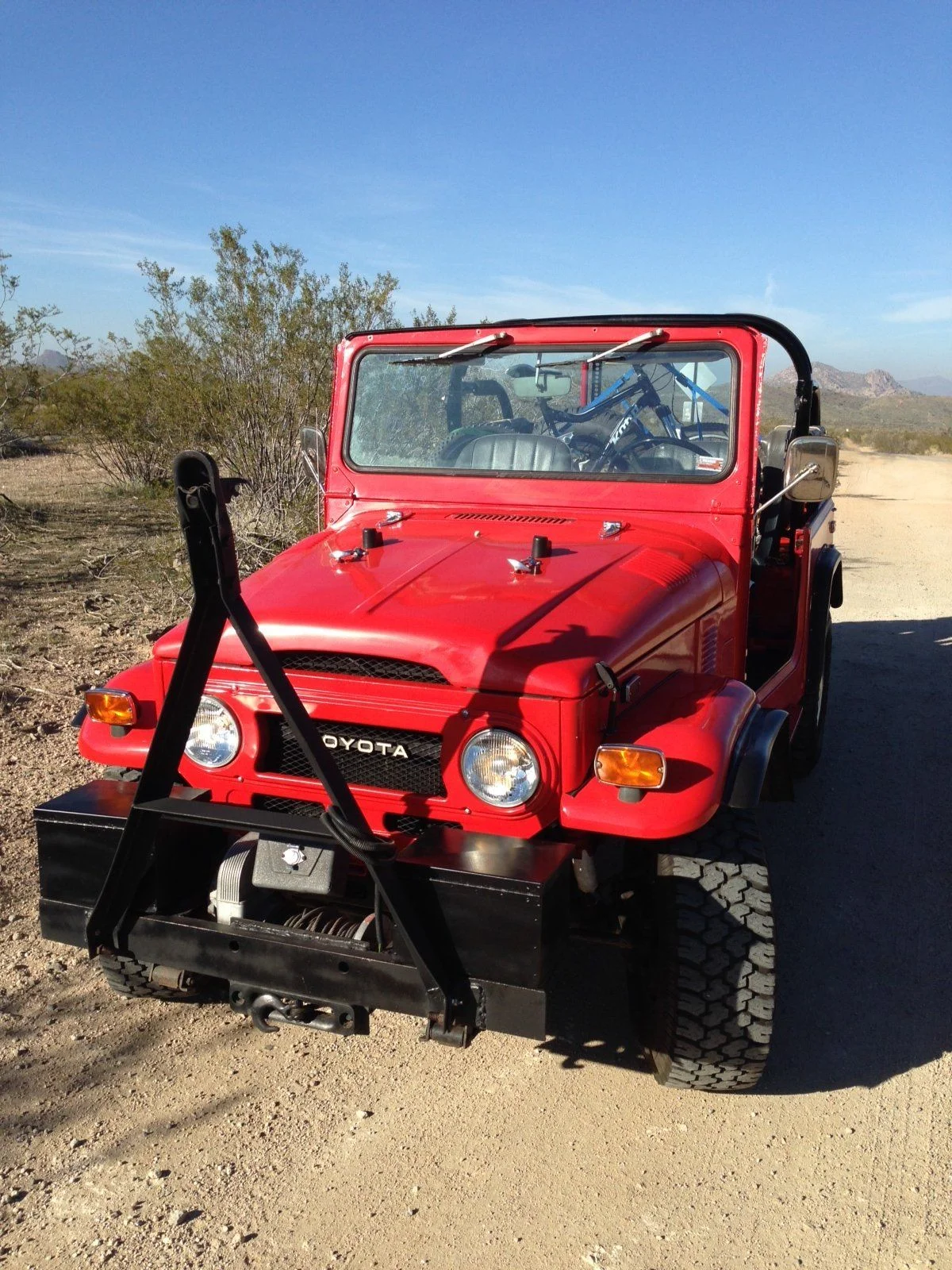

Take a 5 inch channel and weld it to the gussets of from the old bumbers or buy them on ebay. Then bolt to the frame or just weld the 5” c channel to the frame i did that to my 74 FJ40 35 years ago. Then take a 1/4 plate with a slot for the cable. Install a roller fairlead ebay used and rebuild. Then weld the 1/4” plate to the bumper and the fairlead mounted just under the bumper. Those are pics of my 74 setup. On my 76 i used a roller fairlead instead. And bought a used winch on ebay and rebuilt it with new relays per the thread on here for rebuilding a winch. A lot cheaper doing like the 74 or my 76 and then you have money for other treats. Also on the 76 winch rebuild i upgraded the motor besides the relays. I do recommend a second battery setup. Not fun to winch kill the battery and then your stuck if the engine dies unless you have the crank for the engine and good wrists.
