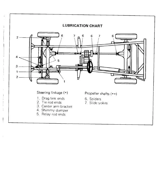

Molybdenum disulphide = birfs and balljoints/rod-ends.
Everything else = standard grease

U-joints (or "spiders" as Toyota calls them) just need standard grease.
And for standard grease, I mean any "lithium-base extreme pressure type".
(I currently use Valvoline ValPlexEP grease as my "standard grease" and Valvoline ValPlexM (Moly fortified) grease as my "molybdenum disulphide grease" - but I'm not really fussy about brands.)

PS. Steering ball-joints (on the ends of your tie rods, drag link, steering damper etc) also need a grease that still lubricates when it has "dried out to some extent" IMO. And moly grease is thus better than standard for this application too.
But moly is no better than standard grease in splines, spiders, shift linkages etc. In fact, I think the standard grease has the advantage there because it tends to remain more "fluid" and makes less mess when it escapes.

Or just go with the literal standard in the manual. Anything NLGI-2 rated is sufficient. That's it.
