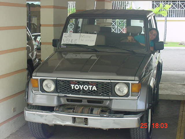

Does it look like this?
well thanks for move the topic to 70 series... the model is the same as in the photo and same color to ....
