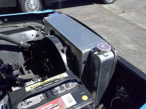

Just installed a 19"x22" crossflow rad I got at the Portland, Or swap meet. 2 one inch cores, and it cools my mild/mid built 305 without problem even though I'm sure it's an "import". Built a custom support that mimics the stocker, and bent up an aluminum shroud for the 16" electric fan. It will run right on the thermostat (180) most of the time, even on 90 degree days. When in traffic, or sitting at a light, it will slowly climb to about 200 when the fan kicks on and brings it right down. You can go bigger, but the opening in the bib is only slightly larger, and you get into the headlights pretty quick.
