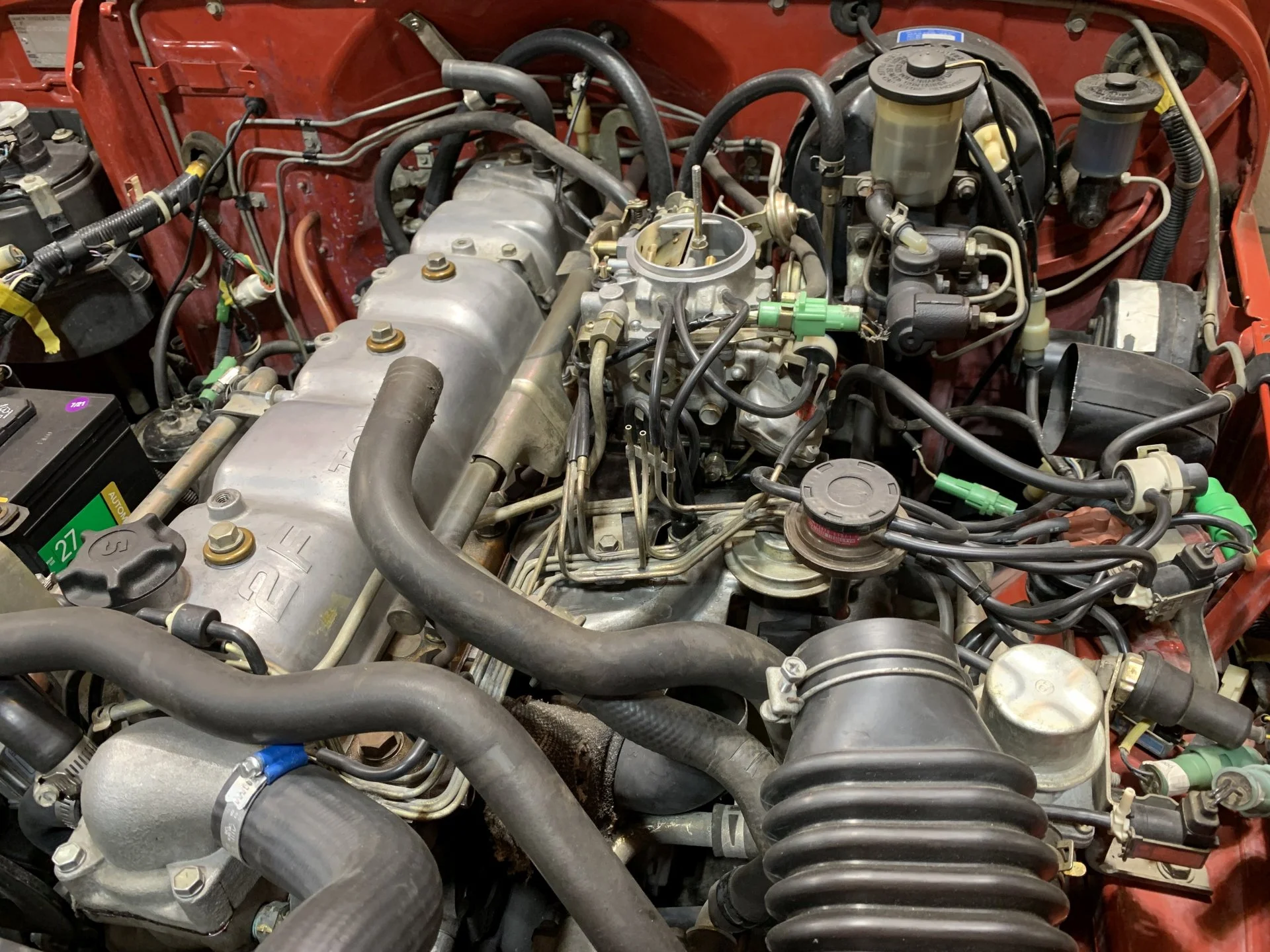

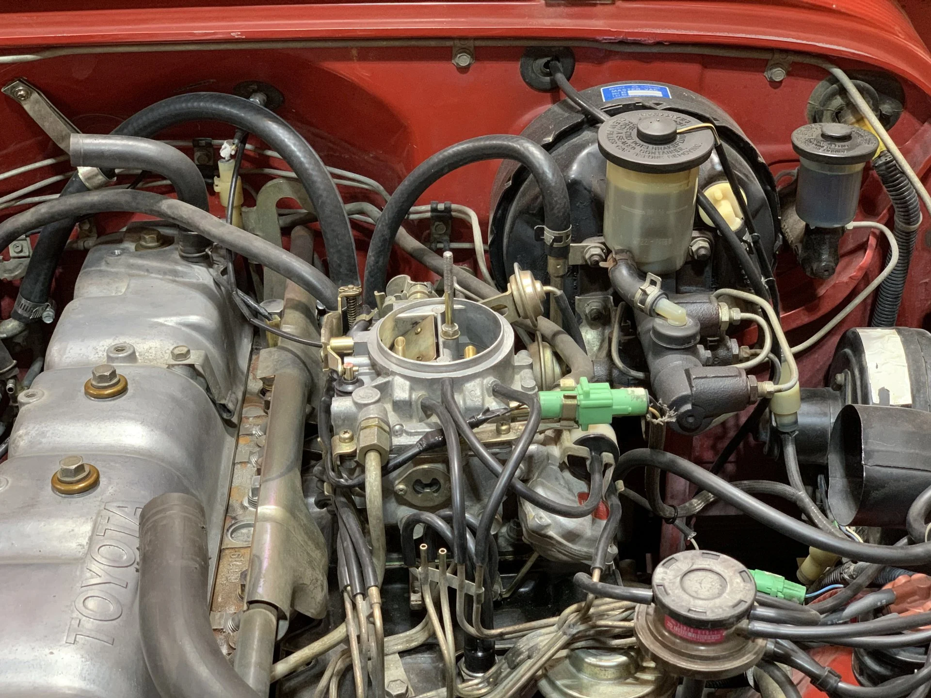

In addition to blocked idle passages, it could be an air leak as well if you're able to keep it running with extra choke. Can you post a pic or two of the carb as it sits so we can if there's anything obvious?

Here are the photos, obviously some open vacuum tubes that are connected when the air cleaner is on.

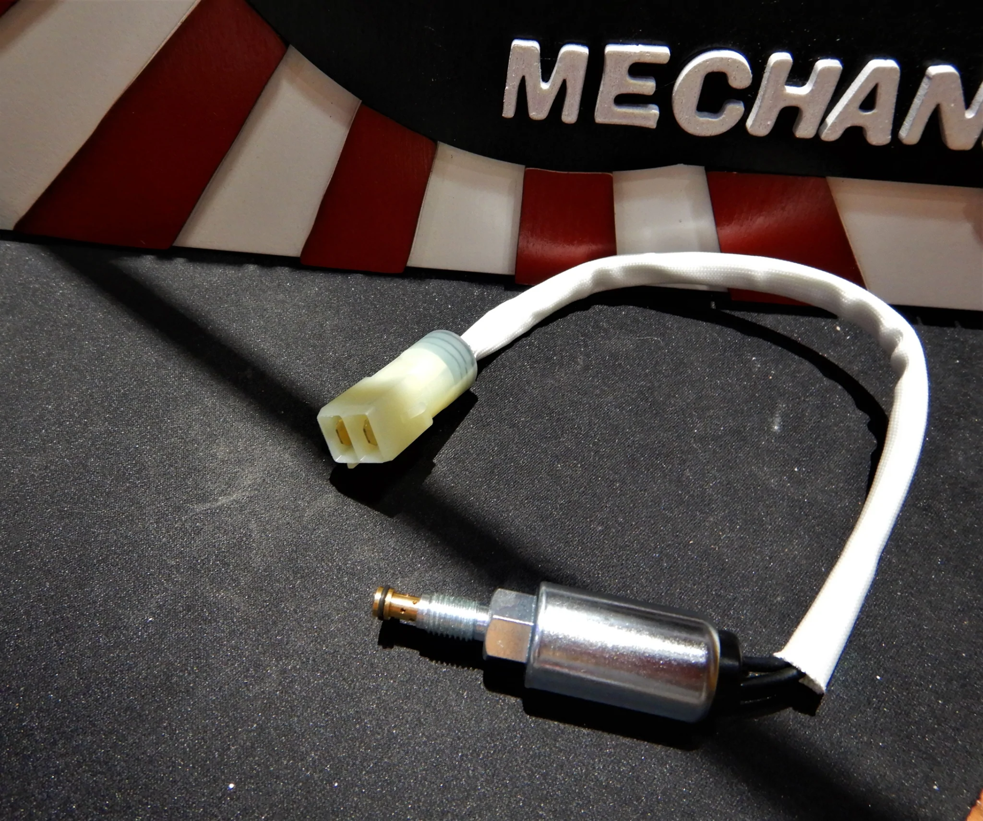

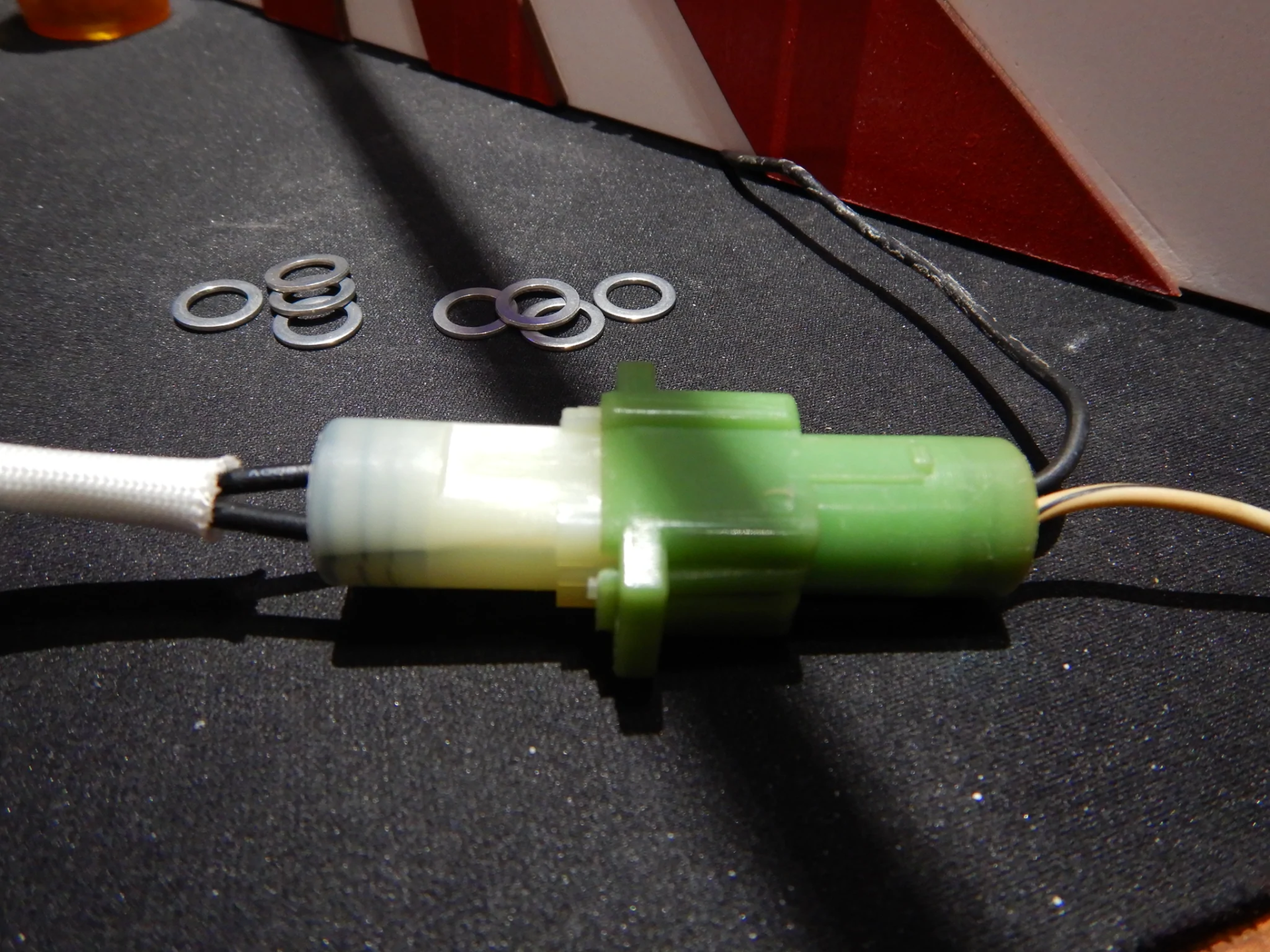

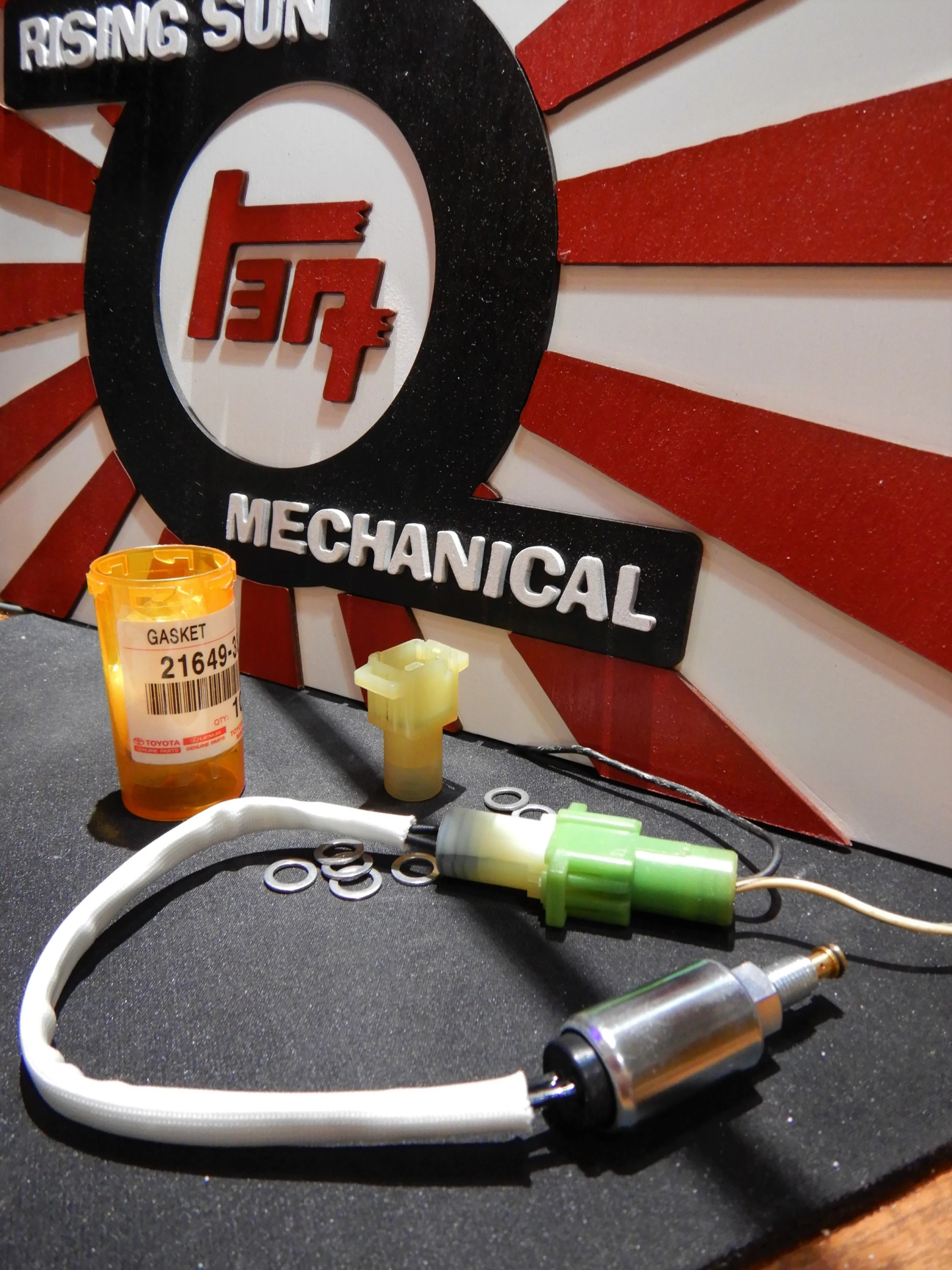

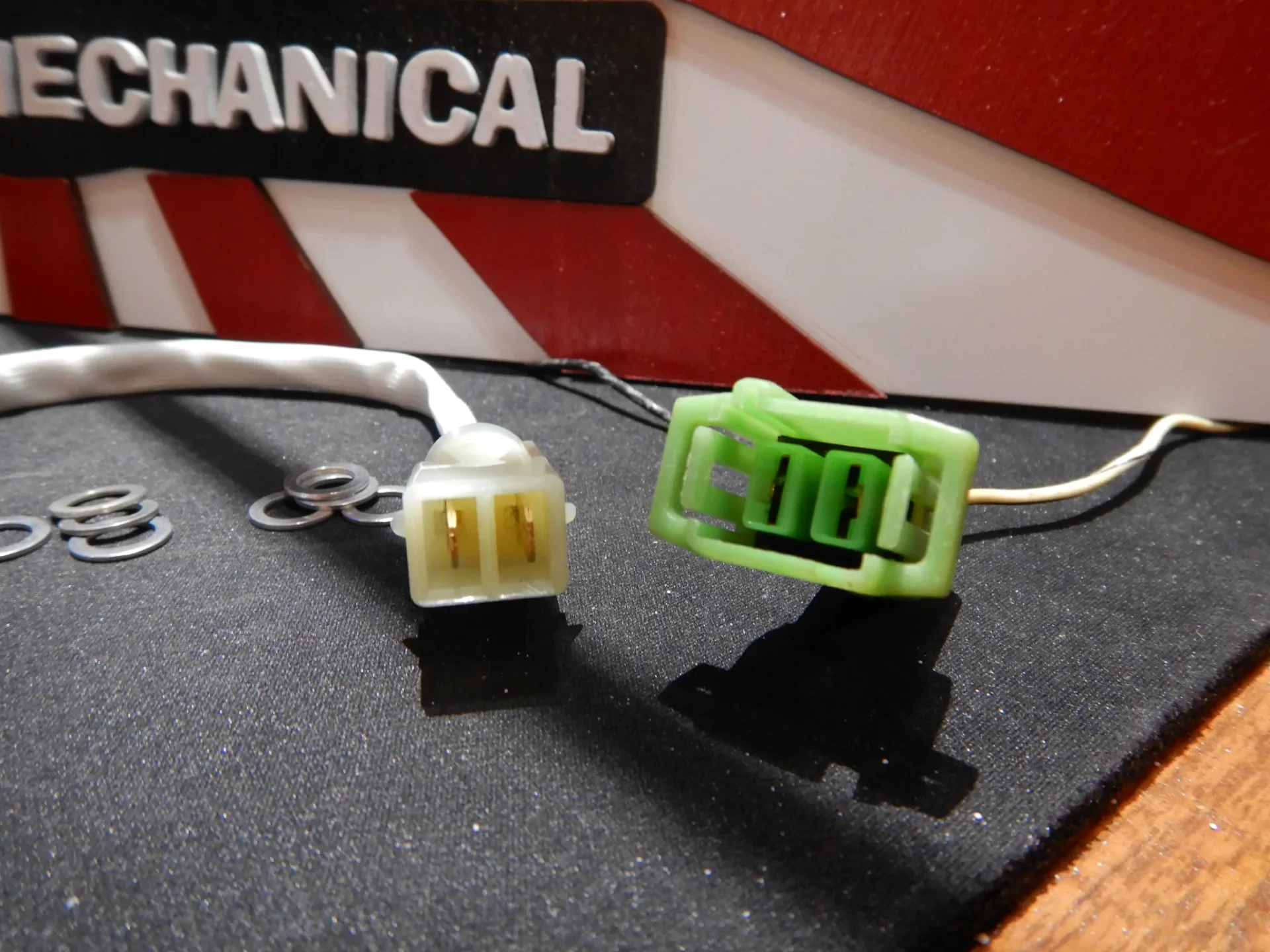

part # 21062-61060
you need to check this hard and confirm and verify the FCS fuel cut solenoid .......
this is the 2 wire update kit i offer will work on ANY 2F Carb 1/75-9/87 40 55 60
incudes the updated harness side water proof update connector and terminals too in UV rated OEM Green
let me know if i can further help
thanks
matt

i see ONLY 1 wire coming from your device side 21062-61060 fuel cut solenoid green connector ?
if you or a PO installed a single wire Varity or this wire has been severed ?
if im correct , this may be a smoking gun and eazy peezy to remedy with the correct replacement parts above i mention to confirm and verify first ?

That FCS wiring looks questionable as @ToyotaMatt points out.
Also what @1911 said is very true about the emissions computer, I've seen many with bad solder connections.
It is easy enough to run a hot wire from the battery to the FCS to check.
I can help with the emissions computer if needed, I have refurbished/bench tested (not just painted or cleaned up - really verified to work per the emissions manual) computers on the shelf.
part # 21062-61060
thanks
matt
Thank you Matt, the replacement unit looked nearly identical (but with a different connector so required splicing), but I'm not opposed to changing it again. The old one did 'click' when energized, as does the replacement. It continues to be energized when running, confirmed by a voltmeter at the leads.
