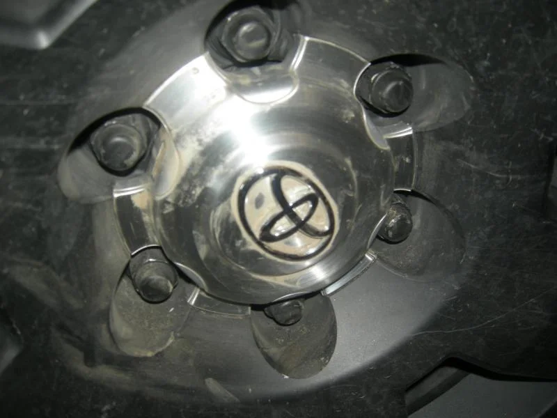

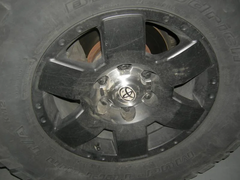

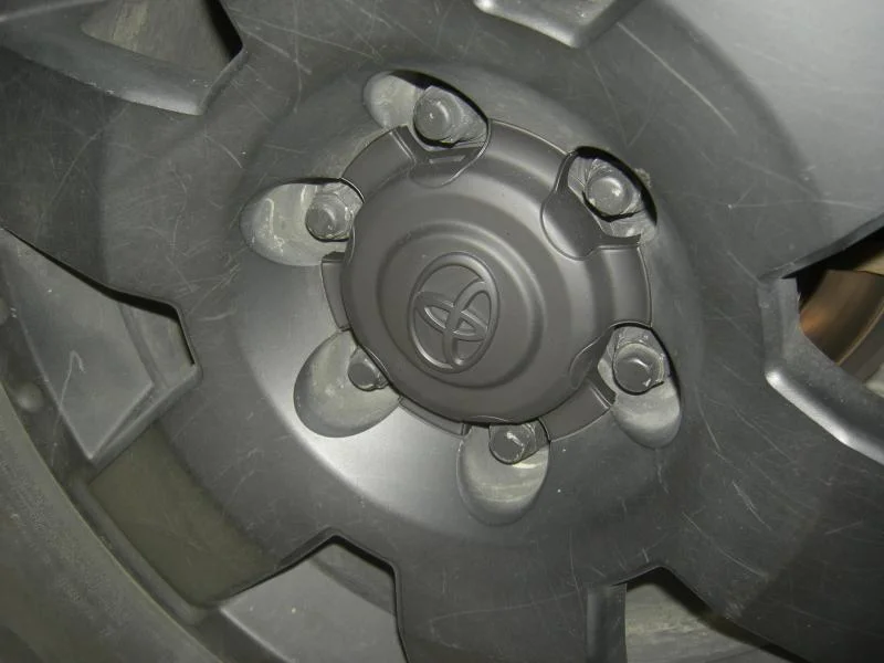

1-1/2". I just puchased a 5th rim as a spare and it came with the center cap so I checked. The center cap fully seated on the wheel and my spacers are 1-1/2". Below are pictures to confirm.
I will paint the cap black and post another picture later for a complete blacked out look with cap.

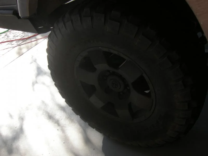

Figured this was best place to showcase new fj alum. 17's, and 315 mtr's as you can see they have already dominated a red bull can in the driveway:grinpimp:. I have no spacer, as I read the only way to get center caps to fit on front is a spacer. Has anyone modified the center cap to work or maybe the old centercaps from my 15's they seem deeper. I just got rims on tonight so I will maybe have time to check tommorow. I just used the lug nuts from the fj, they seem to be working fine As you can see from one pic not very good though cause im at angle but they are flush looking straight down the side. if I put spacer on I would be outside the flares as I dont want to do that for the simple fact of the police like to pick on us for that sort of stuff.

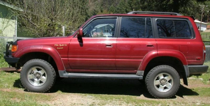

Here some pictures of the spacing.
FJ wheels on FZJ80
