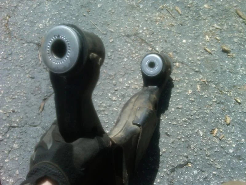

I'd also check the lower control arm bushings. The factory ones are slotted rubber units with a steel core and outer sleeve. If they are heavily worn, then the rubber starts to separate from the core. I have picture of the arm removed when I changed mine out...

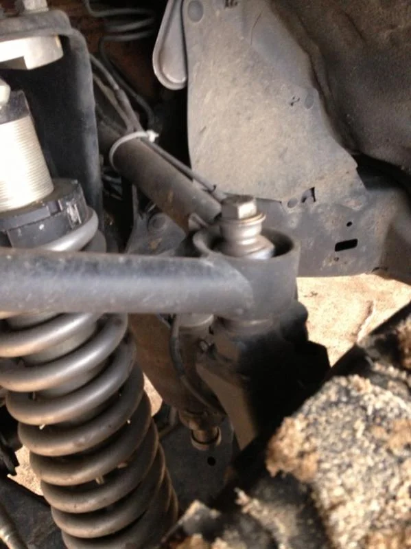

This weekend I got a chance to pull the truck into the garage and chip the ice and snow away.
This time, before jacking up either side, I grabbed a hold of the sway bar and..........was happy to find the bushings were very loose! I honestly can't remember if I've checked it in the past when tracking down this issue. Or if I did check it, I always had only one side jacked up so the bar was loaded up?:hhmm:
The local toyota dealer didn't have any bushings in stock, so I decided to simply remove the sway bar for now and take the truck for a spin to see if I could hear any other noises.
No more rattle/clunk.:clap:
The truck has a lot of mileage so I'm sure my fun isn't over, but I'm happy to have a bit of silence for now and get to the root of the issue.
Thanks to everyone (as always) for the quick posts and suggestions. This forum is a haven of great information and a great place to learn!
Since I said I'd post some pictures, here's a picture of the passenger side:
