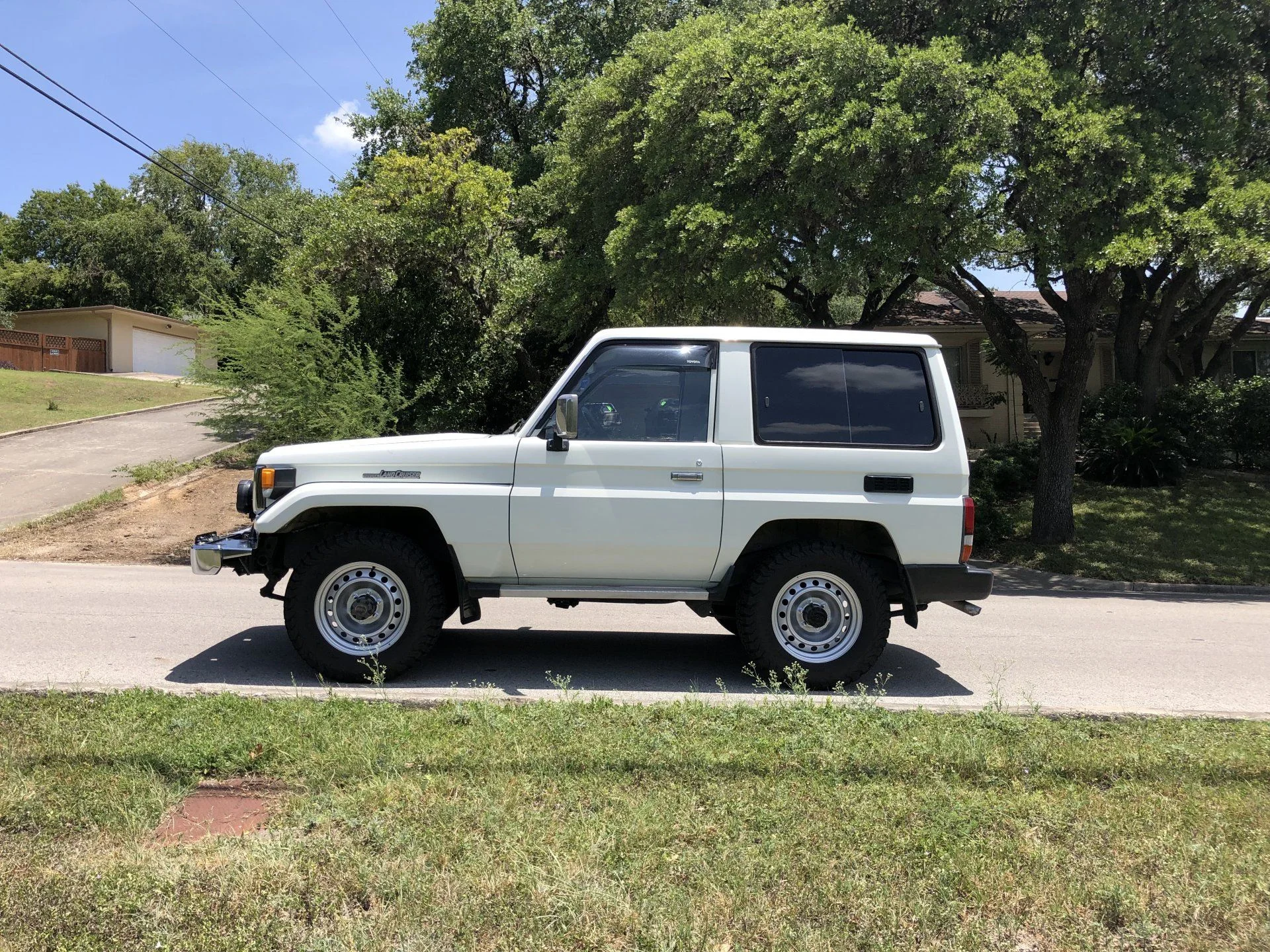

You will need spacers with FJ cruiser 17” steelies.
I did run 17” hilux steelies without spacers on the PZJ70 I had but those are hard to come by.
Those look great, that's exactly what I want.! Yeah I'm unsure about the fitment of the FJ Cruiser rims. Any idea of the backspacing on those Hilux rims? Hoping someone has run the FJ Cruiser rims on one of these so I can figure out if this is the way to go or if I should just grab up some 17x8 aftermarket steelies.
The hilux steelies are at 4" or perhaps slightly less as it seems when I physically measure them. I love those wheels but I am plagued with the flares so they don't look right. Looked really good on the flare-less PZJ70.

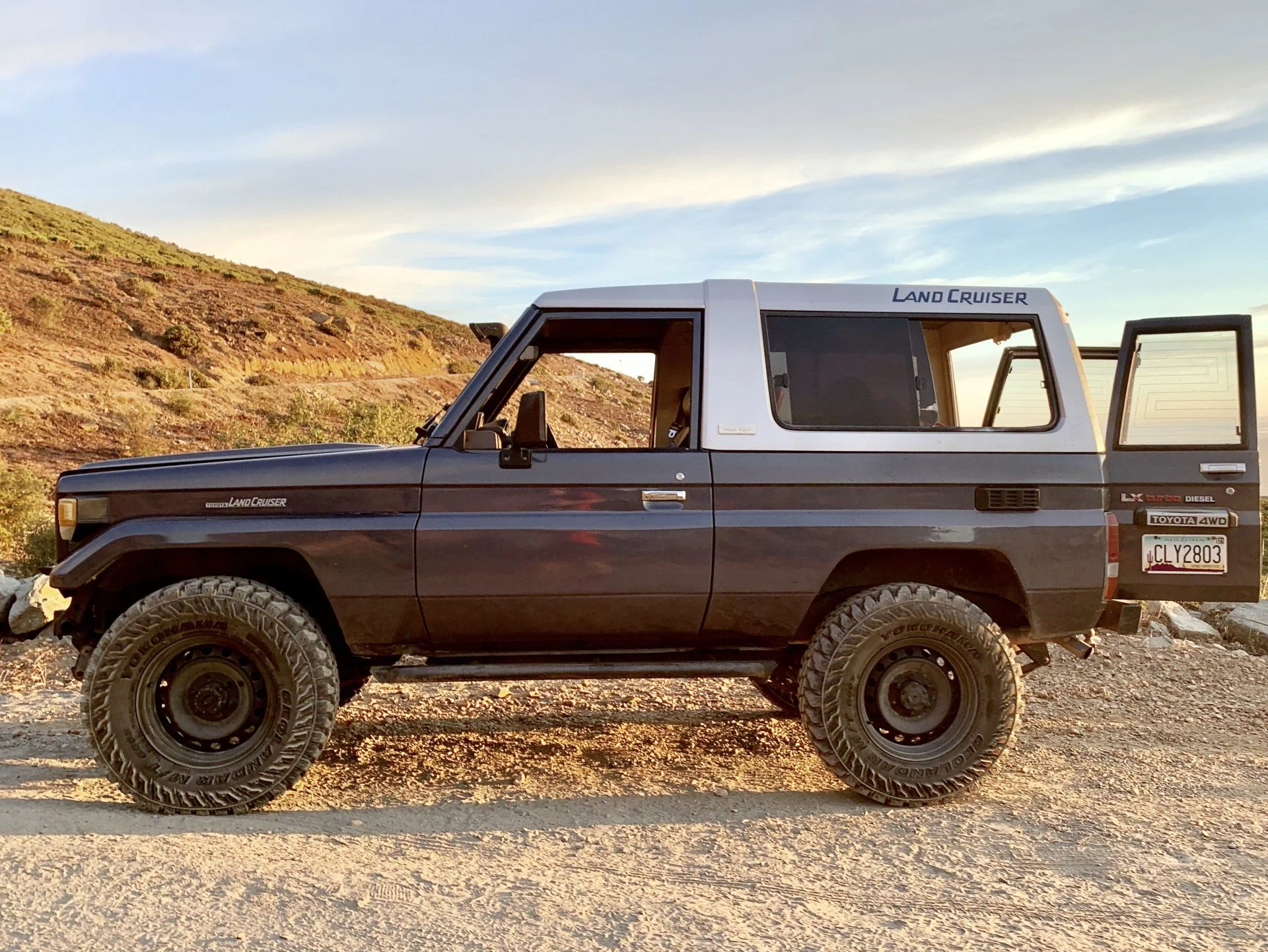

Here’s my 74 on FJ Steelies I’m actually gonna be changing my set up if you’re near San Diego. I’m going to probably change to a 35x12.5r15
Spacers are 100% required. I think mine are 1.25 or 1.5. I was debating sticking with these and going with Kenda RT’s in 35x10.5r17 or Cooper AT3xlt in a 315/70/17 but I’m not sure how I feel about Kenda tires and also the coopers on a 17x7.5. I know it’s not that big of a deal but I’d prefer to have something 8 inches wide. That’s kind of why I’m leaning towards getting a 15x8 and mounting 35’s on that. Just running into the dilemma of lack of 35x12.5r15 options.

what size tires are you rolling on? Looks pretty good :)

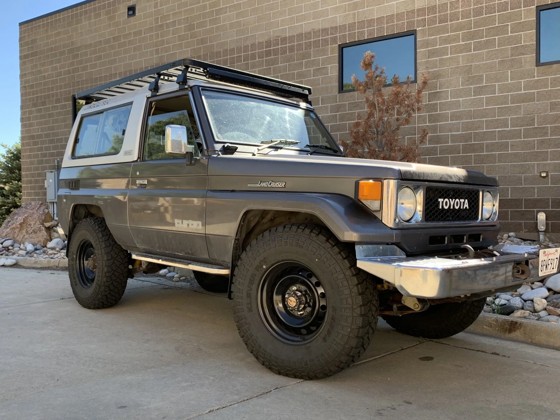

Well incase anyone wants to know what 35x10.50s look like on FJ Cruiser steelies, here it is! I initially installed it with some half wasted G2 1.25" wheel spacers (pictured here) in front while I waited for my new spacers, final installation uses Spidertrax 1.5"
No rubbing at 2.5" of lift! Steers and drives better than ever.

Nice we’re on the exact same setup! I’m painting my wheels grey atm. I also discovered that Mickey Thompson makes a 255/85/17 At.

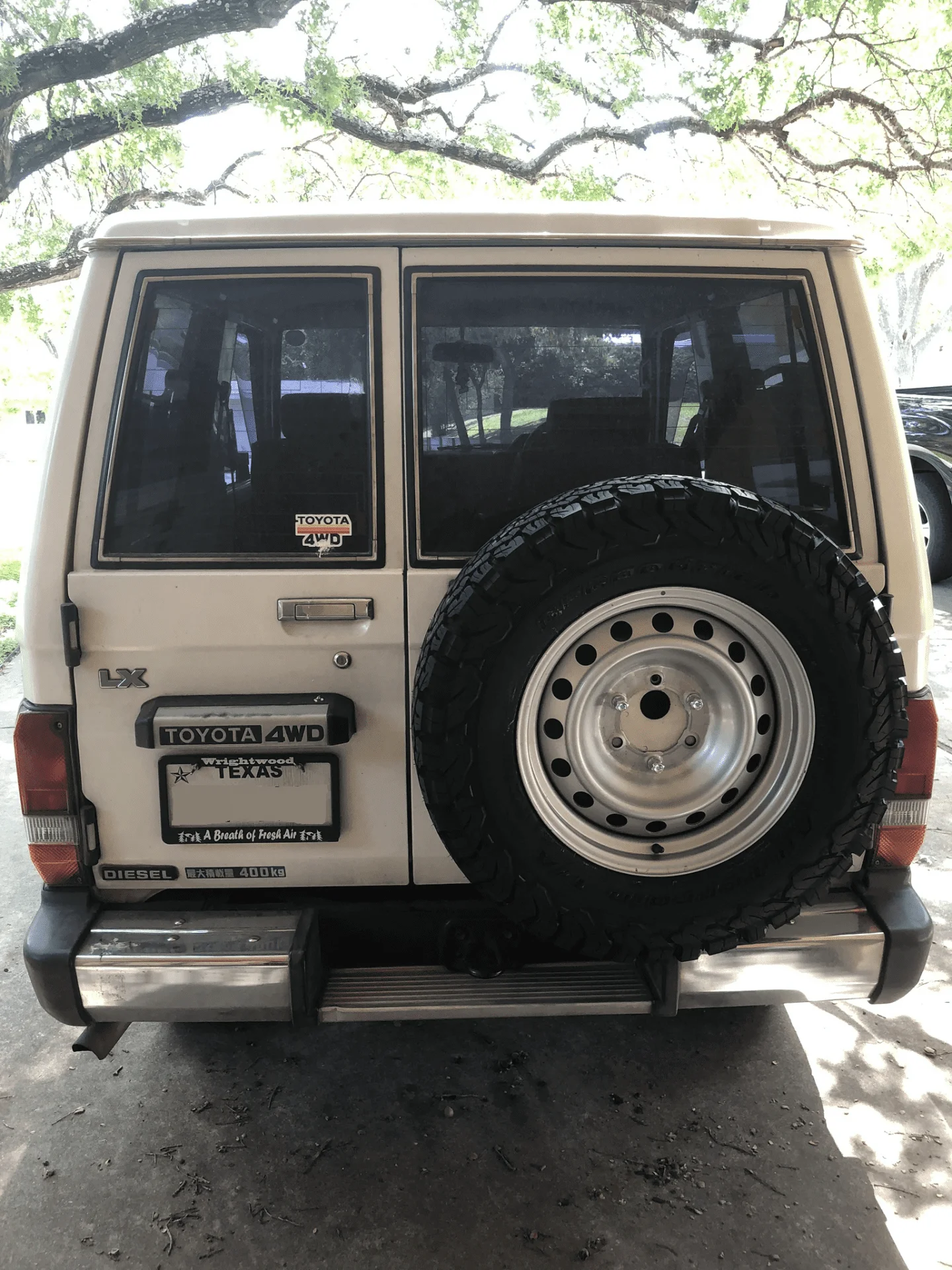

These are my next tires if I can find some 17's I like.
