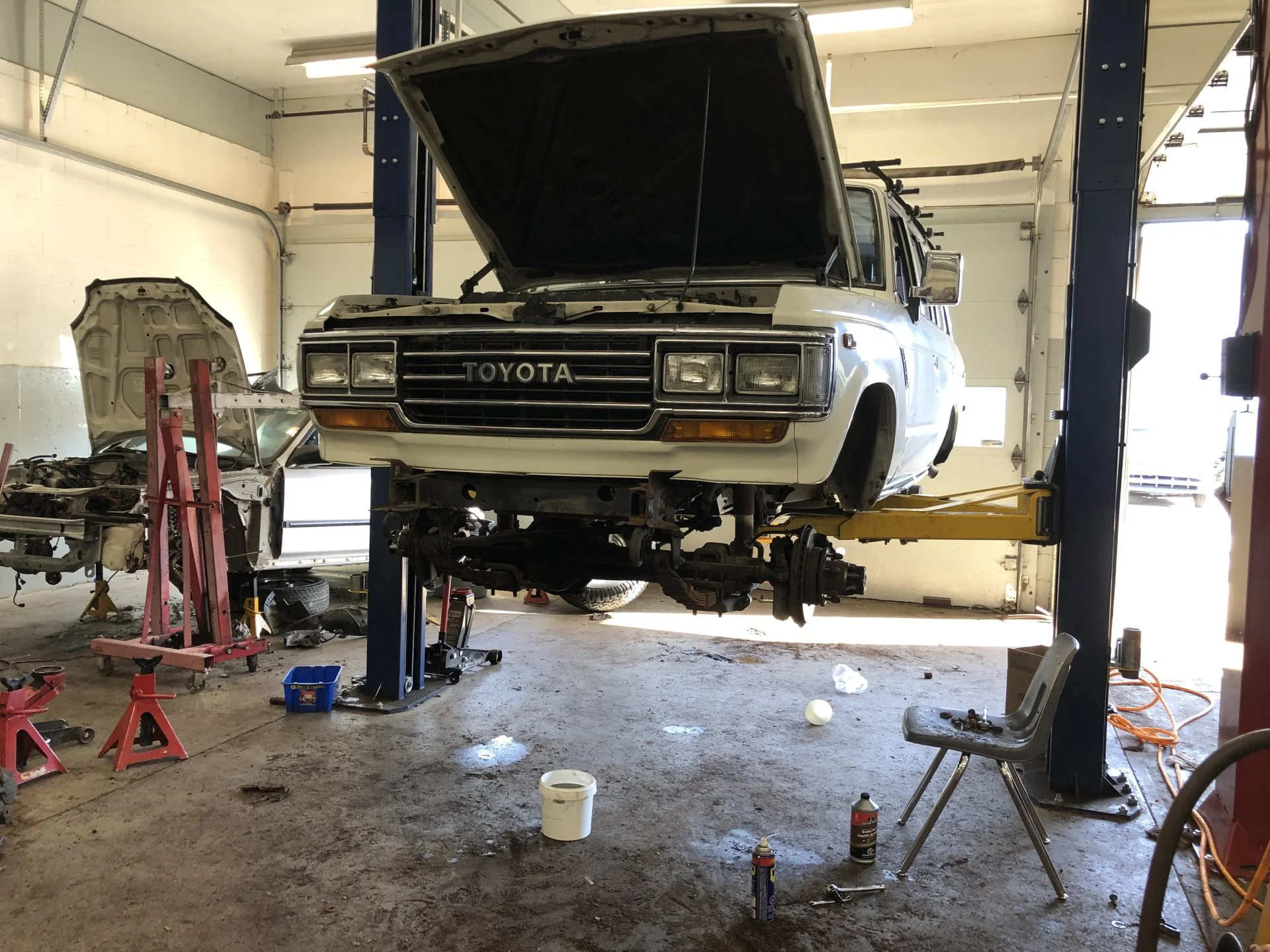

Help! In my FJ 62 the brake pedal presses all the way to the floor, though the pedal travels a great distance, it doesn’t seem to affect its ability to stop. However it’s still concerning and I don’t trust it, I can not figure out why it’s doing this. SO what I did was bleed the brakes very thoroughly, replaced the master cylinder, and the same problem still occurs. Is there possibly something wrong with the drum brakes? The previous owner replaced the front pads as well.
