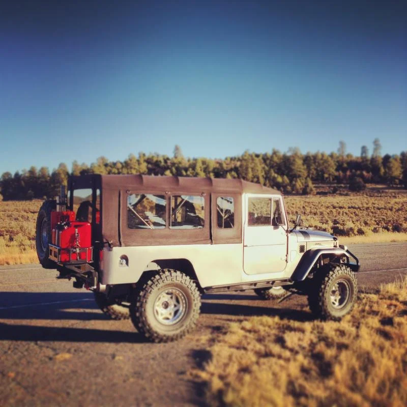

Can you tell me a little more about your LC shown here in this thread? Looks like a 43?
Its a 45. We took about 10 inch off the back end. Otherwise it would be the same as a stock troopy. We wanted a little better departure angle without making it look like it got kicked in the ass. Its a 1966 even though Toyota never made a troopy that old. We liked the style of an older cruiser so thats what we built.

Hi Timbo, I have a shortened 45 also currently in build stage. Can you post or send me lengths and whatever you did with the suspension and shocks. That ride height and tire size looks perfect and would like to get Alcan or someone to build me a set.

Don Haywood would have that info. He built the LC at his shop. Wolf Creek Rod Works. I'm sure he would be happy to talk to you about it.
I wanted some where around 4 inches of lift, Alcan spring under with 7100 bilstein shocks to fit the 37 inch tires.
10 inches may have been the perfect number. I took 12 out of mine, but was looking for maximum departure angle. I used a set of rear OME leafs from Kurt with greasable shackles, but I removed the helper springs because I installed a U-bolt flip kit on the truck. I ordered a set of 3 inch Alcan fronts in an attempt to give the truck an even stance with all that was done with the front end.
