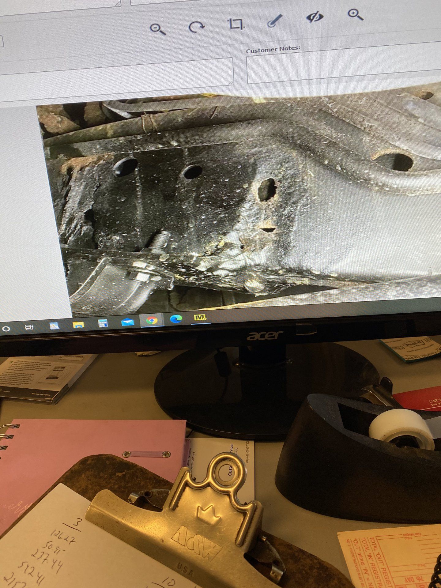

Hi all, I just bought an '01 LX470. I've been a Jeep guy for years, so this is new territory for me.
Because of Covid I couldn't travel to a rust free state and so i bought one in New Jersey.
The rig is sweet but there is definitely rust.
I found a company in Rhode Island called Auto Rust Technicians. They fix frames. It's all they do. They fabricate new steel sleeves that they say are as strong or stronger than the original frame.
Their reviews make it sound great.
Has anyone ever heard of them? or of this process?
I'm sure it will look awesome. but will it be strong to withstand off road? accidents?
Would love any thoughts on this?
Here is a link to a few videos of the rust taken by Meineke. and some photos below.
I just moved to the east coast from southern california, so i've never really seen rust before. This is all new to me.

Post some pics of the affected areas and what needs to be fixed. They can be fixed within reason, but if they do it right, it will not be cheap.

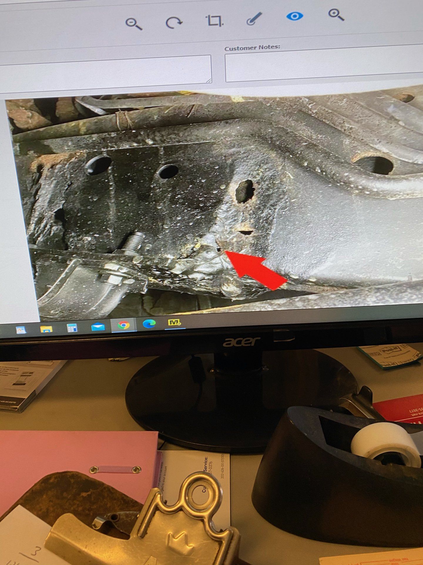

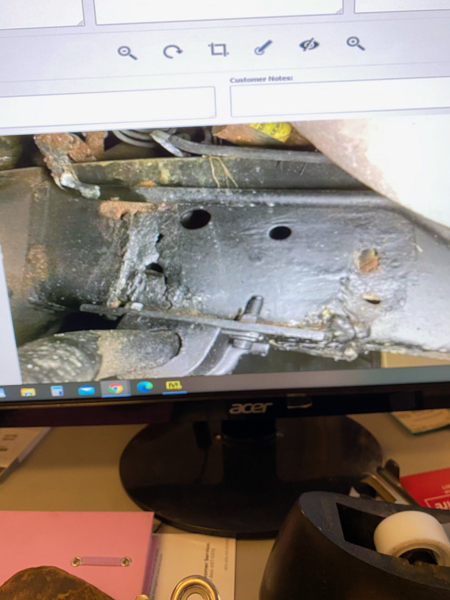

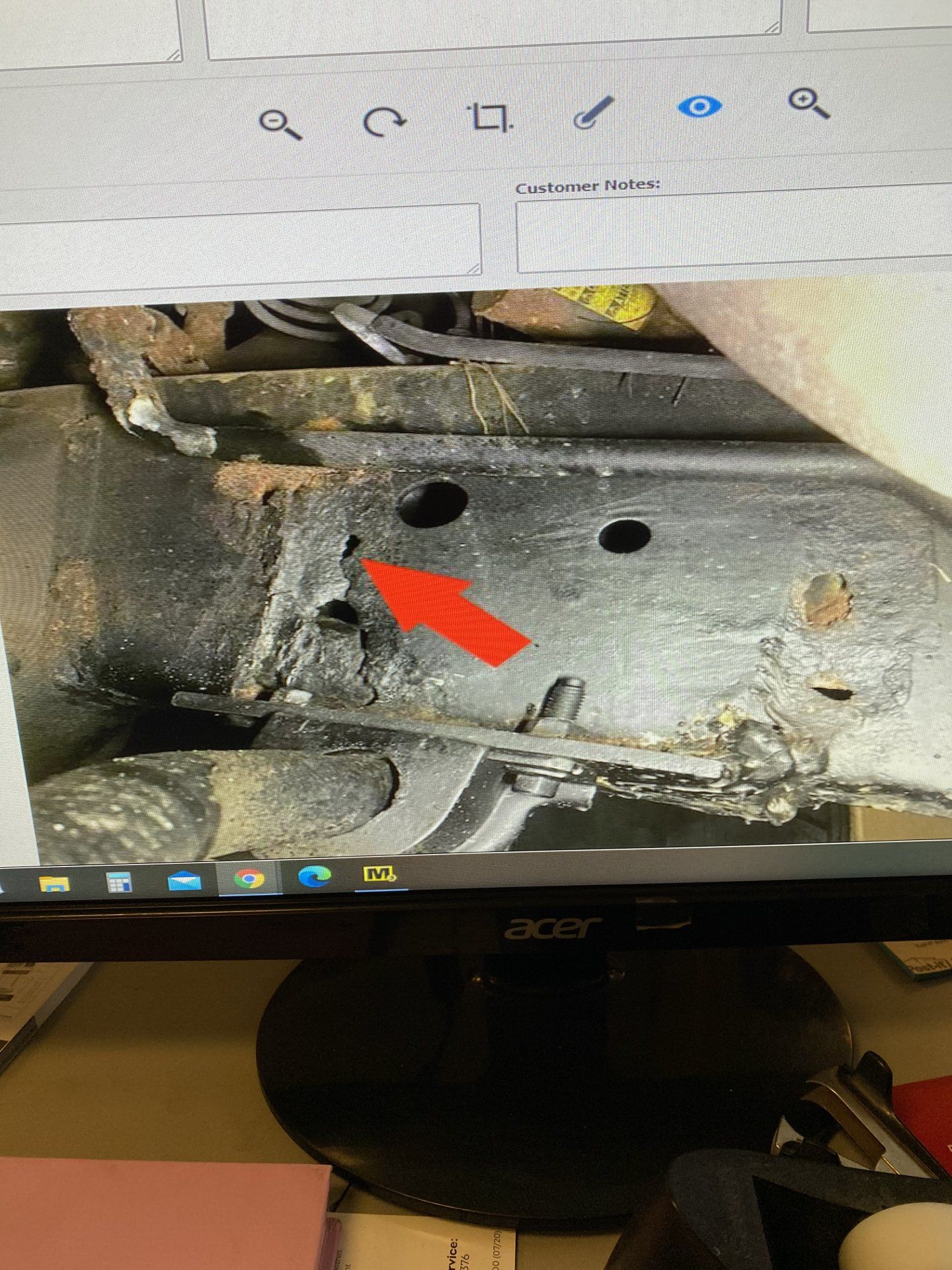

Your first pick, that rust I assume is on the passenger side of the vehicle. Just above there the AC drain drops water from above, rusting that section of sway bar and your frame. That appears to all be fixable, if they cut that out and weld in c-channel steel. There could be more rust though based on those photos at the rear of the vehicle. You should have the entire belly spare tire region inspected along with the rear frame support by the bumper. To repair the rust shown I would expect the bill to be upwards of a thousand or more. Another concern would be the state of your brake lines towards the rear. Hope it’s all isolated to just the are you showed in the pictures shared.
thanks rocks. I'll get it back up on a lift and take some more pics, i asked the guys at Meninke to photograph everything they saw that was bad, and that's all they sent. did you get a chance to see the videos in the link in my post?
The brake lines going back towards the gas tank don’t look bad, rear cross member looks decent as well. You may be okay just having that front section repaired. One thing to think about is the frame can rust out from the inside, the outer wall of the steel as shown in the video looks decent, but the inside is a different story. I would take it to the place you mentioned and get a quote and have them do a complete inspection, inside of frame rails included. You may want to ask for and check up on references, yelp, etc.

That is the most common area to rust out on a 100 series. Get it cut out and welded by the professional you listed. Then you need to get the rest of the surface rust wire wheeled and treated with a rust preventative film. This is the best around today : RP-342 "HEAVY" Military-Grade Rust Preventive Spray - https://www.cosmolinedirect.com/cosmoline-rp-342-heavy-spray-military-grade-rust-preventive/

Judging by those pictures, the front sway bar mount has already rusted and broken off and was replaced. The welds look like trash and it appears they attempted to coat it with rust proofing, but clearly left some soft spots.
It "should" look like this: (not crusty, but the shape of the bracket is different)
