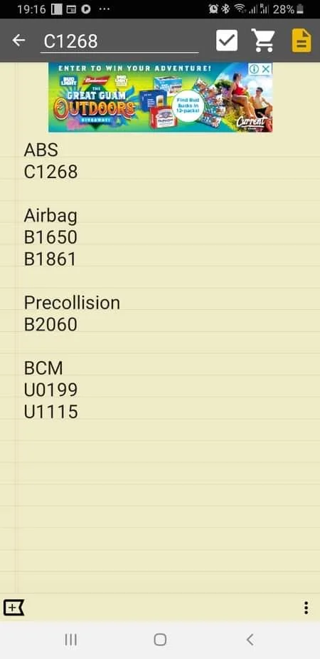

We have a ‘08 LX570 with 93K miles. We are the 3rd owners.
I posted a thread awhile back but our LX developed intermittent then gradually persistent transmission issues for the past 2 yrs where we mainly experienced a delay in engaging in reverse. We accepted it would eventually need a tranny rebuild.
The problem progressed later where we experienced intermittent issues shifting into 4th gear and it would hold in 3rd and occurred mostly in the morning. Sufficient warming of vehivle would make it go away.
On the occasion when it struggled to get into 4th, we got an immediate VSC, PCS, stability control, and ABS light that would not go away or cannot reset with a code reader.
Transmission is now thankfully fixed and now shifts smooth like butter. Thinking the fixed transmission would clear the error lights, we are unfortunately getting the dash light warning lights. No cigar with Unplugging battery.
I have attached the error codes (ignore the airbag codes since selt belt tensioner and SRS light has been repaired under Toyota TSB).
We have been told it can be anything from a faulty speed sensor, faulty ABS, faulty cruise control distance sensor to faulty H4/L4 actuator.
Is it a coincidence that these fault codes occurred while the tranny was faulty or am I looking at something more sinister?
Thanks!

I went to a shop that had a more advanced code reader (Genisys Evo) and it gave the following codes info:
B2060 - ABS, secondary system SMART KEY - 3.5L
C1268 Transfer L4 Position Circuit Switch.
Anyone know what the ABS smart key secondary system is? Thanks for all the help so far everyone.
