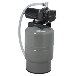

I would just put a shallow well jet pump system in that pulls from the tank and stores the water in a bladder tank. The tee that ties the pressure water back to the tank inlet is the problem. as soon as the water level drops and the float opens to fill the tank your pressureized water dumps to the holding tank.
You need to eliminate the line from the pressure system that tees back into the tank supply line or at least put in a valve that can be shut.
a shallow well system looks like this, and you could run the water supply from the street through a spring check valve into the shallow well pump inlet and not need the cistern at all.
