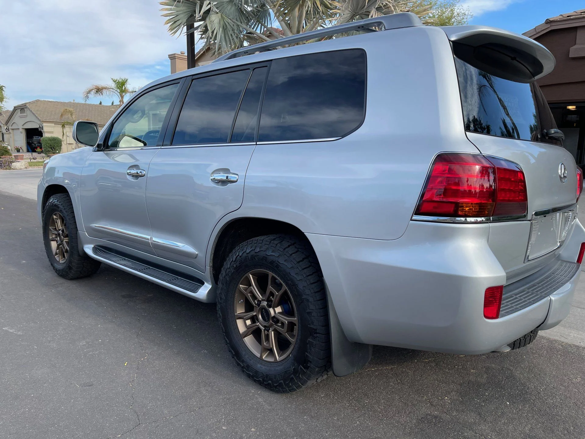

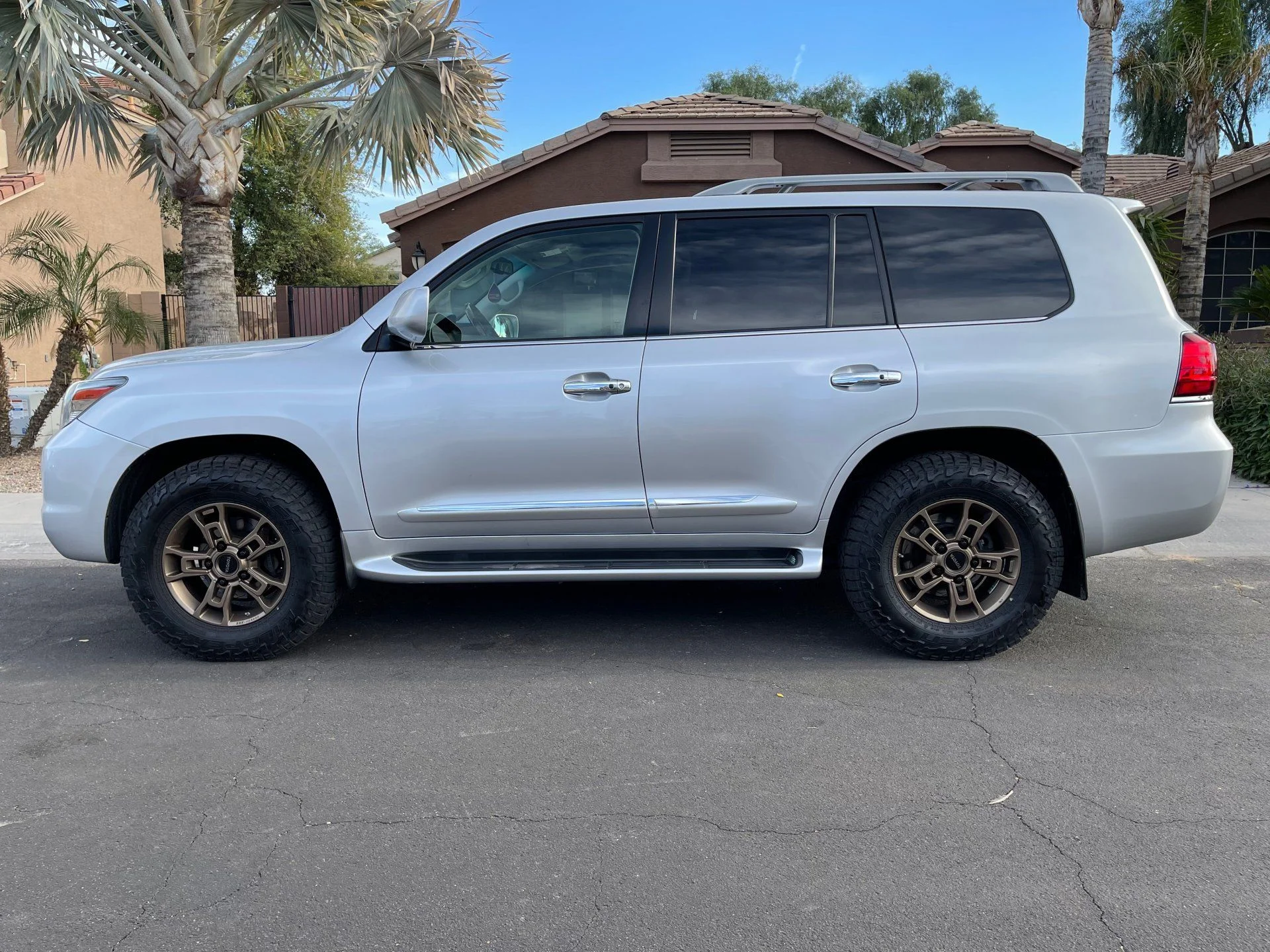

Finally got around to adding the spacers you educated me on. Spidertrax WHS023
Thanks!
