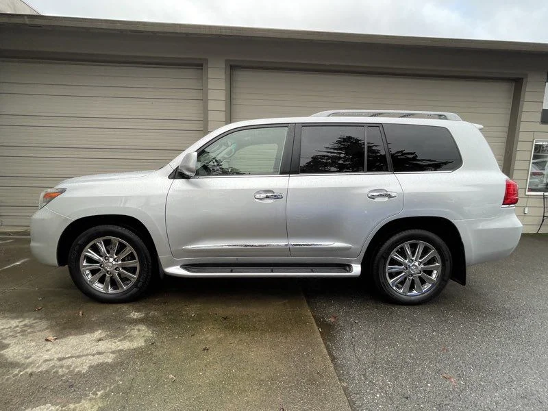

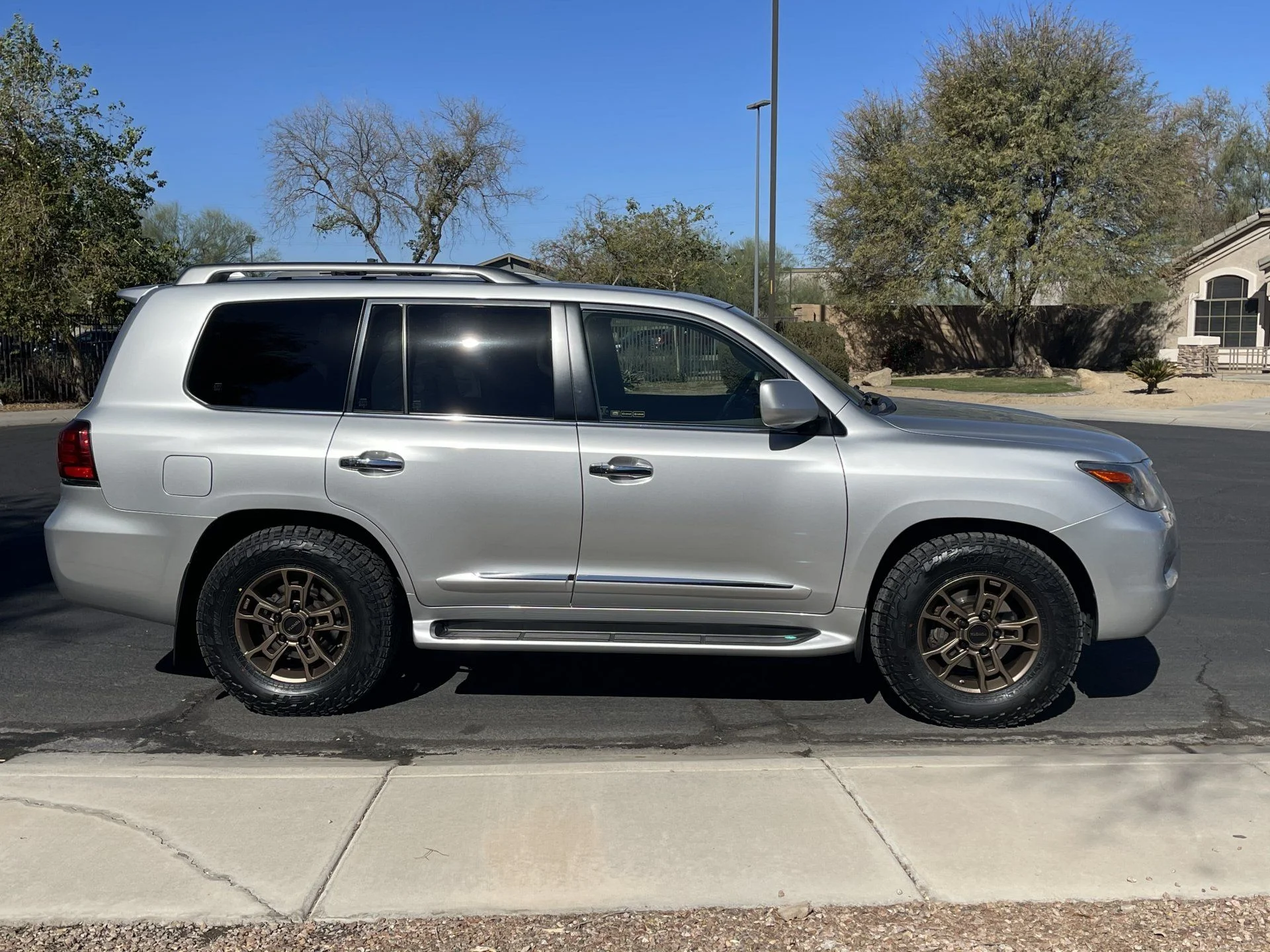

I recently bought a 2011 LX570, 90K miles. Besides doing the 90K mile service (flush and replace all fluids, etc) I have decided on my first project/purchase.

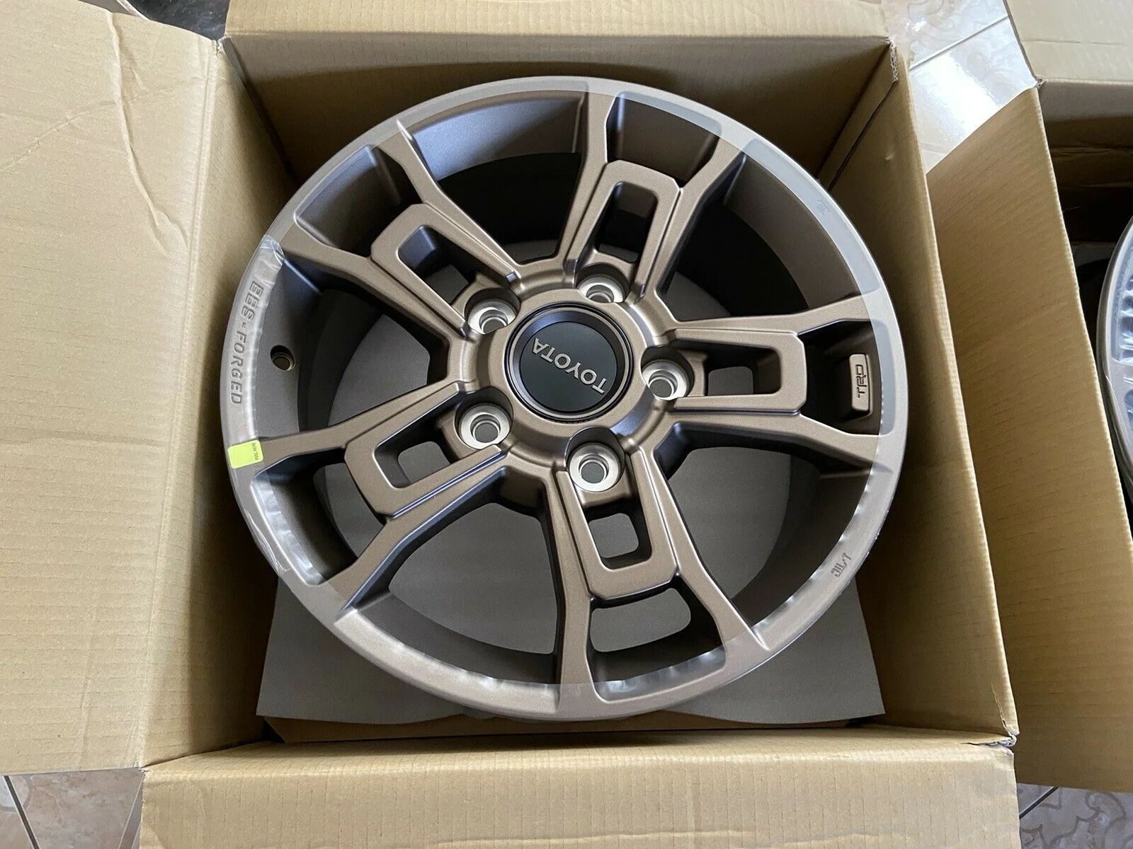

It took me a while, but I just bought (5) of the 18" TRD PRO BBS HE Bronze Rims. Not super easy to find, very not cheap either.
I have attached a before pic of my LX and a pic of the rims I swiped from ebay (The pic is from eBay, not the rims).
I think I am going to run 275/70/18 Wildpeak A/T3W's. I'd like no rubbing, no spacers and no lift.
