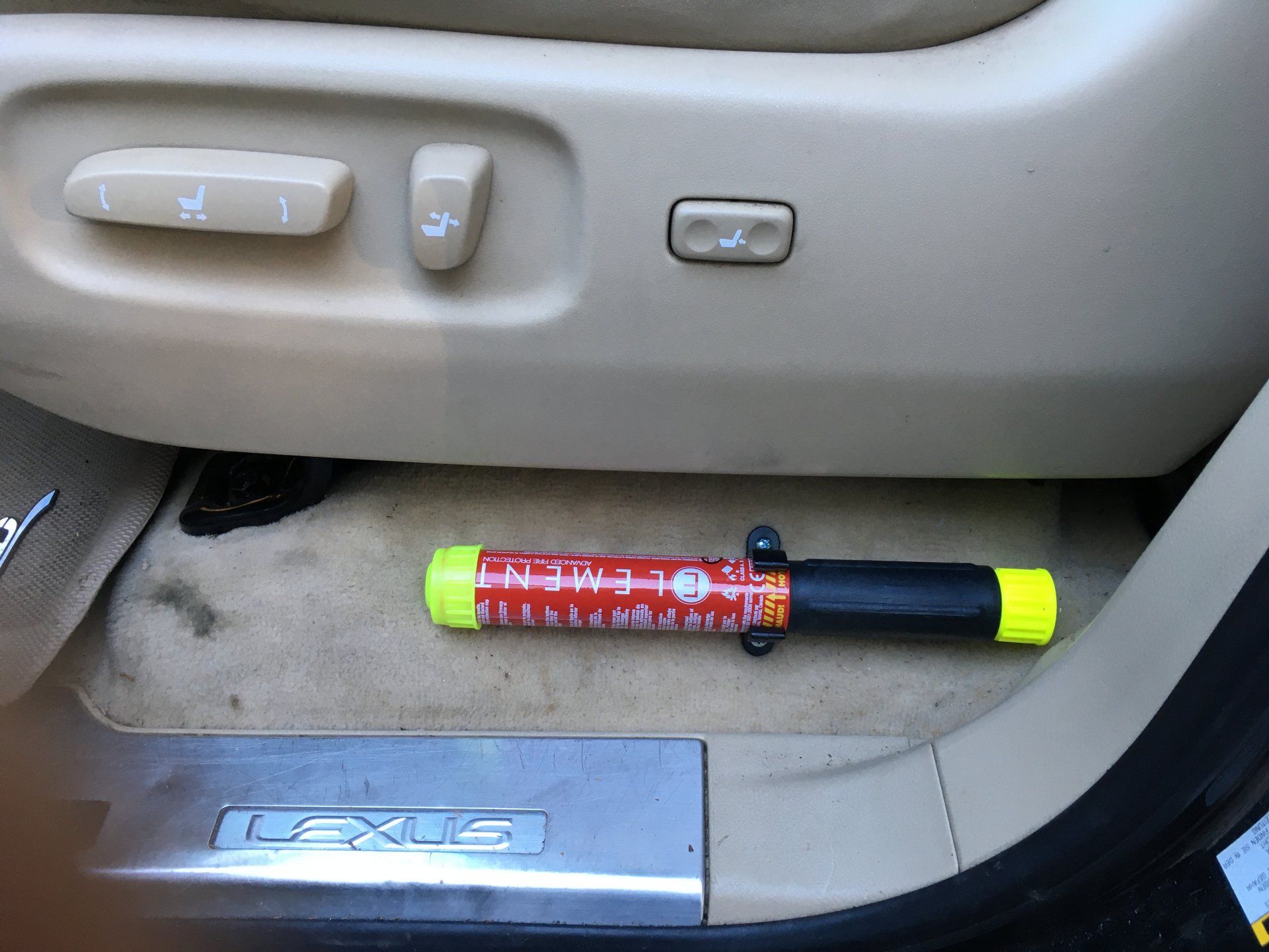

Element beside the driver seat. Grab while seated with door closed. Grab from outside with door open Clip comes with it.

That's a good spot for the element👍- I keep mine in the door pocket but I like your solution better.
How effective is that tiny thing?
I can personally attest to they are great! That 50 sec burn time feels like a really log time! I had a carb fire start and buddy was able to grab his element before I could run to my 200 to grab mine after not being able to fumble the regular extinguisher off the mount on the 40. Someone also ran over with a small traditional extinguisher.
Pros to traditional style:
- you can spray as needed
- don't waste full bottle all at once
Cons to traditional style:
- small tanks that you would carry have a very short spray time before empty
- can leave residue on vehicle and parts
Element pros:
- really compact!
- 50sec burn time feels like forever
- no residue left behind (it starves the fire of its oxygen)
- after the fire is out you still have a lot of burn time to do silly things with the smoke coming out until its done
Element cons:
- once you strike it, you have to keep it going for the 50 seconds and then its done
- where the smoke comes from that starves the flame gets really hot
- you really should only hold the black part of handle when struck and after it finishes
