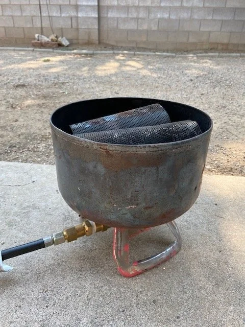

Anyone in the club interested in inexpensive gas campfire options and projects I offer my metal fabrication services and flammin' hot fire pit expertise for free. I have done several of them big and small, even a collapsible for my motorbike. (Plus, I'm single, have no kids and somehow need something else to do....)
Bring me the bits you need zapped, chopped, bent or holes poked and I'll knock it out.
Here is one of my quick and dirties, a party balloon helium container cut in half.
(I have a spare helium cylinder if you want one of these.)

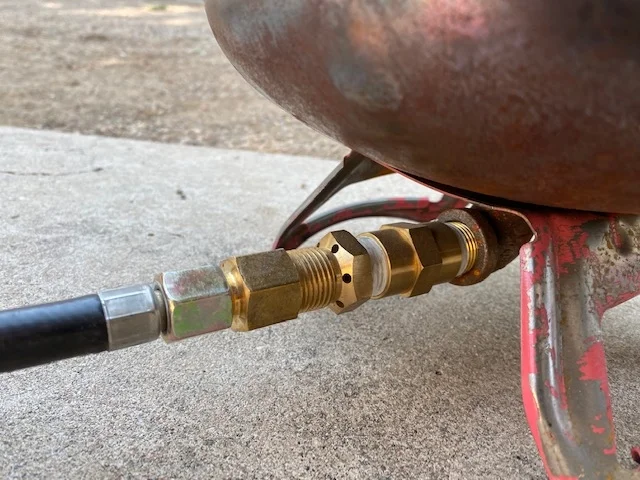

This is a key part, about $15 from Amazon. It's an air mixer for the stoichiometric calculations that I do for every firepit I build. (BAWH HAW!!!- NOT!)
Rolled up expanded steel "Logs".
Very fast, simple and did not cost a hundred bux. Probably about $25.
