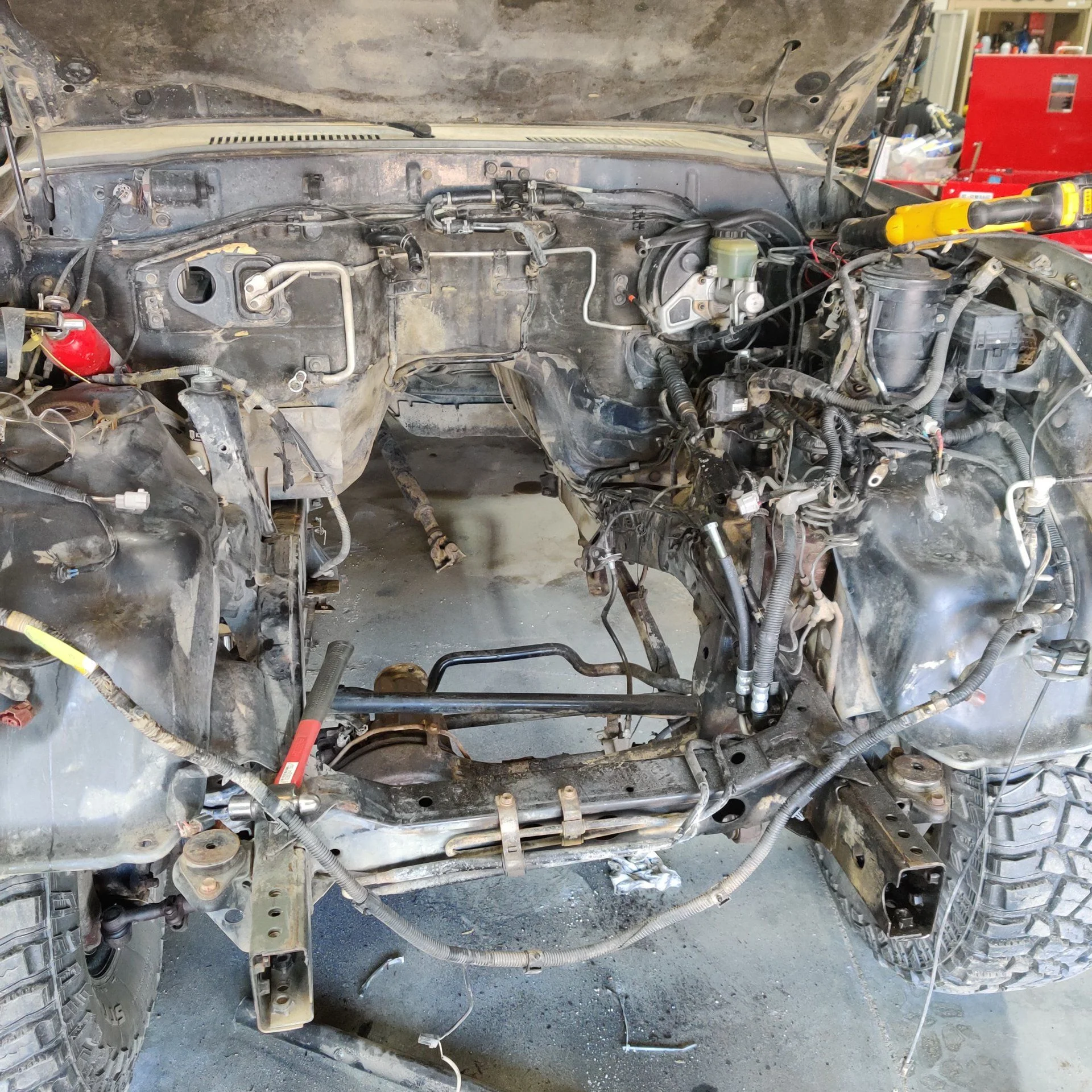

Here we go. Been a couple years in the work. Started when I bought a 2005 Denali Yukon with an LQ9 and low oil pressure. I rebuilt the engine and transmission then got busy with my first kid.
He's now 19months old and will have a little brother in 4 months so I need to get this going or I will never get it done. I have read through a lot of other swaps and done a bunch of Research. The biggest challenge I am going to have is getting the factory Yukon intake and exhaust to fit under the hood and in the frame rails.
If anyone has done a California emissions legal swap please feel free to let me know what you did.

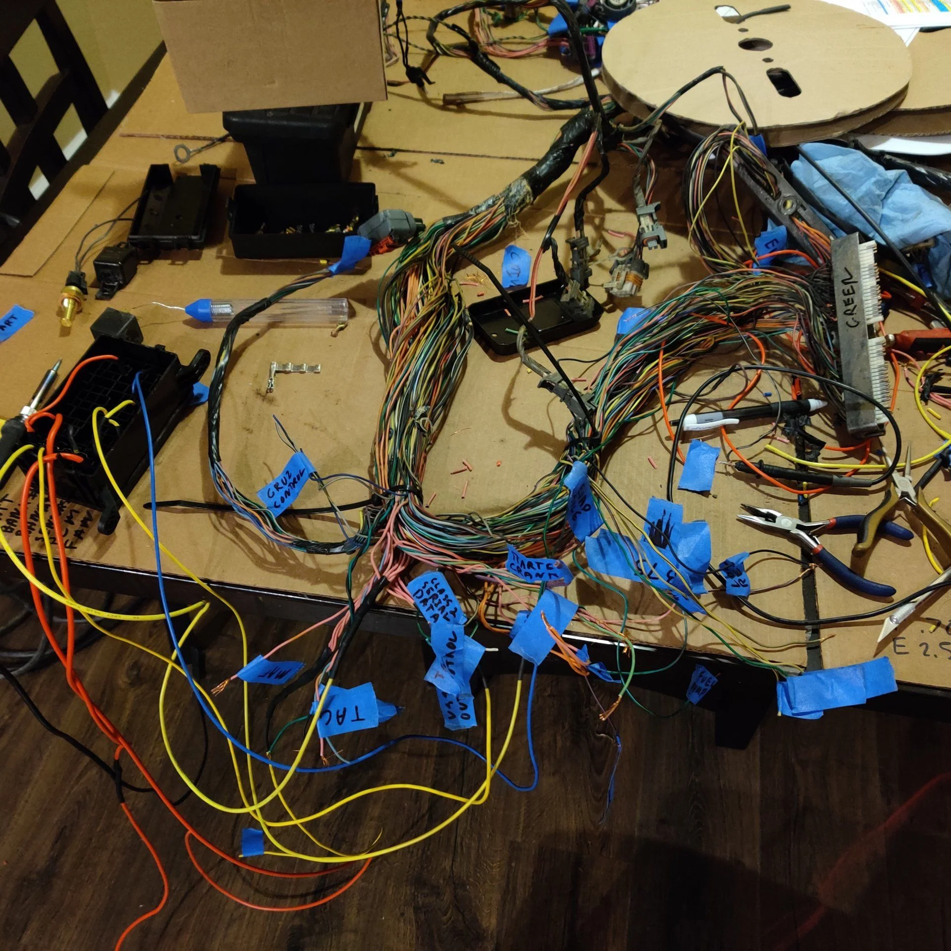

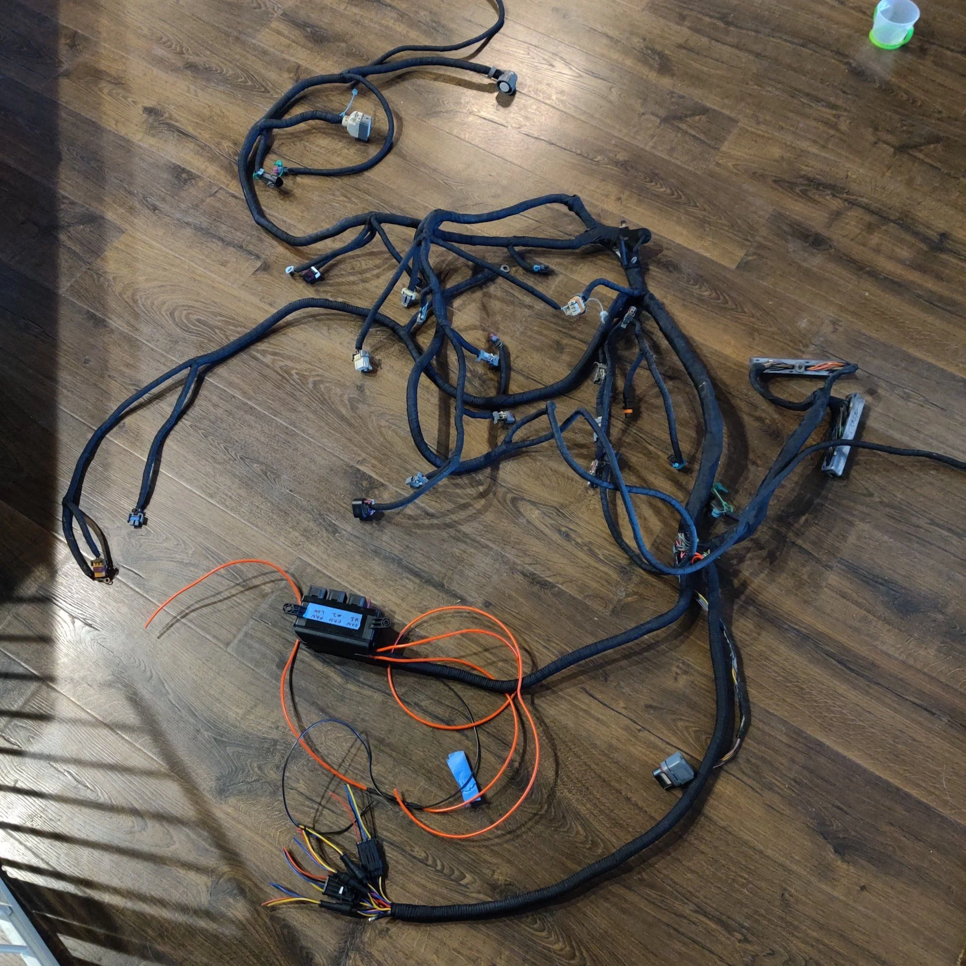

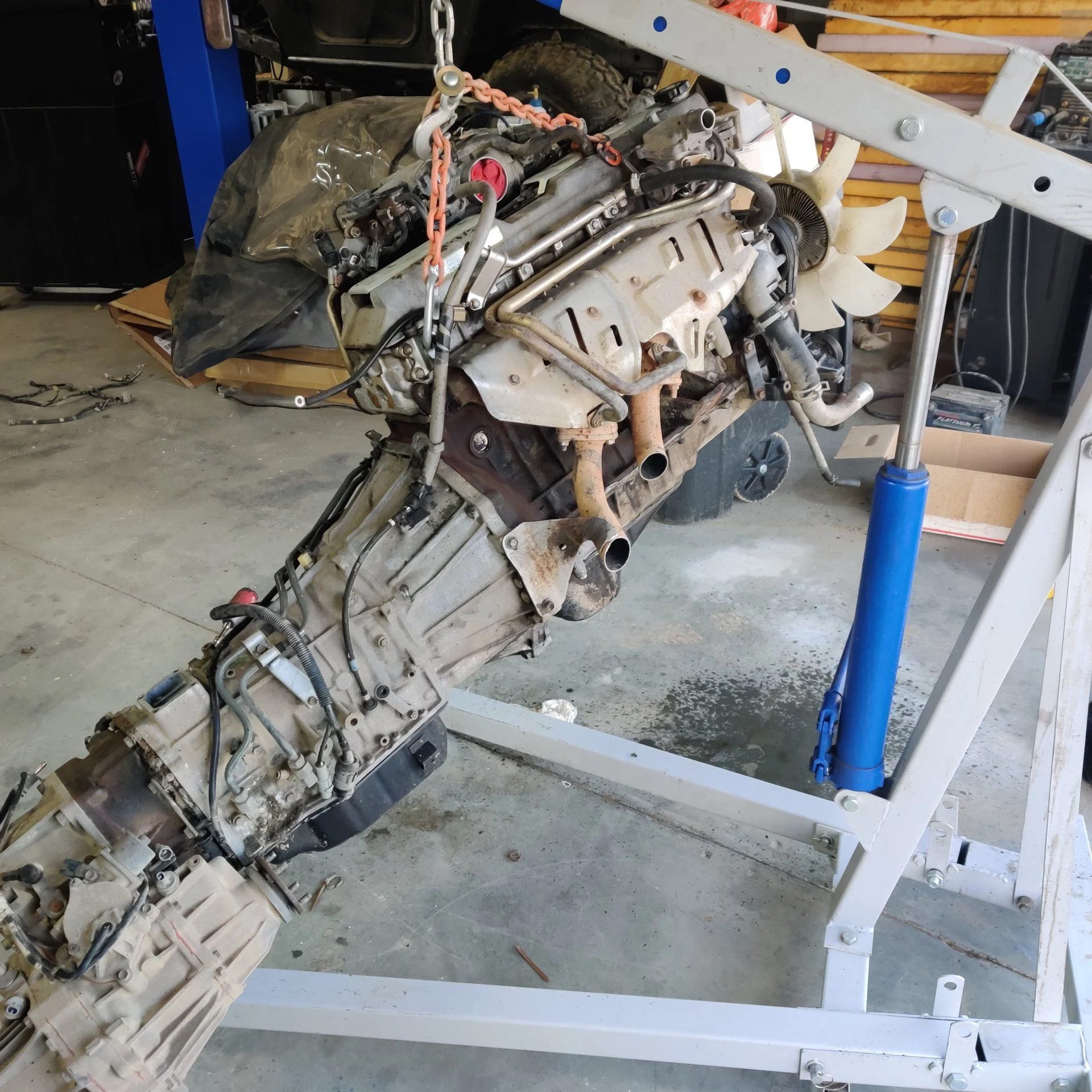

So far I have the factory harness de-pinned and cleaned up. The factory LS harness is pretty close to being done and I have an aftermarket fuse/relay box wired in.

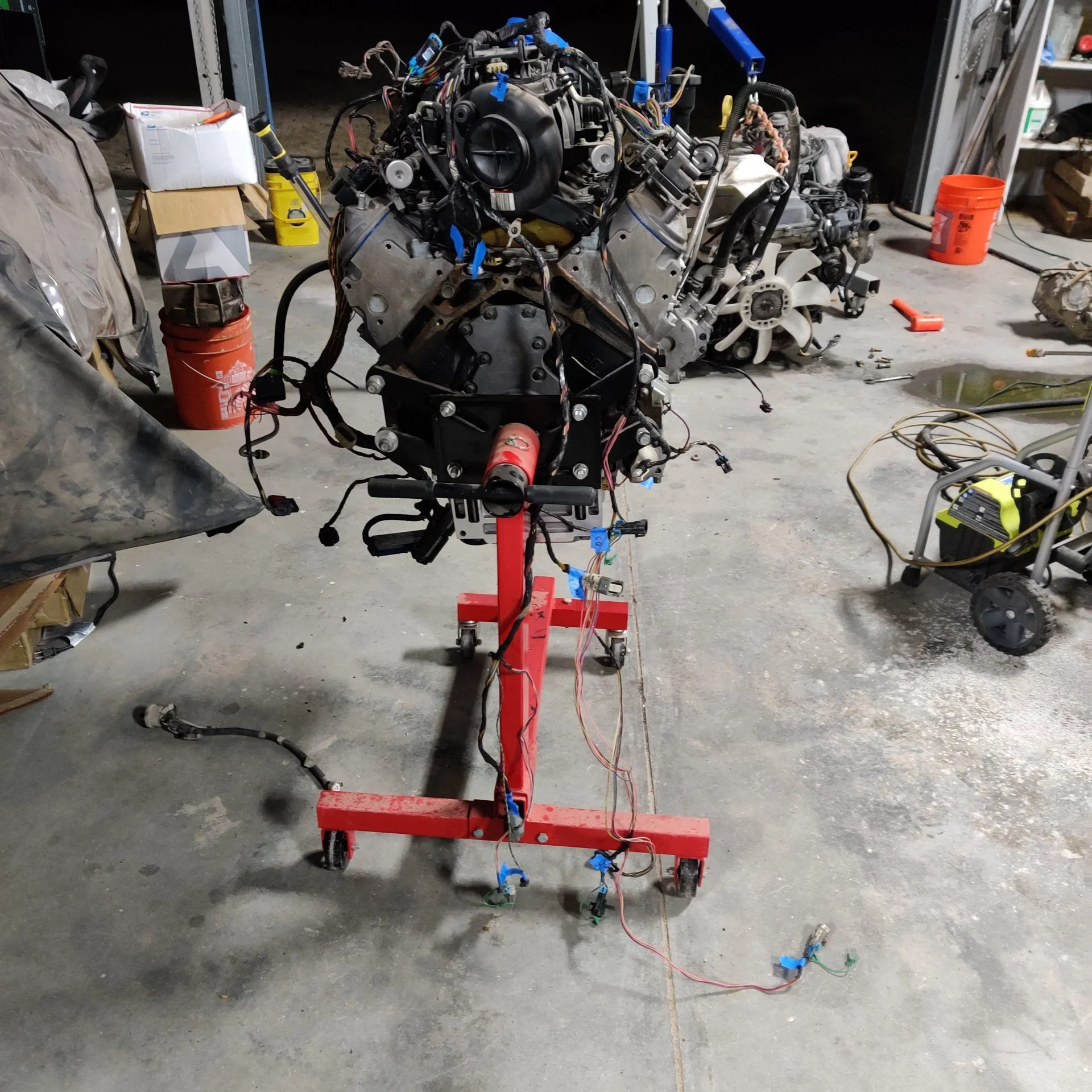

Old engine/trans is out and already sold to another mud member.
