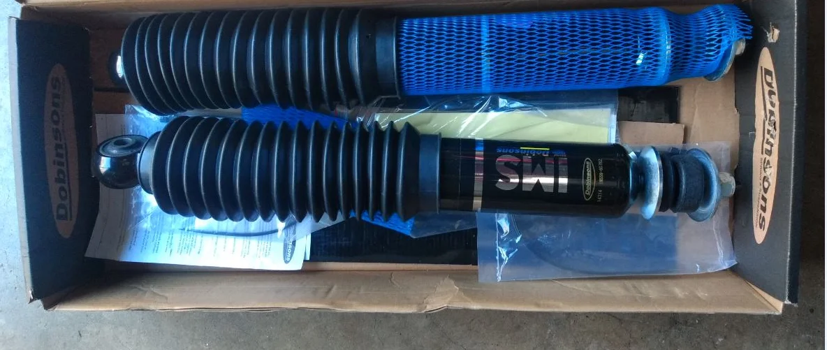

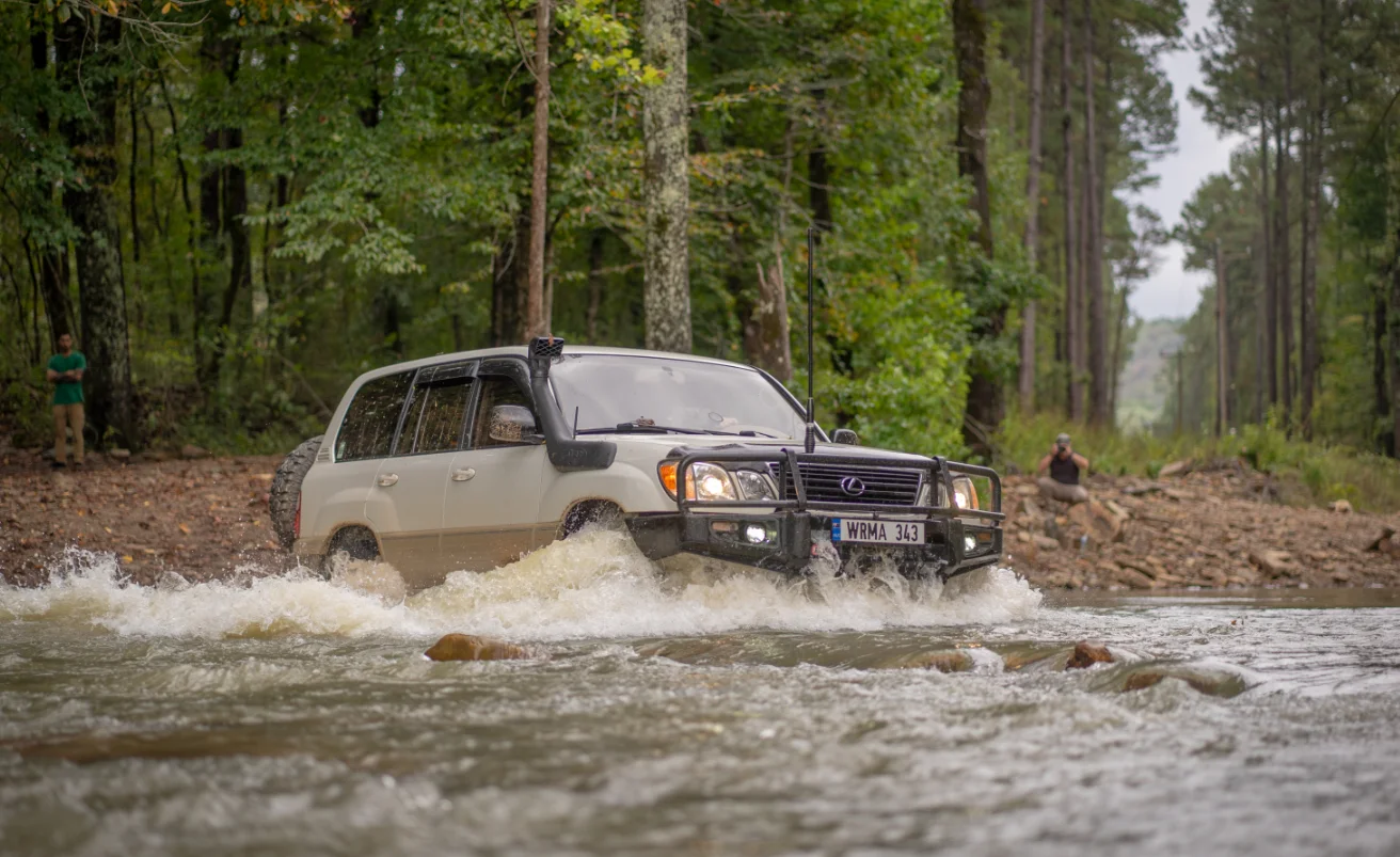

I get into a lot of rocky water crossing scenarios where the plush yet controlled ride strikes the perfect balance for me. The upper mounted pistons with lower shaft boots protect the shocks from the small rocks that I kick up on the trails.
A 2" front with a 3" rear lift is a must for the type of water crossings that I like to make. The 3" rear lift reduces the chance for the factory receiver hitch from hanging on rocks. It still happens once in a while, but the lift reduces the likelihood of that occurrence.
Now that people have figured out that Dobinsons torsion bars reduce work for the installer, demand has been increasing. DIY types like Dobinsons installation because the bars are pre-marked at the factory before being boxed. Dobinsons do not require fussing around with a straight edge, a sharpie, and counting spline tickmarks for installation.
Demand for Dobinsons product is running high. I think there may be some Black Friday Sales at the moment. @crikeymike
With a product that is in high demand, they do not need to constantly run "circus tent promotions" to sell products.
Considering that I have Dobinsons IMS/MRA on two of ours, and a set of Dobinsons IMS sitting in boxes ready to go on the third, I’d tend to agree.
Here's a picture of the protective boot in action.
