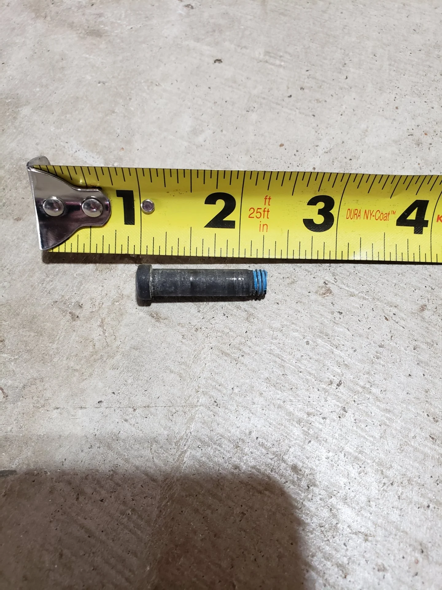

This sheared bolt fell on me while I was under the LC. It fell from somewhere directly in front of the drivers front tie rod but, which I was tightening and was bumping around a bit right there.

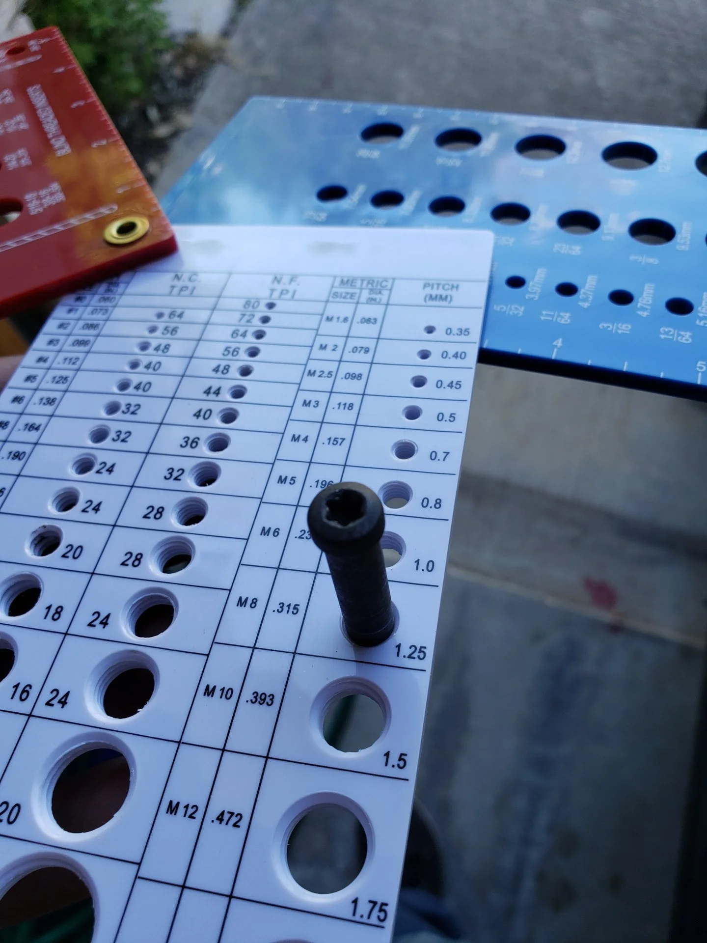

It's a T25 torx, 1.25mm thread.
That bolt had a brittle failure (see smooth surface and slight angle) and for its size would have had more threads on it. For sure worth figuring out where it came from and replace.

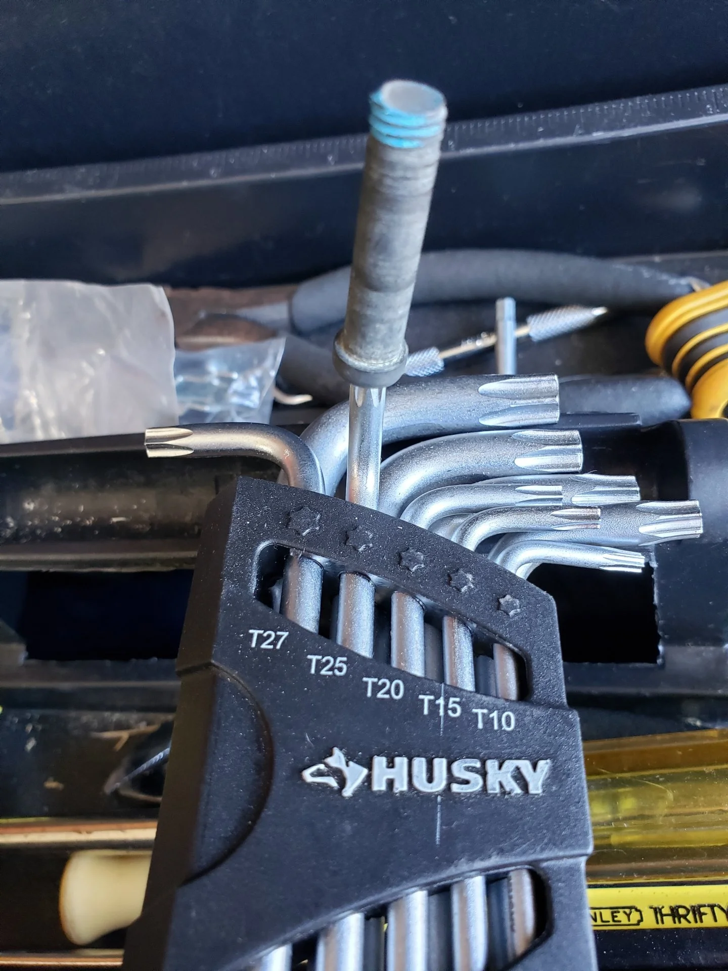

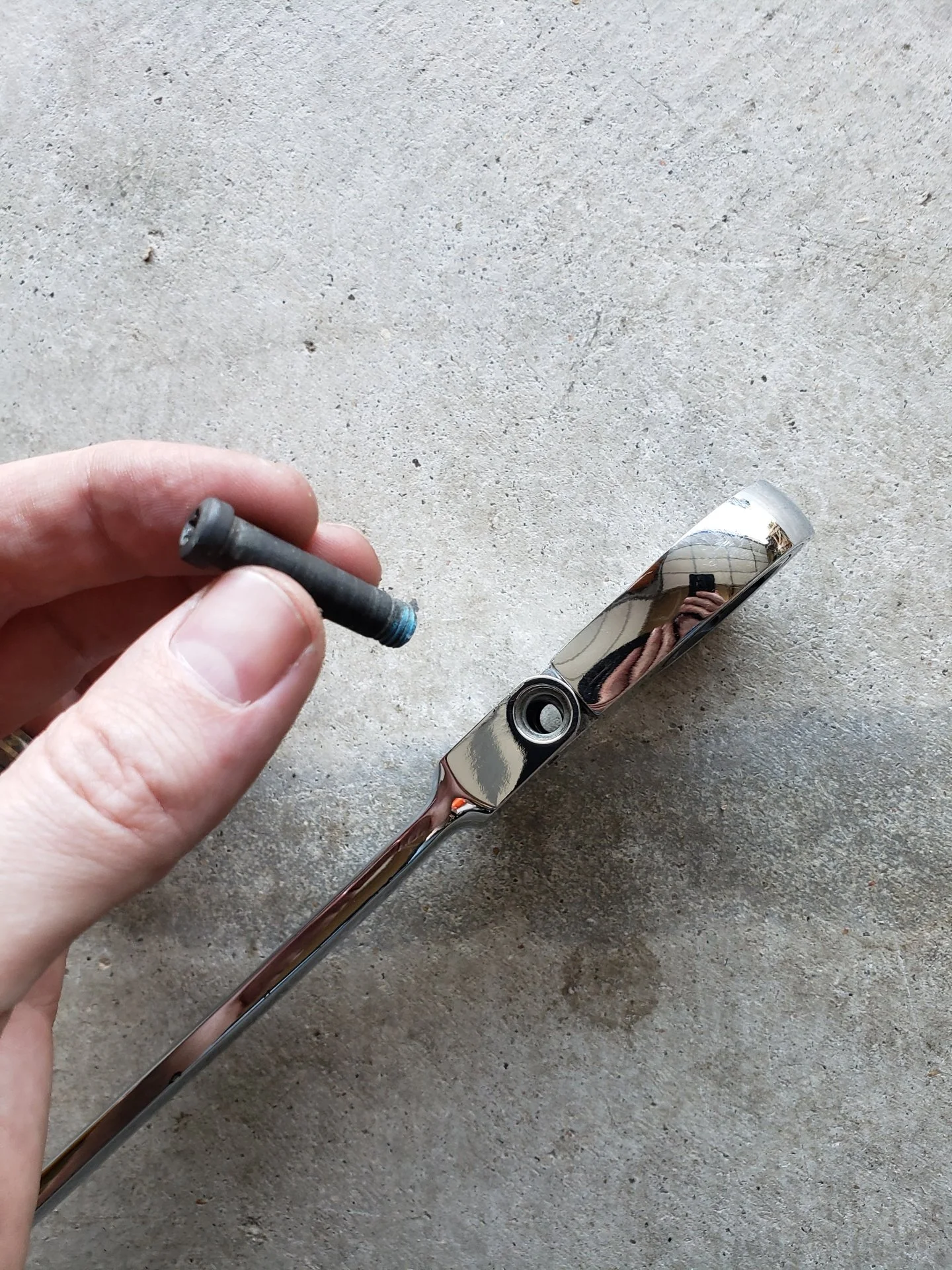

It came from the swivel head of my ratchet wrench!!! :oops:
The head did not fall apart, and still swiveled like normal even without the bolt.
Just curious, did the bolt fit back in or was some of the thread missing...?
Yes, it fit back in. The end looked sheared / broken for sure (and perfectly clean, no dust), but it actually wasn't broken. The end of the bolt on my other wrenches look the same. I think it being inset a bit must have kept it looking pristine like a freshly cut bolt.
