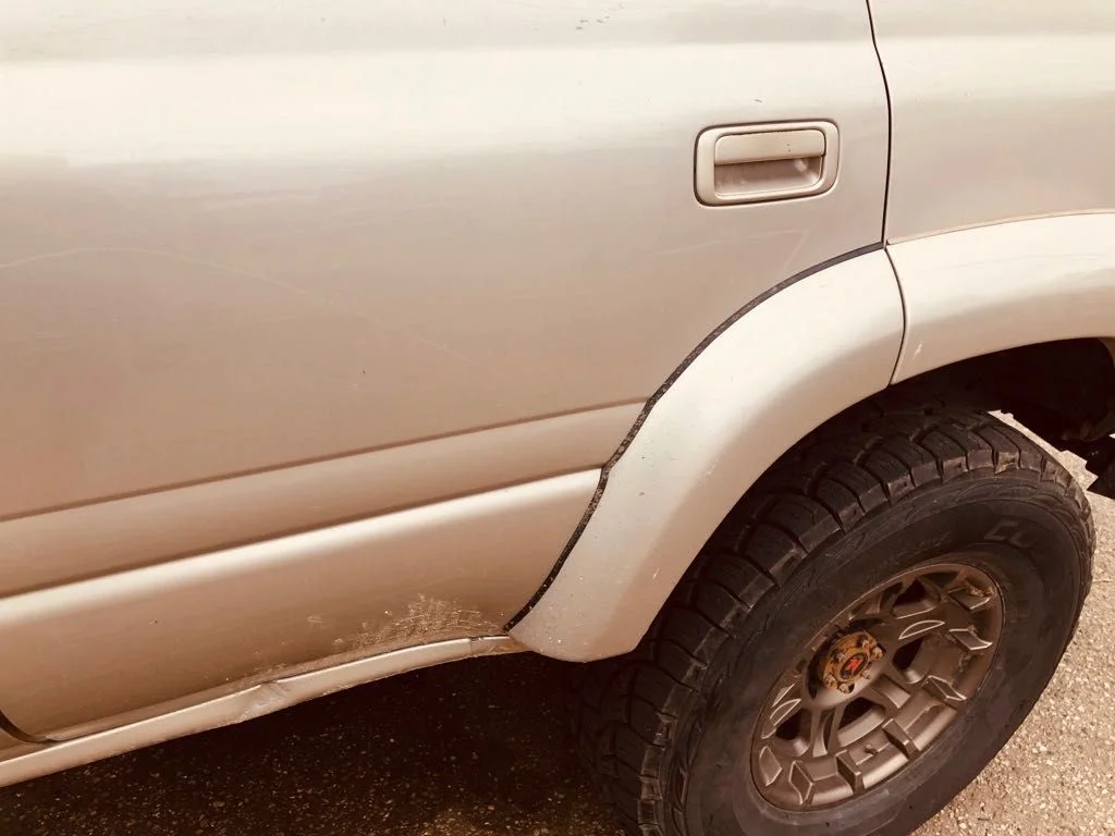

The tan ones...could it be better to go with black than to hope that brand new tan gaskets will match the 30 year patina of a tan vehicle? That said has anyone seen where black gaskets were used in place of tan? Does it look decent or dorky?
Can post a pic of personal rig that has one section in a bit
@LandLocked93 here is what black looks like on a tan exterior. Have had tan ones on order for a long time, kind of a crap shoot when those will actually get fulfilled.
👍Copy on the tan arrival. Thanks a bunch for the pic. Super helpful, as always!
