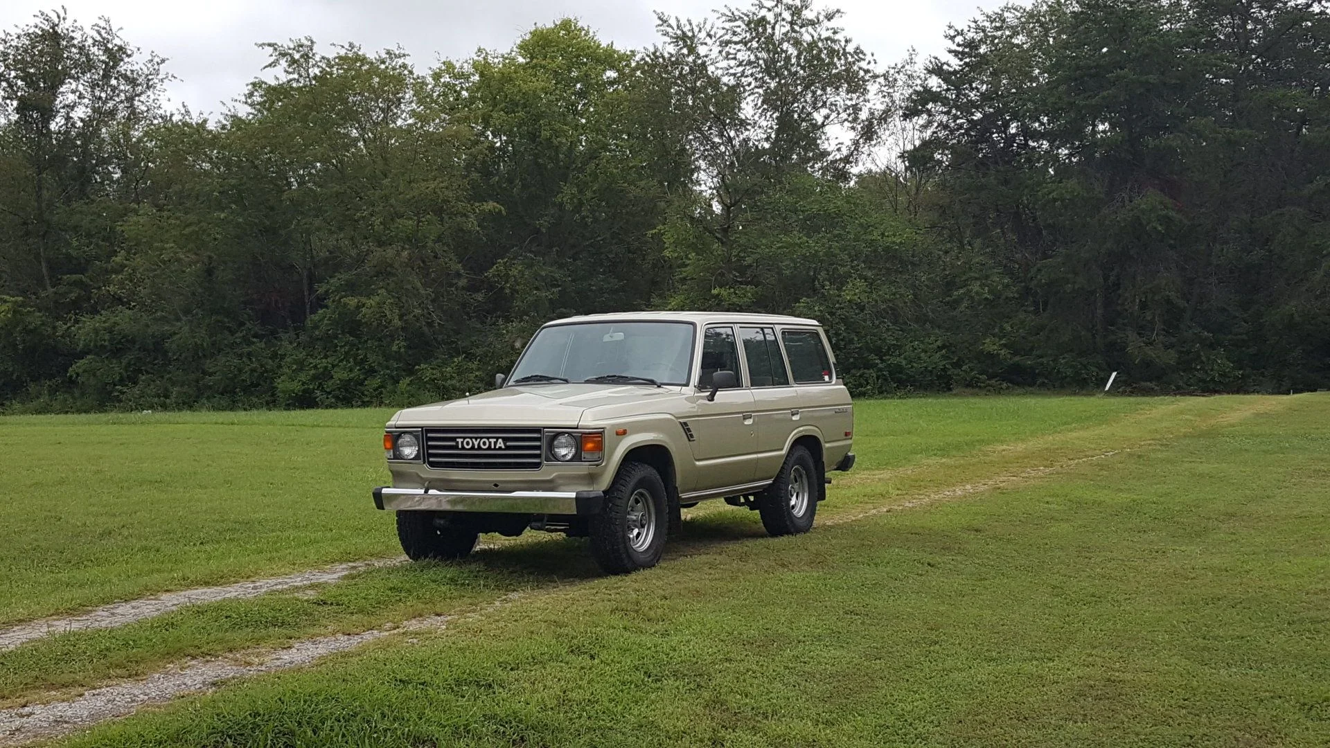

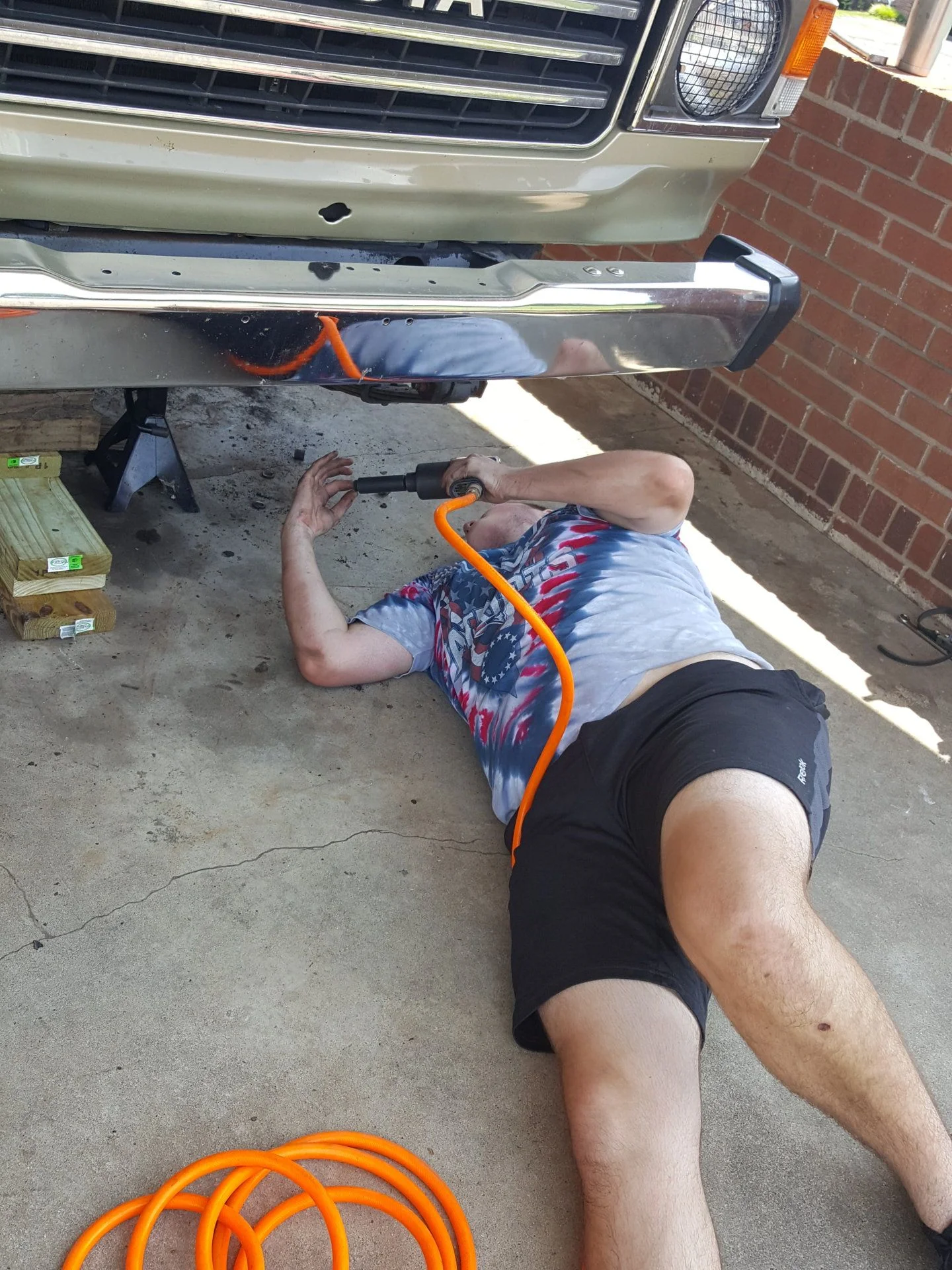

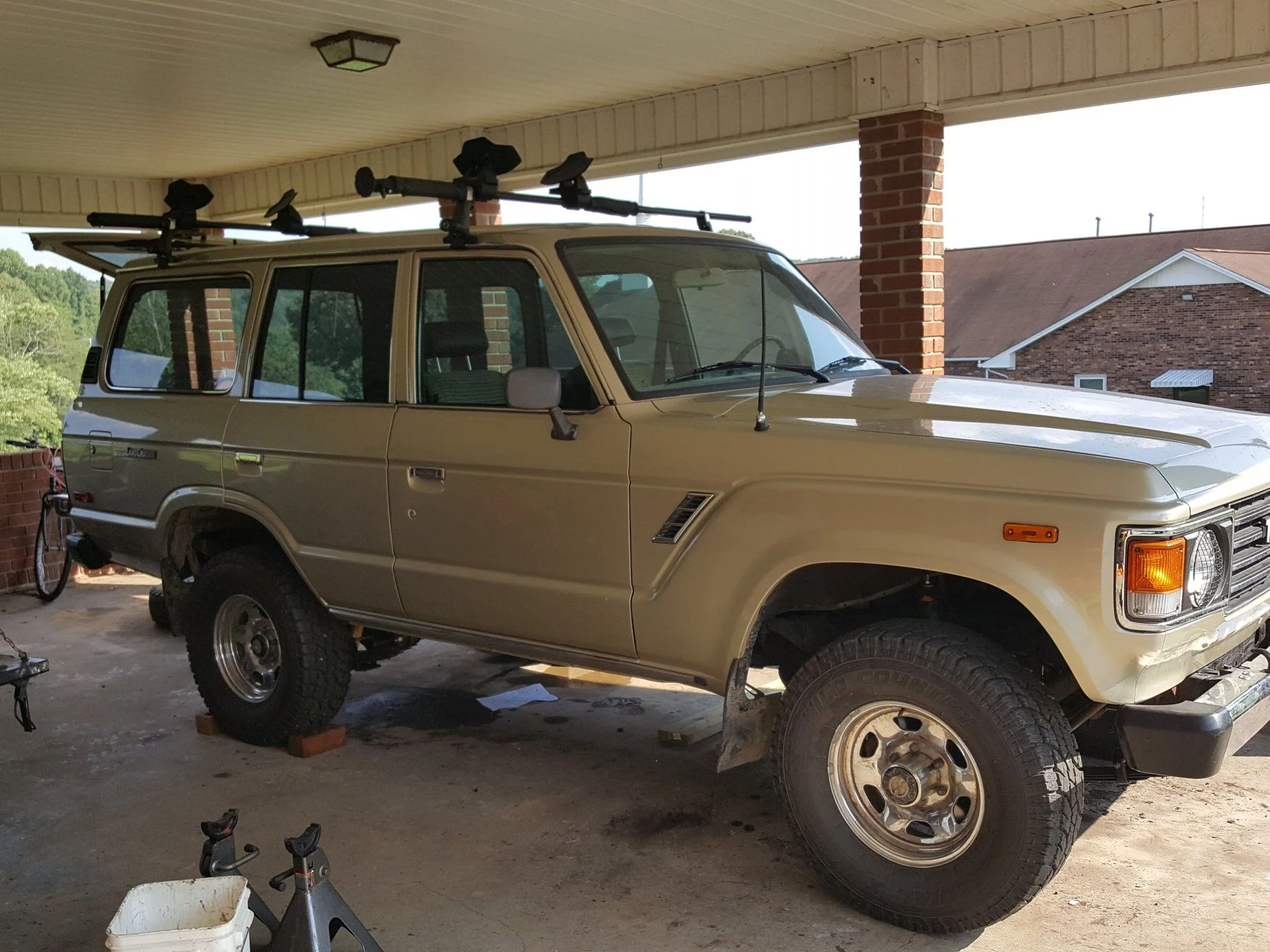

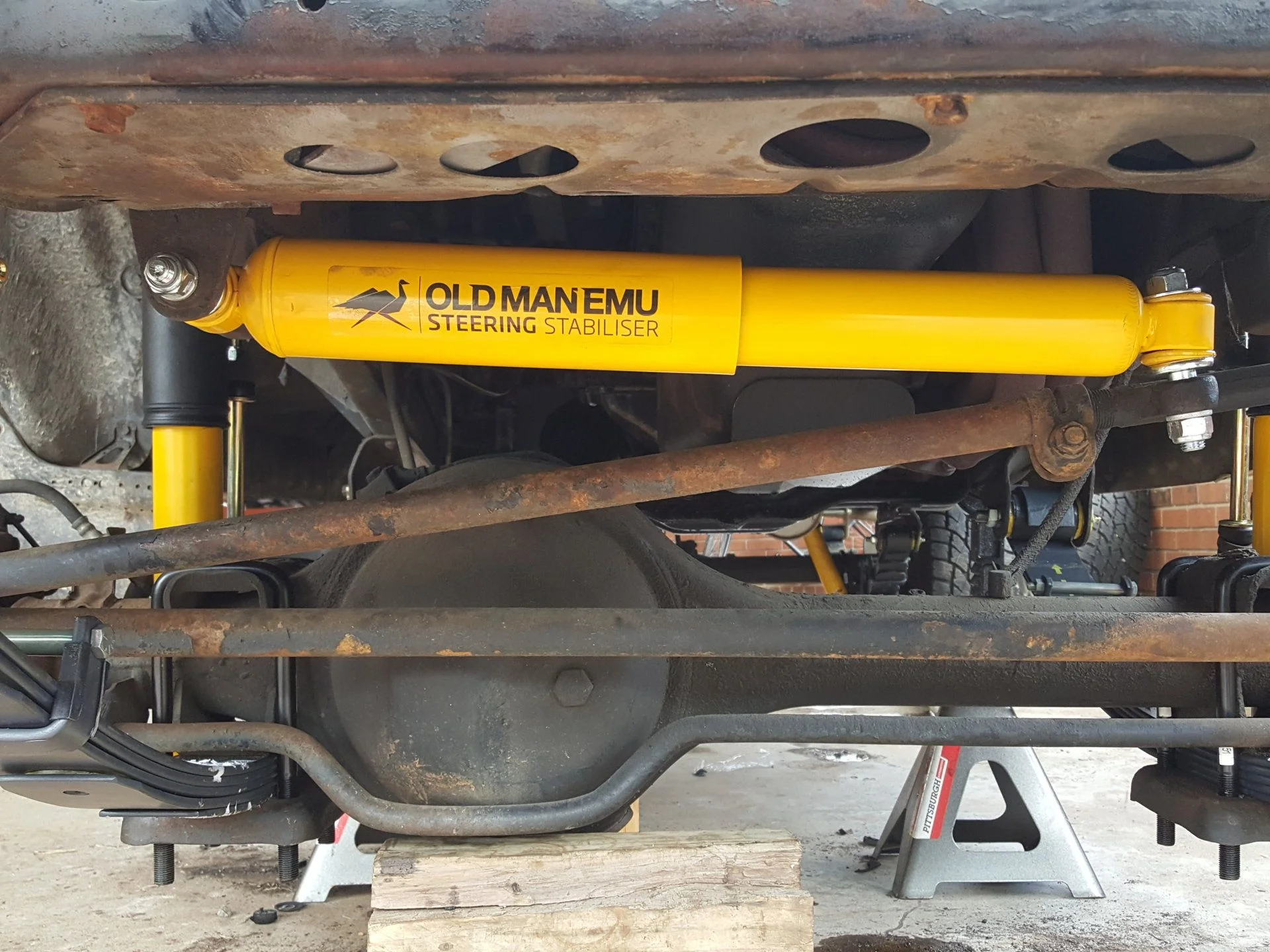

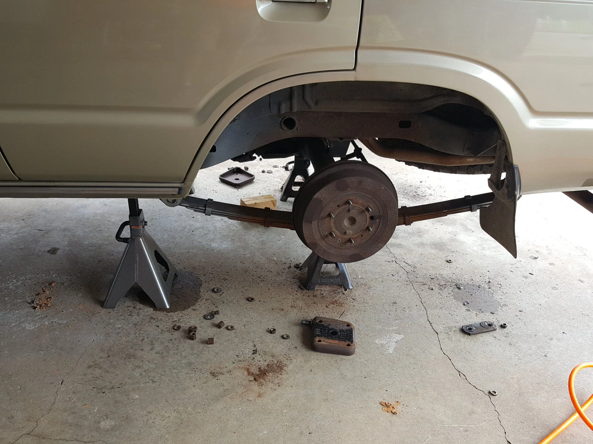

Ok, so never posted on a forum before, but after doing this project with my oldest, I wanted to share! We had a great time with the project. Cruiser Outfitters sold us the entire kit and were awesome to work with. This is an '83 FJ 60 in great shape so only the rear shackle, pins and bushings were hateful, everything else was remove and replace. After a few hours of beating and swearing on the rear bushings, I switched to heat and heavy prybar. Only way to go! Working on the truck with my son was a great experience. PB Blaster over several weeks had all the nuts ready for removal. Before and after photos first, big difference!
