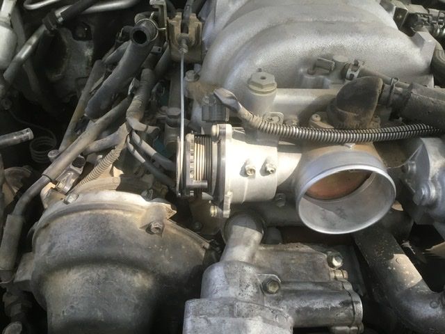

4. Cleaned the throttle body with CRC throttle body cleaner. Did not remove from engine, just held butterfly open manually with my fingers.

Today I disconnected the battery again and let the ECM reset with same results. Inspected all vacuum hoses and they all are connected and look good with no cracking. Throttle body butterfly is not tight against it’s back stop with key off (has a little movement when I push back at the bottom but not much). Compared that with the throttle body butterfly on my ‘02 LX470 and about the same. Took the MAF sensor off my LX470 and put that on the Land Cruiser, disconnected battery to reset the ECM. Same result, with initial 2,000 RPM then settling in at 1400-1600. So I think I’ve ruled the MAF sensor out as the culprit.

Does the intake butterfly close all the way at idle?
I don’t see any open space around butterfly but can push it back on the bottom slightly before its all the way closed.
If there is a little slack in the cable when closed, I'd call that normal. And if you have not had the throttle body off, then I don't know where any air leaks beyond that point would come from. Sorry, no idea.
Since you compared butterfly and both open a hair. Id say that is normal. But "about the same"! So is the same or not?
I would say a touch more open on the land cruiser than the LX. But only a small fraction.

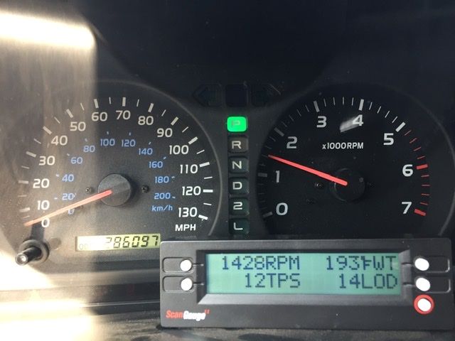

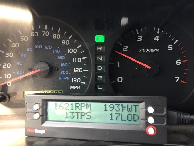

Using ScanGuage the ‘99 LandCruiser warmed up and at idle RPM is ~1,400, TPS 12, LOD is 16. Same conditions on ‘02 LX idle RPM is ~700, TPS 13, LOD 13.

Also can you read the ECT (engine coolant temp) see if your 184F to 187F or higher once at operating temp.

After warmed up temp now reading 191F.

Did all of the above. Still idling high. No change with disconnected throttle cable. AC compressor clutch stopped with AC off, spinning with AC on.
Will say that when starting, every time, idle jumps up to about 1,800 RPM, drops almost immediately to 1,400, then jumps up to 1,800 and immediately back down to 1,400 and stays there.
