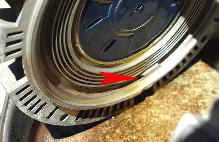

Yup. That was the one I was thinking of - you can see the o-ring in there that was damaged in taking it apart, I believe. I had remembered that the square o-ring was not an item available from Toyota, so for those times where it would be needed, I'm thinking finding the dimensions and suppliers would be something to put in the 60 forum, but wanted to pass along to CSC in general since not all of the later models use pure electric fans, and might get some use out of the data as well.
