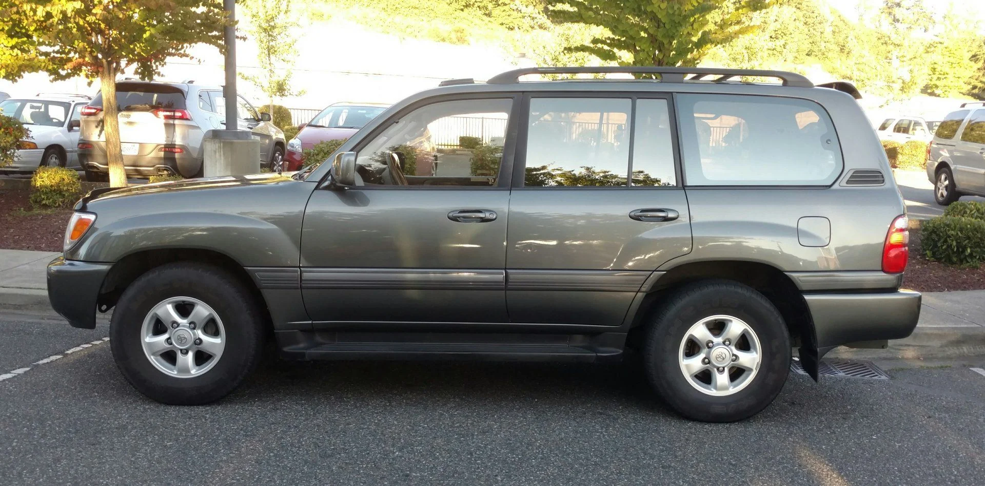

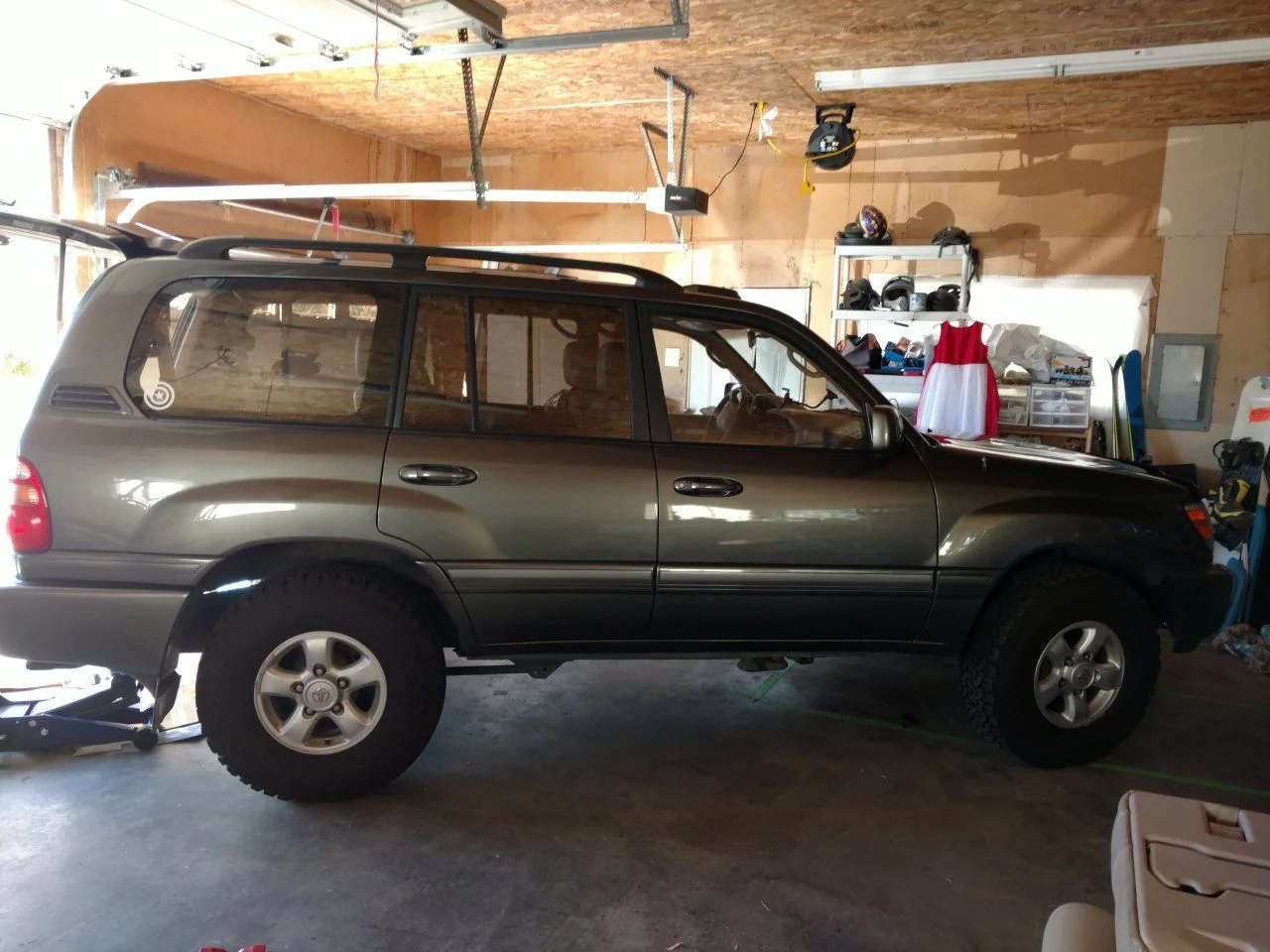

As you can tell in the above picture, I also cranked the torsion bars to even out the front and took off the running boards. The :princess: wasn't overly excited about the running boards being gone, but she accepted my reasoning that it looked so much cooler without them and used it as reasoning to start hunting for some sliders!

I'd be interested to hear how you feel about the ride of the LC since you leveled it out - after I added the Slee rear bumper I lost my ~1" of rake and the truck felt a lot more squirrely driving around. Installed some 1" spacers in the rear and now it feels nice and solid again.
@crimsonaudio, I honestly haven't noticed a difference in the ride. But it rides so much nicer than my Tacoma, I am still on cloud 9 about how nice this thing drives!
We will see how it is after I throw my lift on within the next couple of weeks.

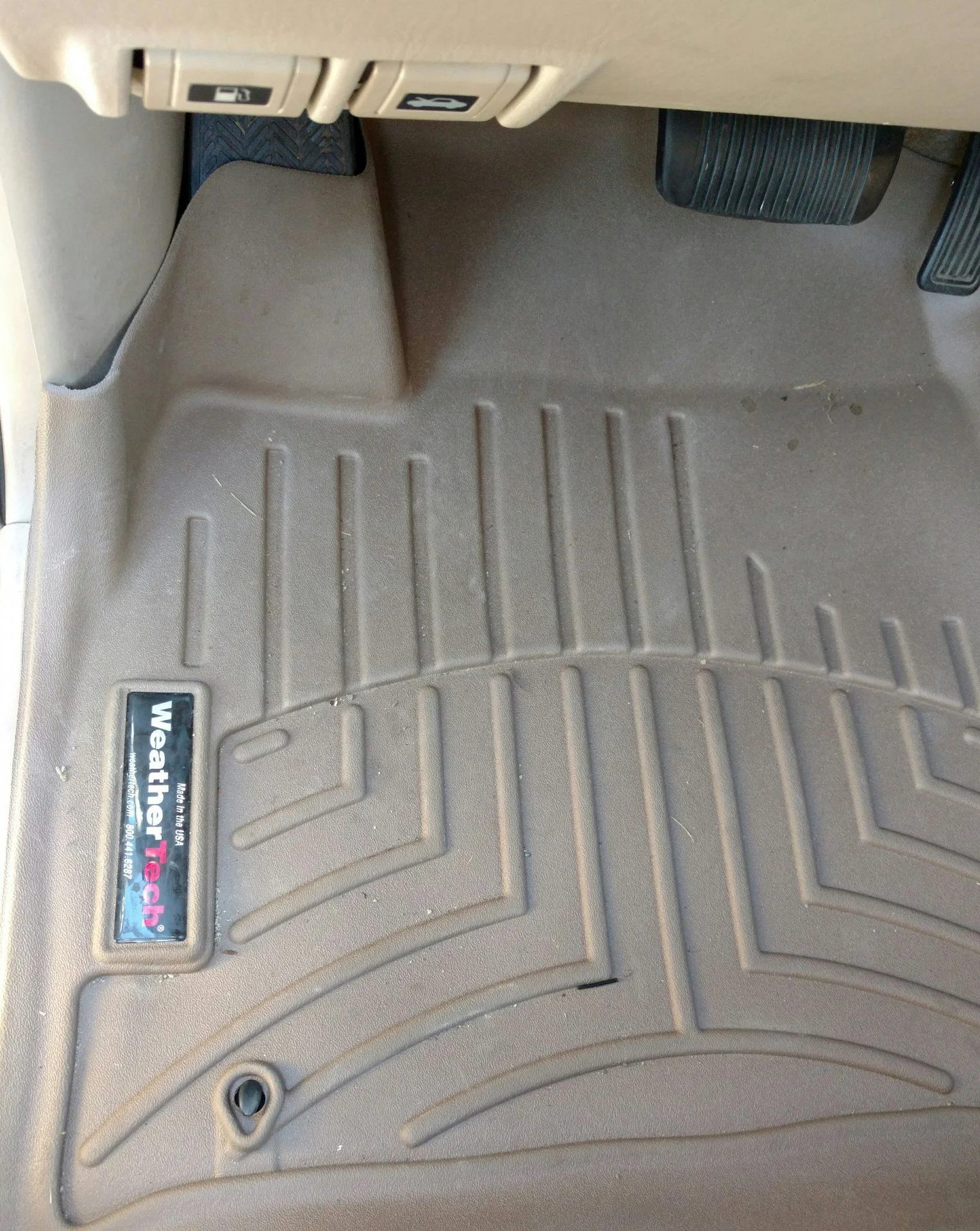

Got some Weathertech mats for the front and back seats. I was reluctant to spend that much on some floor mats, but I think I made the right decision. Gotta protect that pretty carpet from the whirlwind that is my kids!

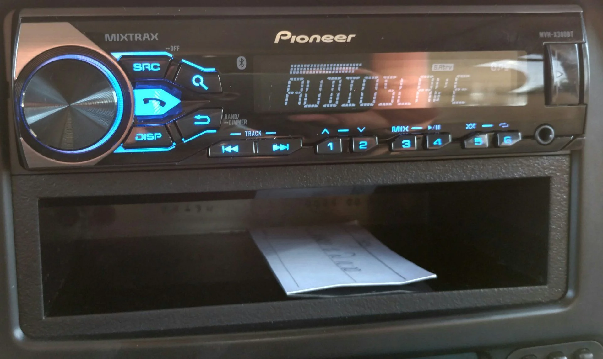

I also put a new stereo head unit in that has Bluetooth, pretty much a necessity these days. I was shopping around looking at the high tech double-din units, but wasn't really satisfied with what they offered. I figured that I could do all of that stuff through my phone or a tablet and just connect it via Bluetooth.

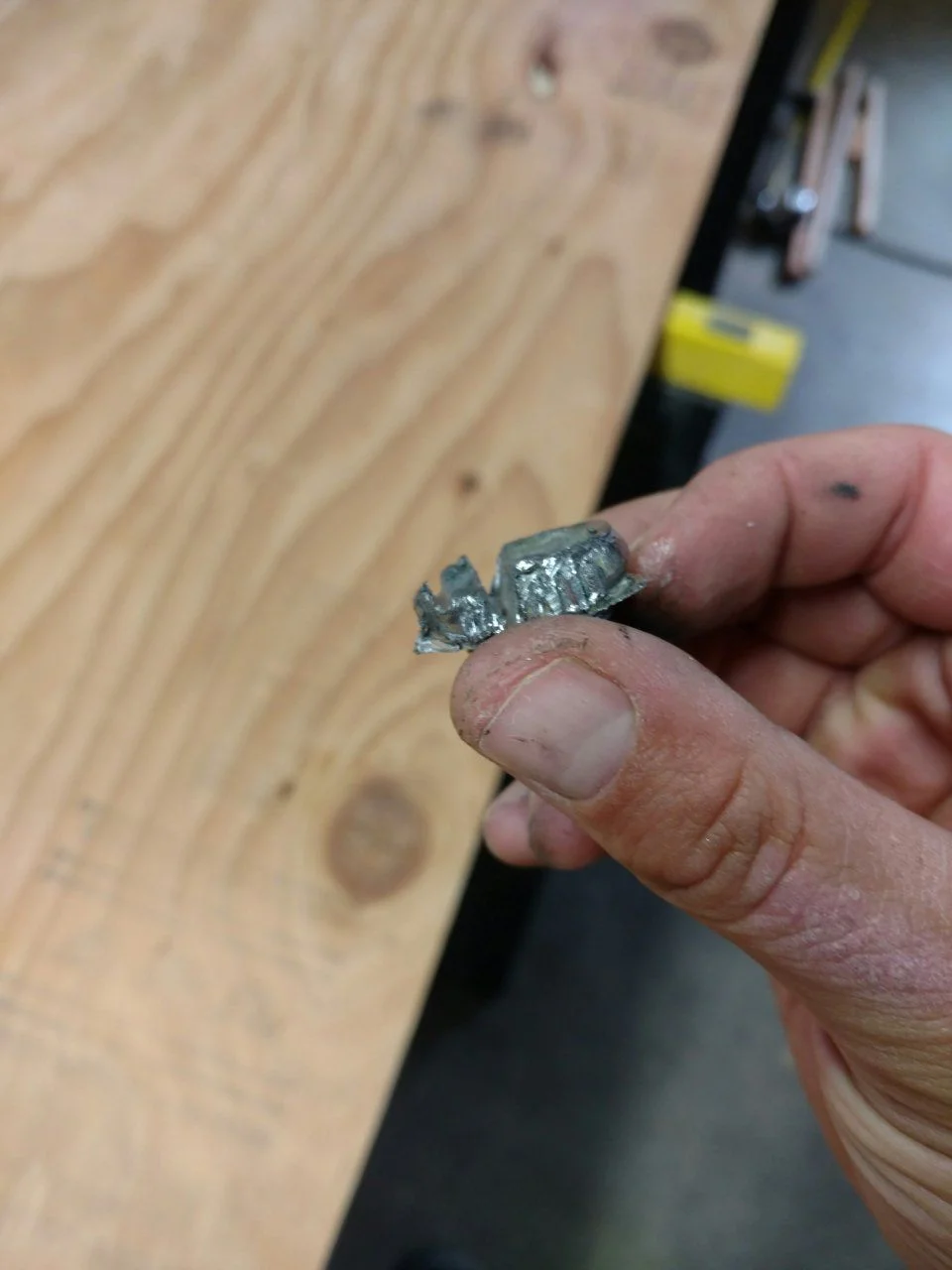

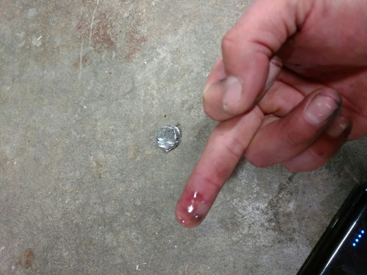

After 4 months of inactivity, I thought that I would update some progress. In the process of changing out my fluids I hit my first snag with my front differential fluid swap. The top fill plug on the differential would not come off, to the point that the bolt head started to round with a 6 point socket!
After about 5 hours of cussing up a storm, and using every Internet suggested method that I could think of, I finally got it. Ended up using a dremel to cut a slot in the head and got the biggest screwdriver I could find to break it loose.
After that, the rest of the fluids were a breeze. The only fluids I haven't done are brakes (done shortly before I purchased) and coolant (waiting until I change out the Ts).

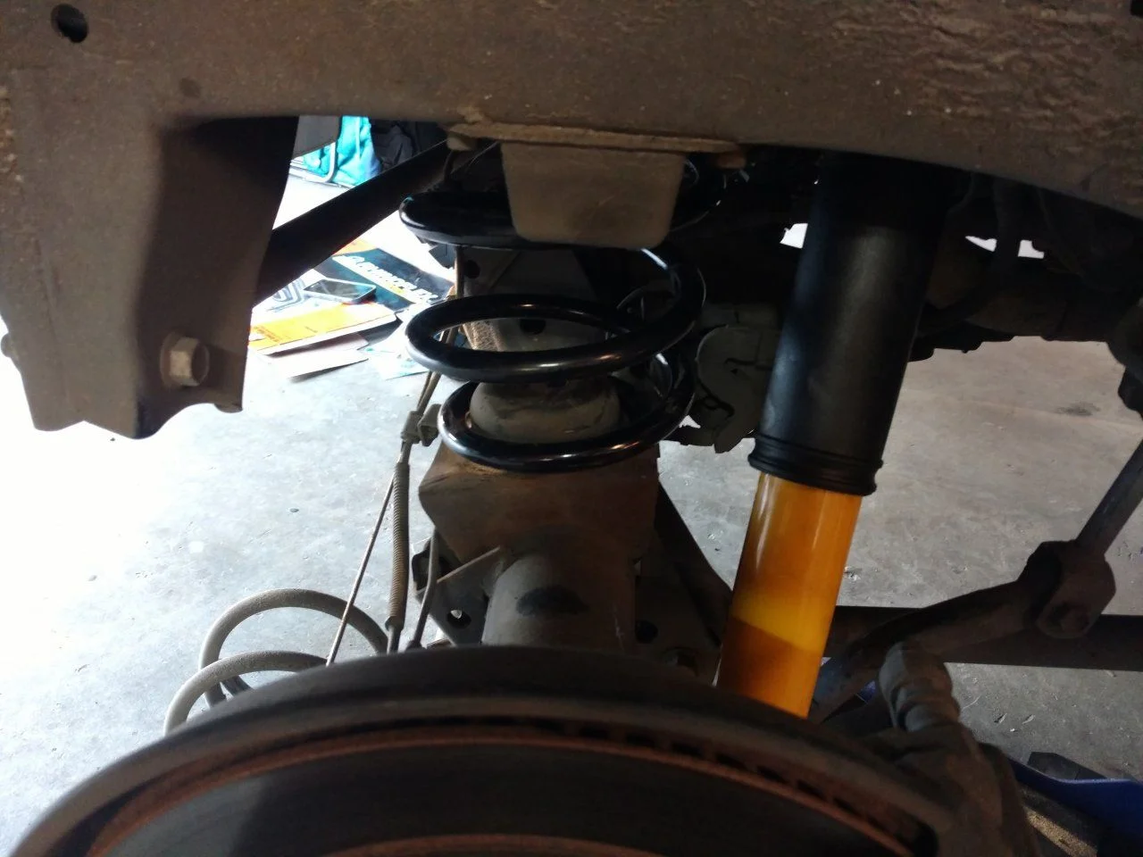

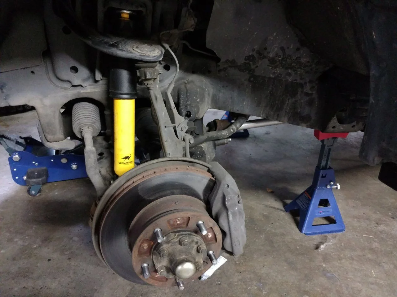

After about a month after my order, I received my OME 2.5 medium duty lift and immediately got after it. Following the Directions from Slee, and these forums it went off without a hitch.
I started with the rear and after looking at my upper shock bolt and wondering how in the heck I was supposed to get that off, I went to the forums and stumbled across this:
10 Minute Rear Shock Install
If you are not opposed to cutting a couple of holes in your floor, I highly recommend this method. It saved me hours of cussing and banging up my knuckles. You can also get a torque wrench in there and tighten the nut to spec with this method.

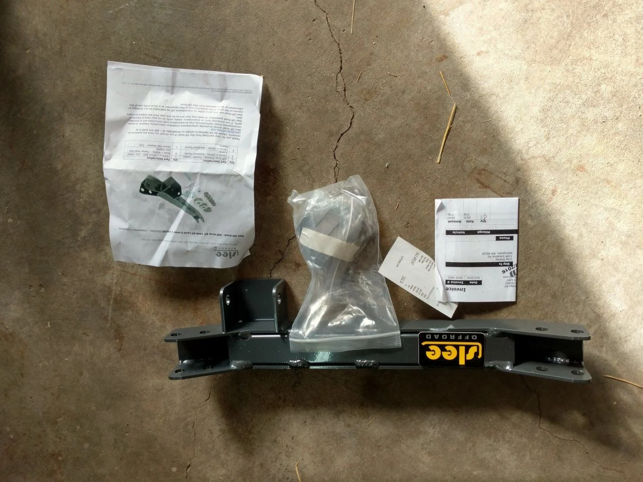

The front went really smooth as well, first I installed the Slee diff drop kit, and then shocks and T bars. Using Slee's instructions for indexing the Torsion Bars worked great and after just a few adjustments I was good to go!
