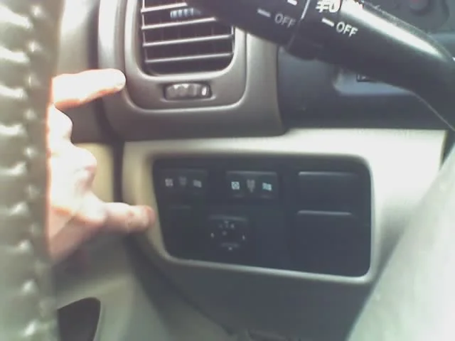

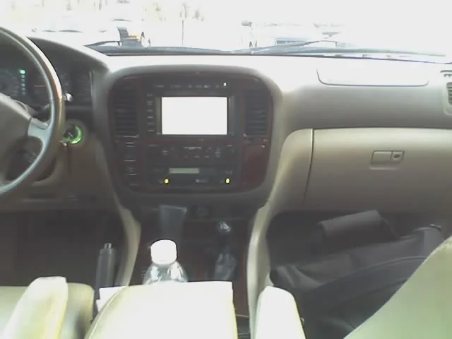

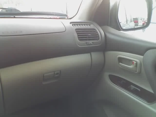

Here's the pics after I removed the trim pieces. We'll see if any of you have a good enough eye to figure out which piece is missing on my dash. I have it, I just haven't put it back on yet. :D Unfortunately I don't have a pic of how it looked before I removed the trim. :mad:

You have exactly what I ended up with then. I agree, it did look a little tacky for my taste.

Thanks Greg B for the pictures. I wasn't sure what it would look like if I removed and left the trim off. Had visions of a sticky mess, but that doesn't seem to be an issue.

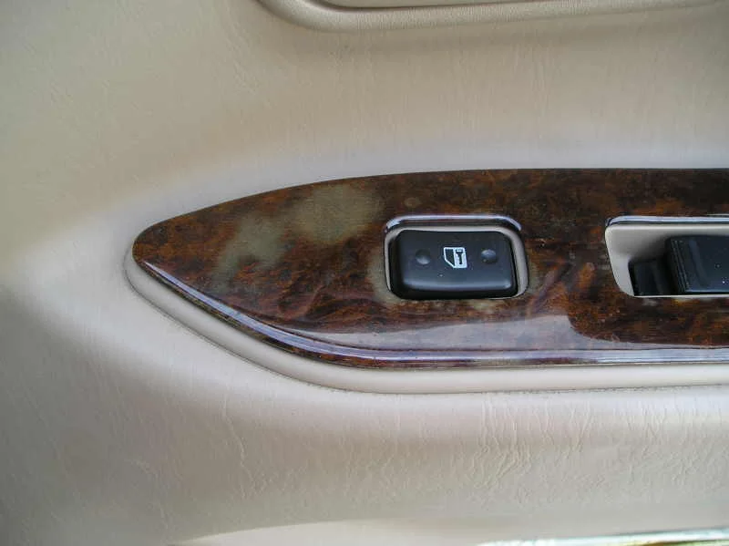

For the picture police:D and those of you who haven't experienced the dreaded "fake wood trim" gold spots here is a picture.
Also, if I replace the bad pieces has anyone got a source that is reasonably priced?
