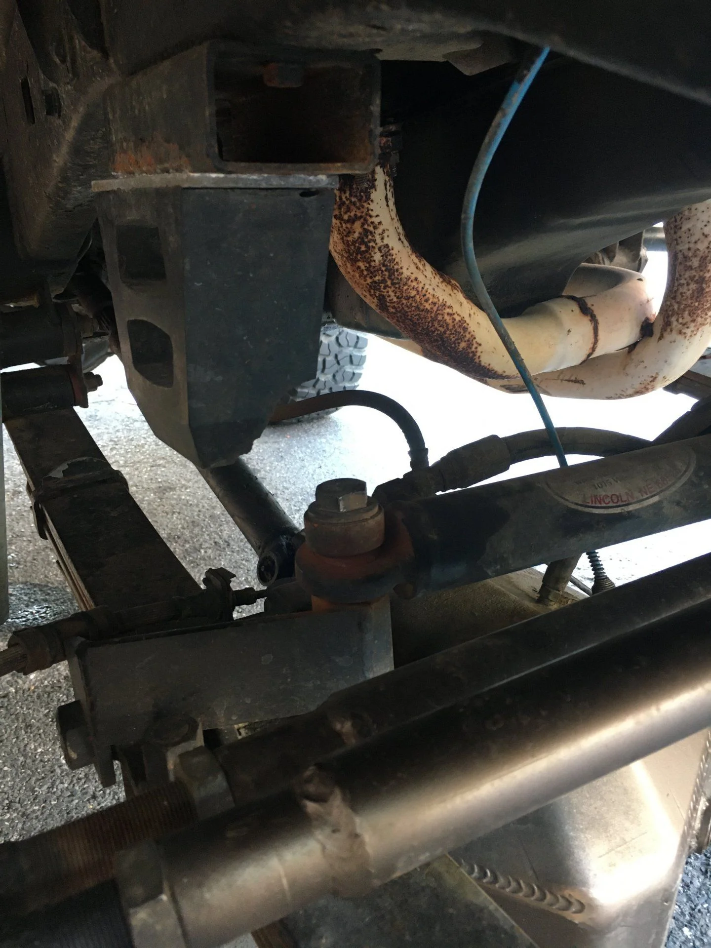

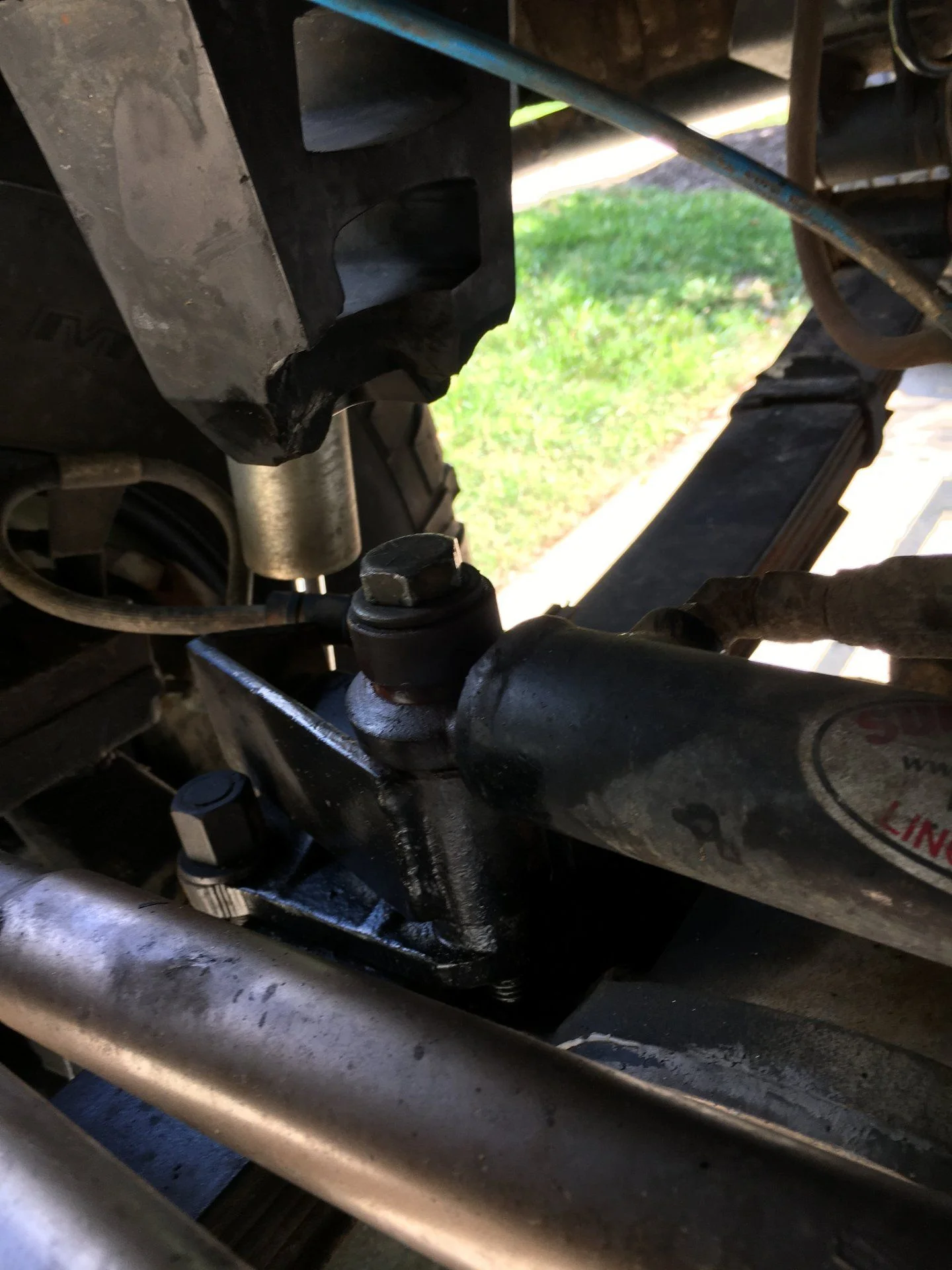

So I have a bit of wander in my steering and some death wobble on the highway. I thought it might have just been unbalanced 40s but then I noticed a little thump In my steering when idling and a metallic clang noise over bumps.
I put the 5 year old in the drivers seat to wiggle the steering wheel around and found that the Heim joint has a bit of play and is where the clunk is coming from. I think I know the answer, but is replacing the ram the only solution? It’s not expensive to replace but figured I would ask before I attempt to order a replacement.
