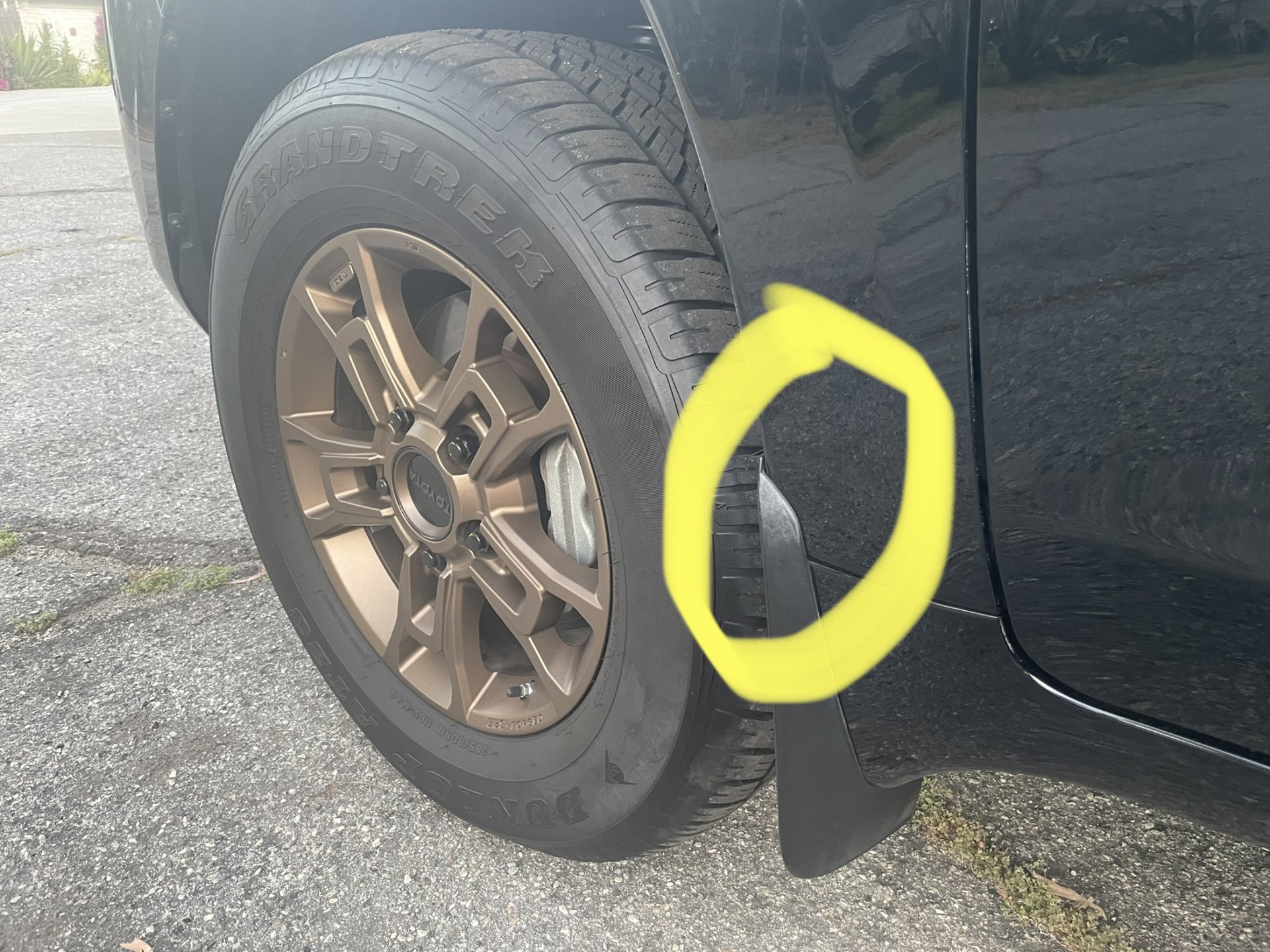

Not the vehicle paint, but on the wheel well and windshield wiper dash (not sure what to call these). See pictures below. Any idea what may be causing this / how to best fix it? 2022 HE with 15k miles so a little disappointed to see this fading so quickly.
What’s the best way to repaint / spray / touch this up?
Those parts aren't painted, they are bare black plastic (at least on every 200 I've seen).
Being that new, you could probably take it back to the dealer.
I wouldn't paint it.
They have products to revive trim, like Back to Black and Trim Restorer that are made for this.
Don't use WD40, it works initially, but quickly becomes a dust covered mess.
If it were older, I'd suggest the old propane torch trick. It works really well to revitalize faded plastics.
I think that part name is something like windshield cowl.
303 protectant does a great job. Just get it on the plastic only and don't get it on your skin.
Cerakote —get this and don’t look back. It’s a more permanent solution that adding some protectant every few weeks. In objective tests, cerakote last a very , very long time and is very easy to apply. I used this on my 08, and all the black trim looks brand new and has for months.

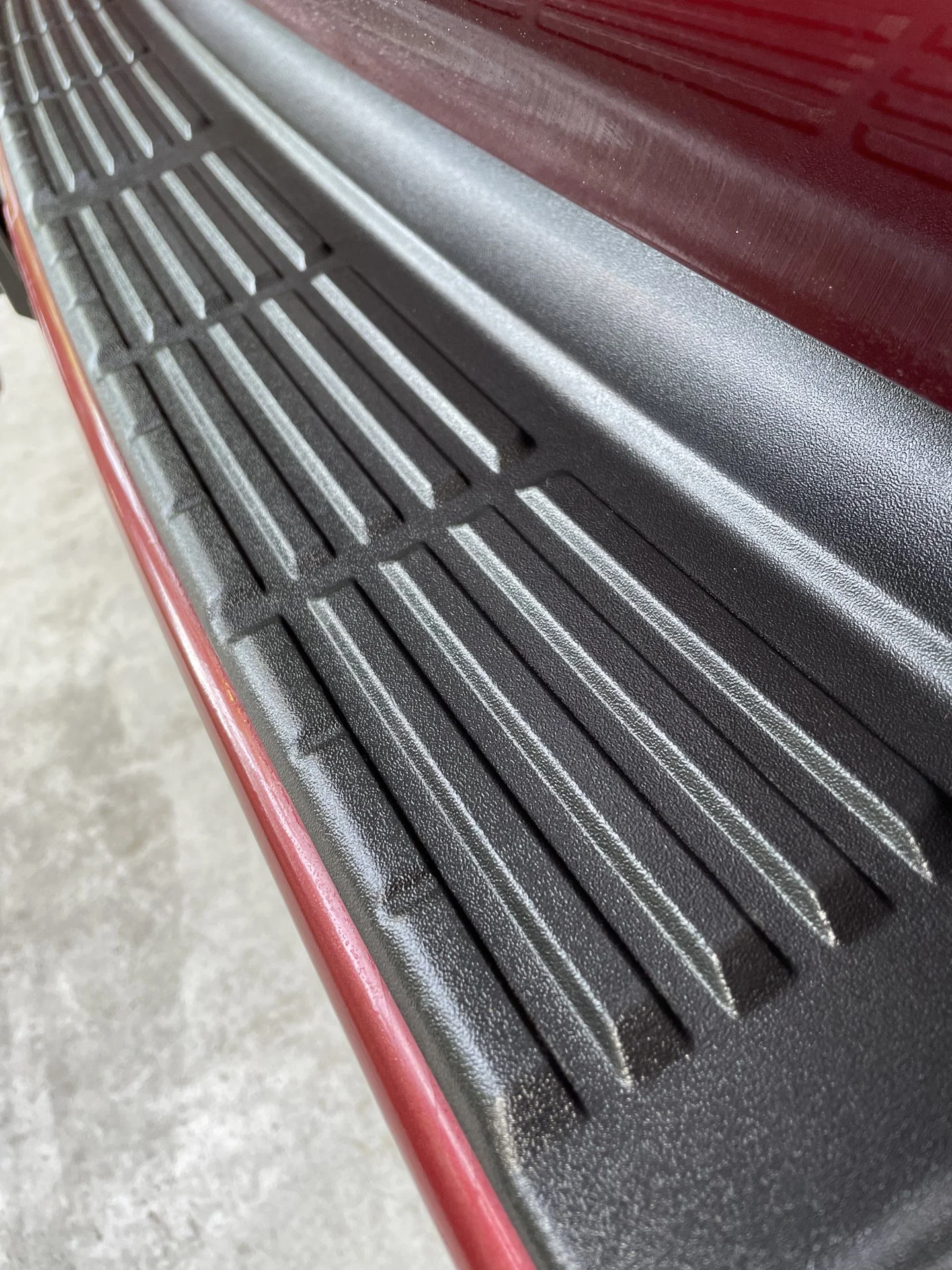

Here’s my 160k mile 08. This trim was gray and sun baked.
