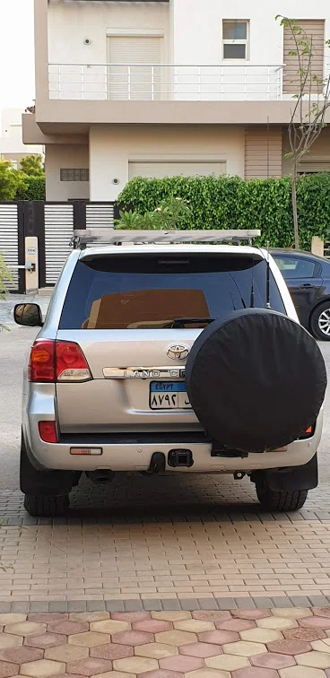

Factory Swing Spare Tire Carrier
It does show out of stock, and shipping will be a lot. you can always look to source it for UAE, never hurts to ask. Verify the part number with your model/vin before you order.
I checked and shipping to the US is $371. I could get it there and then ship it here but that would add up to the same price as getting it here. Oh, man!!

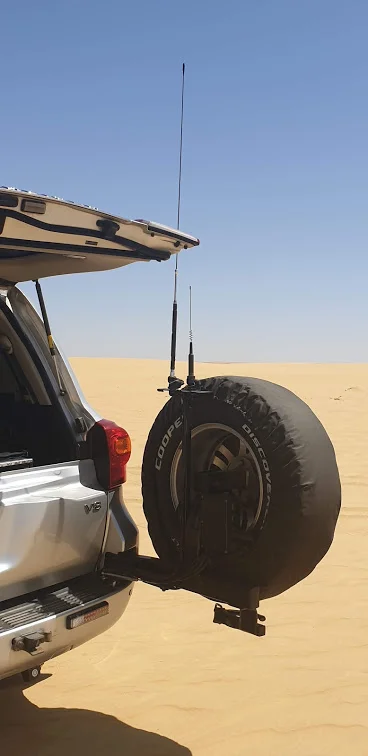

Not to hijack the OP’s thread, but for those intrigued by the spare mounting solution Kaymar offers an aftermarket swing out that I THINK can be fitted to a US 200.
Man, those are really nice. I wish we had access to all the goodies in Australia.

I'm going to take it off and take it to a shop here. Guys here are very resourceful but it could also be that once it's taken apart and it cannot be fixed that I will have to purchase the new one. I'll let you all know what I end up doing.
I looked up the part on carmarka.com but the shipping is what makes it not worth buying it from there.
Thank you all for all the help and suggestions.
