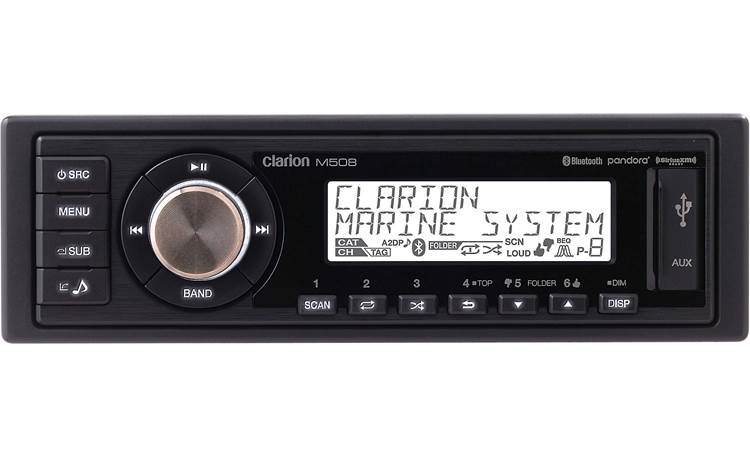

Decided to get this radio. Have it in an older Jeep it I love the look and weather band function. Unfortunately they do not make it with a CD player any more.
This marine radio is also a good option for a simple look.
Seems that all you need is the Toyota radio harness, and this plastic cubby hole to fill the gap.
