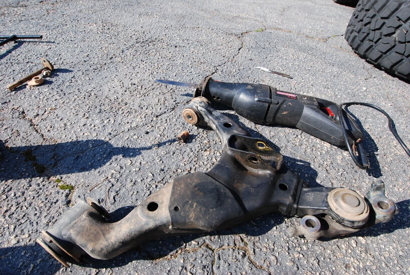

Swapped out lower A-arms on Dig-Dug. I've gone this route once before and it's by far the easiest way. Changing just the bushings and the ball joint is a pain-ina-butt. Back in 2011 I tried swapping out just the bushings and they didn't want to budge and we used a torch to heat up the arm to extract them. The camber/toe alignment bolts had seized and I had to cut one of them out.

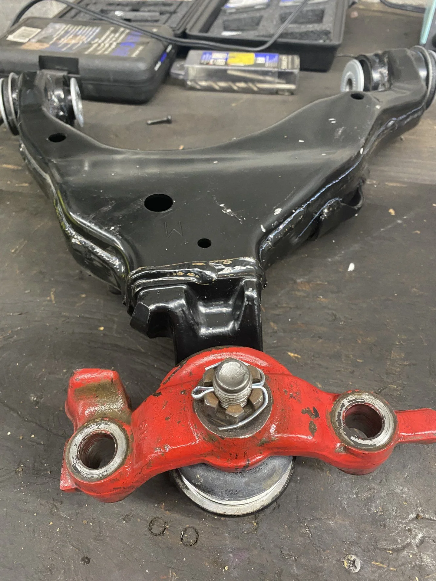

Flash forward to the best way to do this. Just buy the whole A-arm from Mr. Toyota. It comes with fresh new bushings and ball joint already assembled. In fact, you can't even buy a factory lower ball joint from Mr. Toyota, you have to go MOOG or Pro-Forged. Add up the cost of OEM bushings ($150/side msrp) and ball joint ($25ea, RockAuto) and factor in the time to press out 4 bushings and 2 ball joints and then press in 4 bushings and 2 ball joints on an awkwardly shaped hunk of steel. . . it makes sense.

Remove the two 19mm bolts from the bottom of your spindle (ball joint attachment bracket). Swing the whole spindle assembly out of the way and use a bungee or cargo strap to hold there.

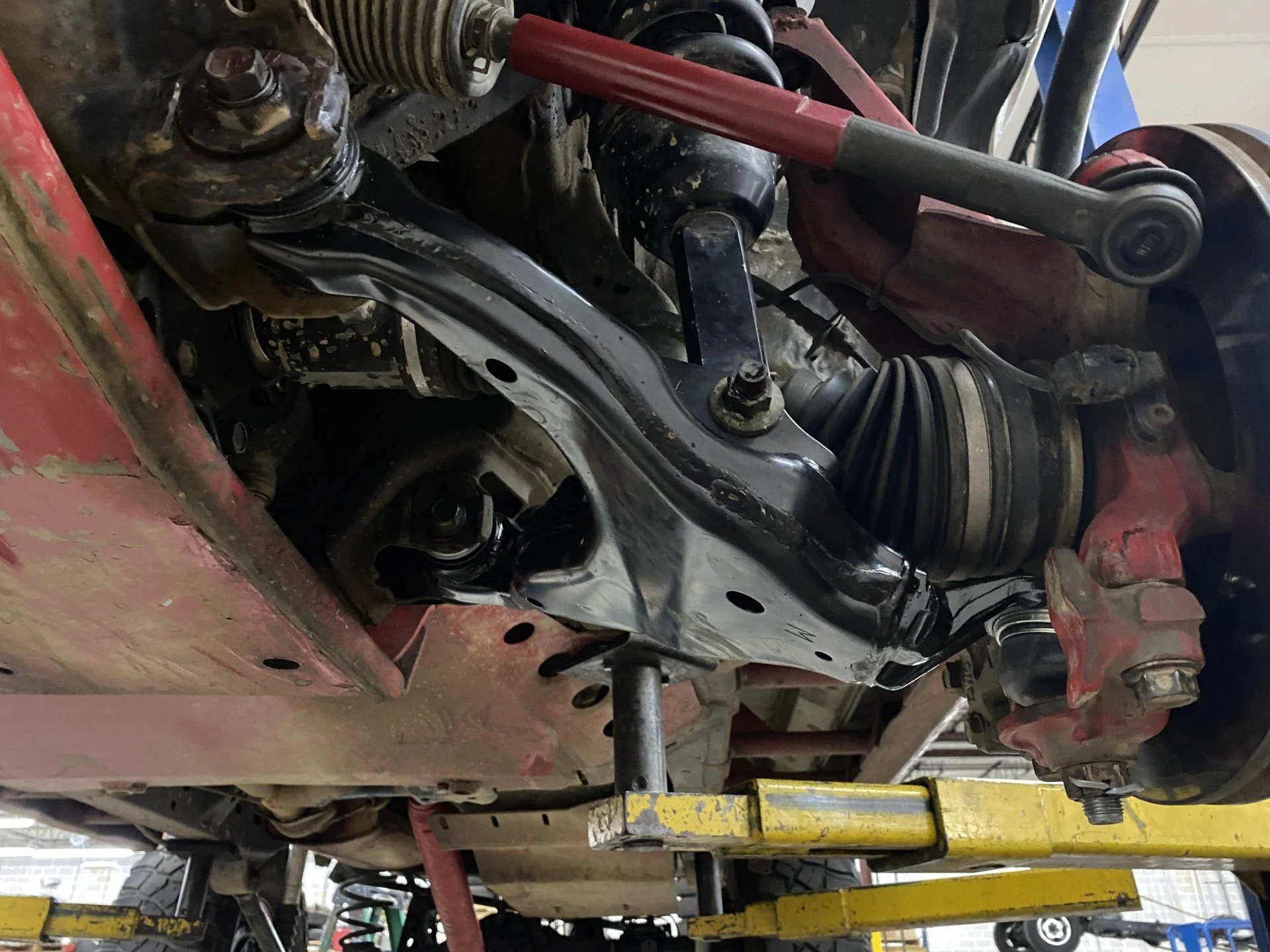

Disconnect the coilover from the lower A-arm by removing the 19mm bolt & nut.
Remove the 19mm nuts holding the two camber/toe adjustment assemblies from the frame mounts. Slide the toe adjustment sleeve out of the bracket and bushing. You may need to use a brass drift to accomplish this.
Use a sledge to bang the A-arm free from the frame brackets. Add to the scrap heap for recycling.

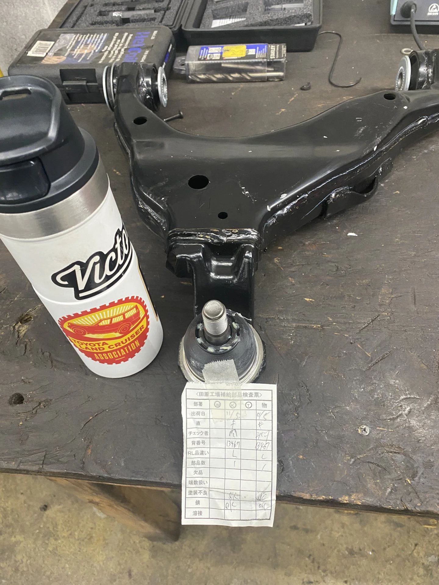

New part pron.

Reattach this bracket. Use new cotter pin.
Torque all your nuts and use a crescent wrench to hold your camber/toe alignment cams in place while you torque the 19mm nuts down.

I wanted to get factory LCA when I rebuilt my front end this past Summer. But had blown most of my budget on tires. I got a pair from A1 Auto on Ebay. I know they're Chinese made. They fit with no issues and I have had no issues 6 months later. I don't 4 wheel hard anymore so I'm happy to save a few bucks. I have my old original ones that I can rebuild later if I need to.
