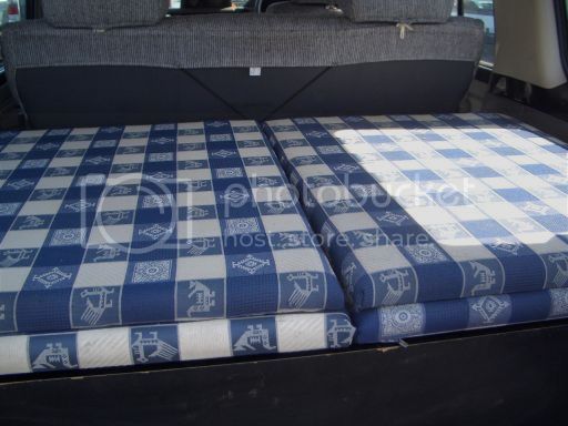

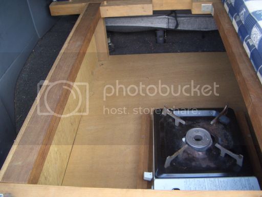

Mine arrived like this:
It has a wooden box in the back, and when the rear seats are folded down the two "bed" parts slip over and lock in making a reasonable sized bed from someone 5'5 or shorter.
Anyone know where to get replacement propane for those stoves?
Are you sure it isn't a butane stove? If it is propane, you should be able to go to any gas stove fireplace shop and they will be ableto est you up with a hose and regulator for a 20lb or 40 lb tank.
The setup Rob pictured above is the standard Bedcruiser kit (you can even seen the logo on the counter top). I have the identical setup in my truck. As far as I know the kit comes with: a bed in 4 pieces (2 long boards that rest horizontal on a frame in the rear and 2 pieces that sit on the tops of the rear seats), a 2300kcal stove in an aluminum housing, dual plastic water tanks in an aluminum housing, a counter top with small sink, a manual hand pump faucet that suctions water from a water tank into the sink, a drain hose that routes waste water from the sink into the second water tank, and a drain plug.
