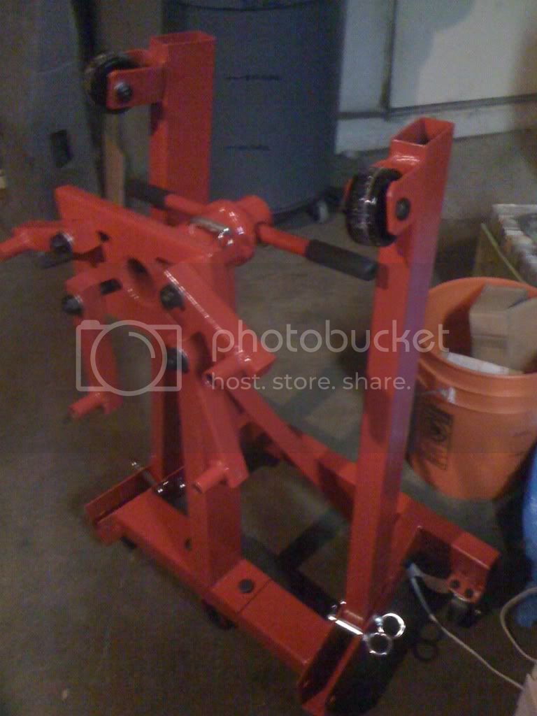

Yay I picked up a 2000 lbs engine stand from harbor freight that has long foldable legs. It's a litttle overkill but it looks real sturdy and I will be able to move it around if I need.

Ahh, I love overkiill.

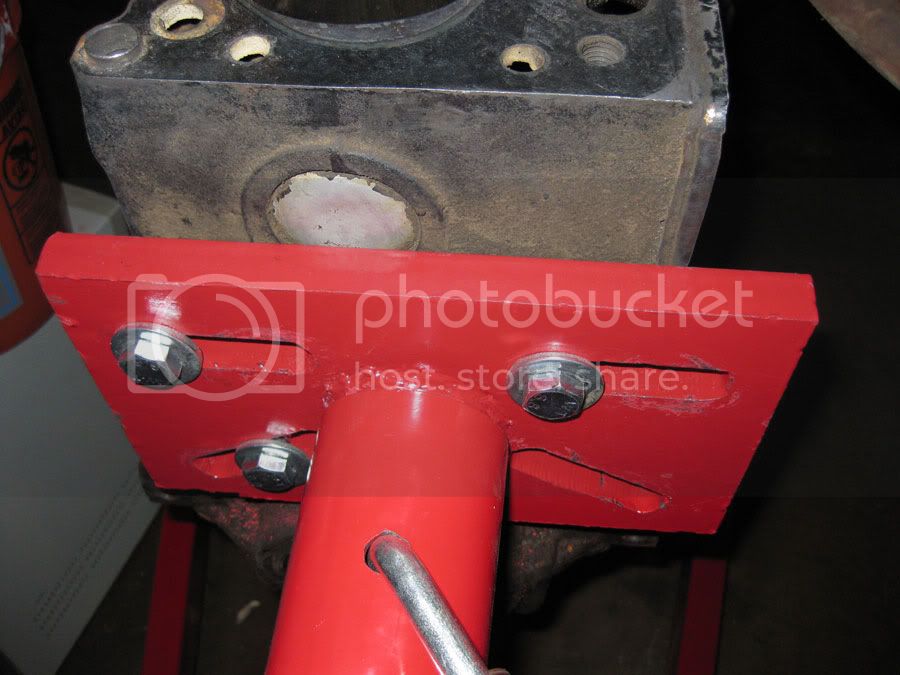

Well, I couldn't get the engine stand arms to fit at all. So I removed the arms and bolted the engine directly to the stand. Only three bolts lined up. So am I crazy doing this or was I supposed fab something to get the arms to fit??
:confused:
:confused:
That looks f'ing scary to me. But I'm a wimp. Plus I still have all my fingers & toes and wanna keep them.
Here's the few pics that were easy to find on the harddrive of engine block mounted to the plate. Use the 2 of the arms normally, and flip 2 of the arms around to act as spacers only.
