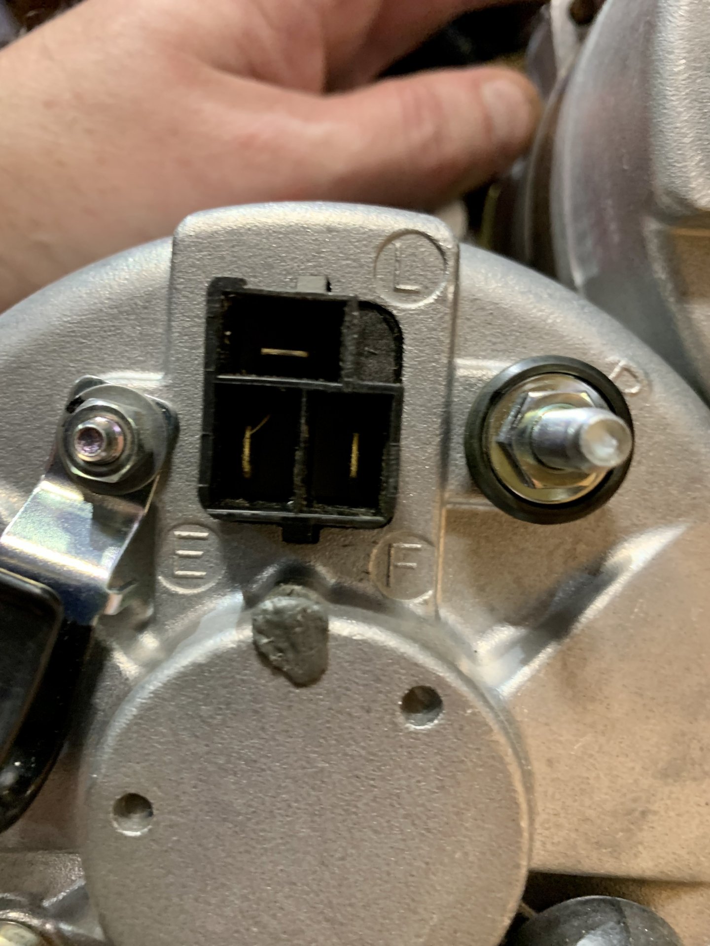

can anyone help me understand the :
- Explaining the Differences in the EARLY FEN 3 wire Alternator plug out EWD and Later LEF
- what's a IC Regulator type ?
- all early Toyota's use the FEN until say 1980's early then Mini truck , 22R 22RE and Cressida and corolla and so on move to the LEF off set brown plug out ?
- thanks for any input
- @pappy please chime in , thanks sir .......... :)
matt
The later LEF units use this Voltage Regulator 27700-38110 / 27700-38113 now disc. ? / NLA
What is your actual question?
The difference is the voltage regulator is internal to the alt, not separate on the firewall and no stupid extra "charge" relays.
if that's the case ?
then what's a 27700-38010 / 27700-38113 and how does it relate to the LEF brown offset plug unit above ?
- what does IC regulator stand for the IC part , i refer to
- this is my ACTUAL questions .......
thanks
this is a remote voltage regulator mount and directoy relates to the LEF unit above ?
so the internal regulator topic tech you refer to does not make sence ?
or did i mis understand ?

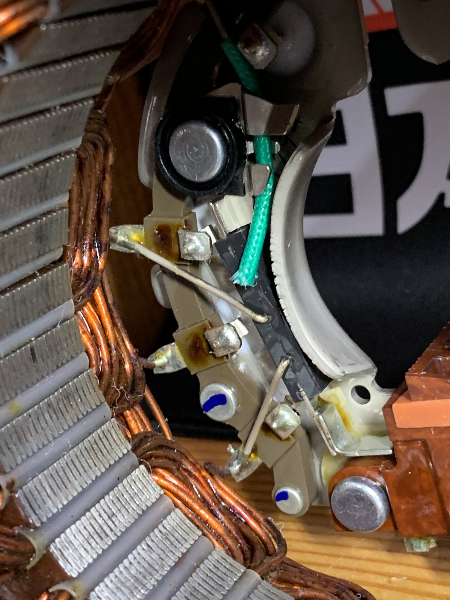

Sorry misread.
IC stands for "internally controlled"
The regulator is using a zener diode to turn on/off vs a mechanism.
This article is pretty interesting.
so i can basically conclude the IC Regulator is a primitive FORM of a " Digital type ON OFF Voltage Regulator " ??
vs
old land cruiser one is mechanical with bi-metallic moving parts springs ?

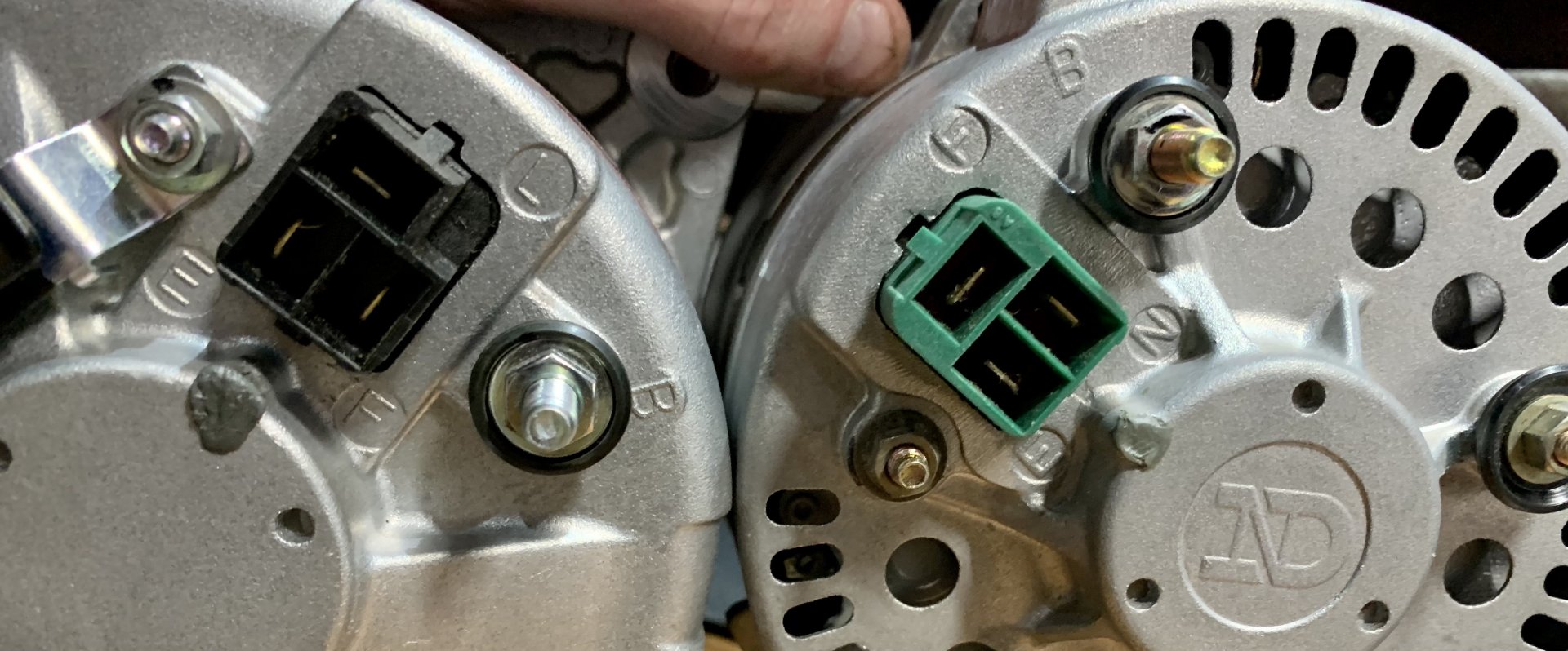

im trying to solve to big problems :
- GET the IC regulator crowd a OEM parts solution for the 27700-38113 thats now NLA ?
and
- try to utilize or MOD the LEF offset brown plug units to work in concert with a FEN land cruiser system ?
- i have takin on some big ideas but you folks GOT ROLALLY SCREWED BY TOYOTA on the NLA voltage IC regulator deal ?
notta any viable solutions
well if i CAN it WILL happen ..........
stay tuned for more updates
please reply back any ideas or thoughts please
when Mr T screws US we MUST Re-Produce or Re-Apply applications of other OEM toyota genuine parts
its what i do ands what im good at , and well i like helping people get to work and school etc...........
i just scooped up a 100 pcs of the Brown harness side LEF input connector plugs , so its going to happed in one way shape or form
thanks matt :)

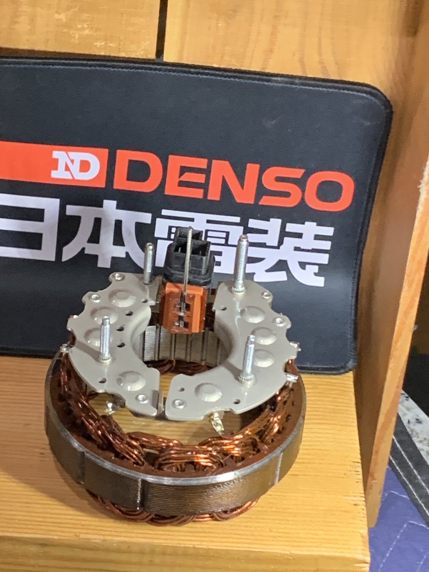

i would like to revisit this tech topic here ,
dive deeper ,
the IC regulator verses a non-IC regulator ?
remotely mounted
the WHY is below , i have a pallet of them , i have seen these converted to a FEN type regulator set up ?
the IC regulator oem toyota is NLA 27700-38110 , 38111 38113 NO japan parts solution exists

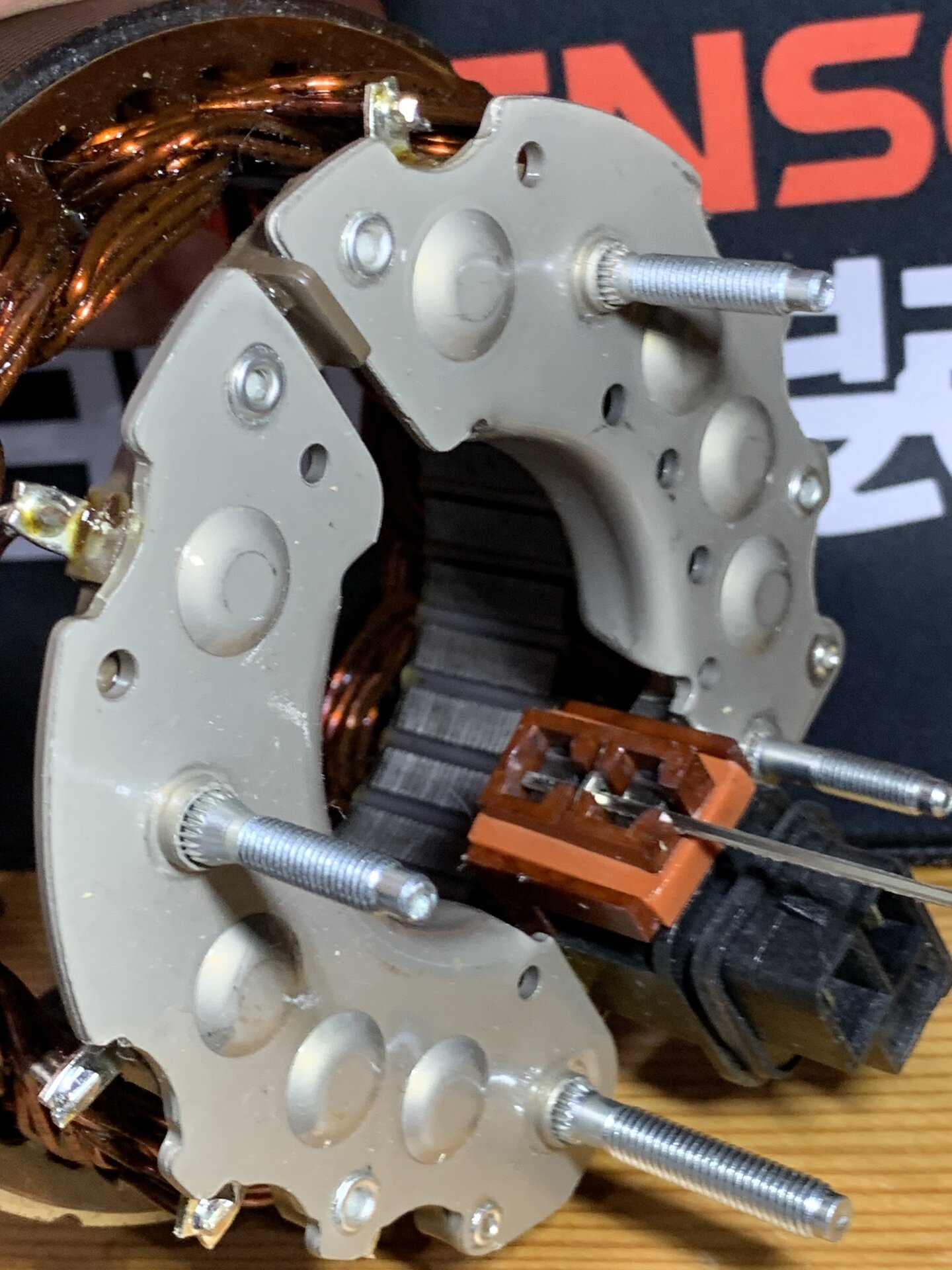

These 1 piece Genuine NipponDenso reciter board , stator , brush holder combos are 100% new made in japan parts ,,,
the FEN 3wire and FEN 6 wire w/ charge lamps will never go away
