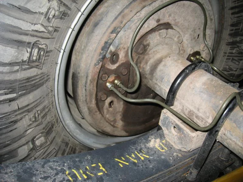

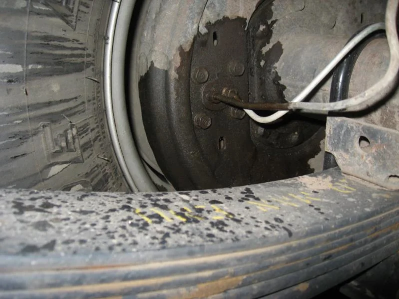

The rear master brake reservoir was low so I took a look and found a small damp area.
I cinched up the fitting and topped off the reservoir and ran some errands.
When I stopped and checked the reservoir it was low again... another look underneath...
Wheel cylinders are not that hard to replace. But, sounds like a great excuse to go disk. Much simpler. With the splatter on the spring I'm wondering if the line isn't cracked.

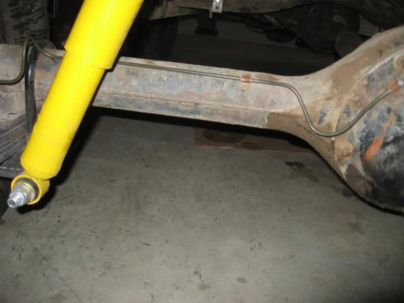

I took the line off this morning… the drum end of the line was blown out and the other end was cracked through.
Went to NAPA for a replacement… they have prefabbed lines with fittings and flares in various lengths. I bought a 20” for the loop and a 51” one for the main line… www.napaonline.com/Catalog/CatalogItemDetail.aspx?A=BK_8135488_0282384016&An=0
Formed each line to match the route… very simple!

Why are there so many fluid lines? 2 Wheel cylinders on each wheel and a line between the two to attempt to balance the pressure? That reminds me of the way old air wedge brakes with double actuators work. More effective braking because you are getting 2 leading shoes per wheel but they require more PM to keep them working right.
Correct, but t may be a little deceiving... the plastic bleeder tube is shown attached on the far right and going out of view.
Bled the air out of the lines and drove it around the block... all is good! :)
