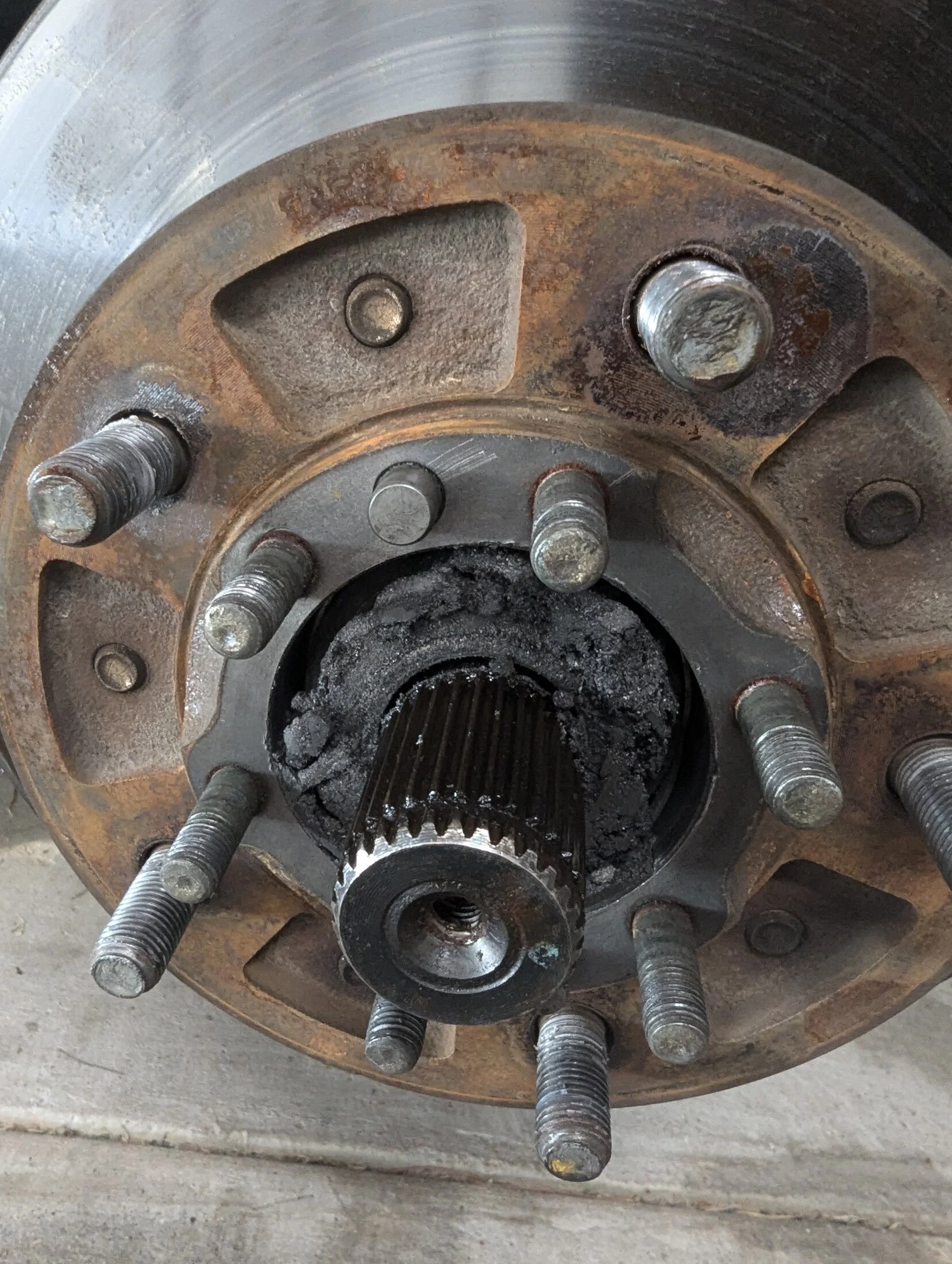

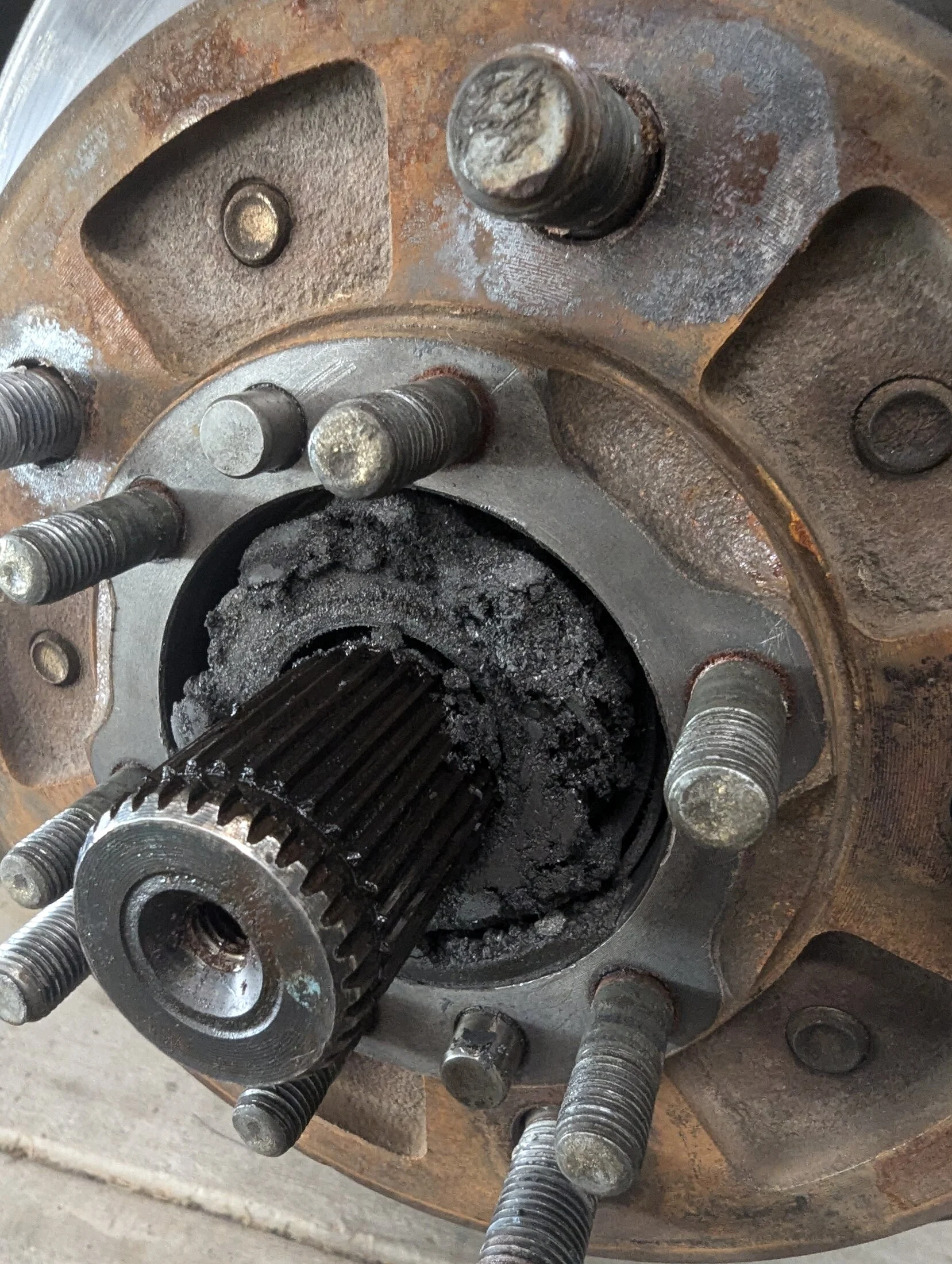

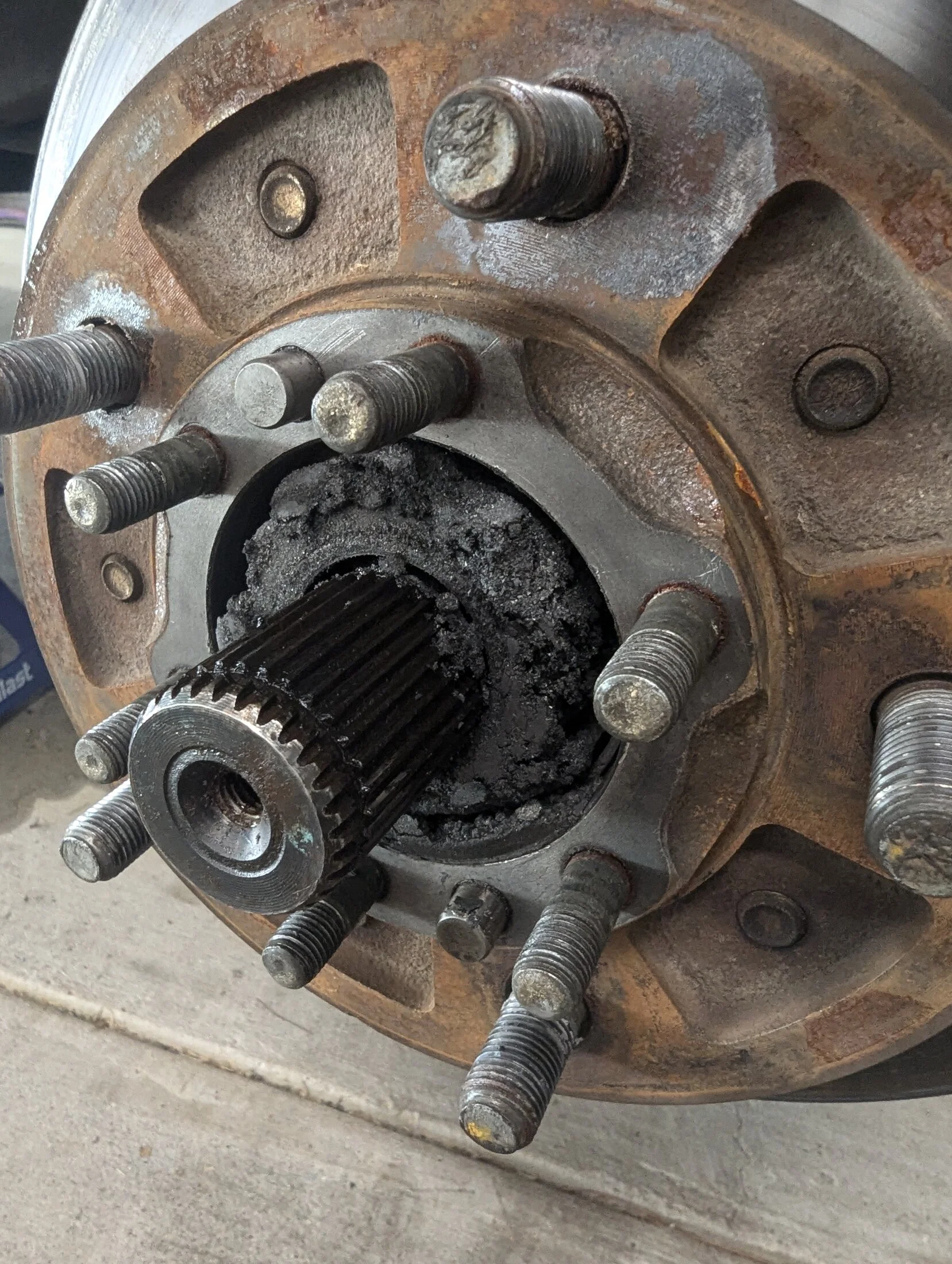

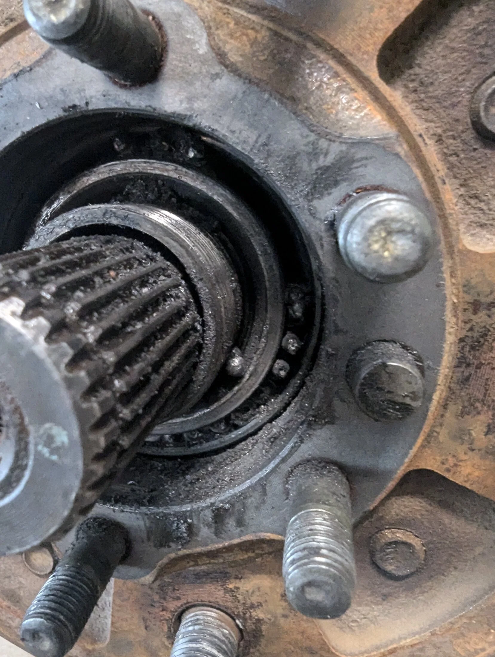

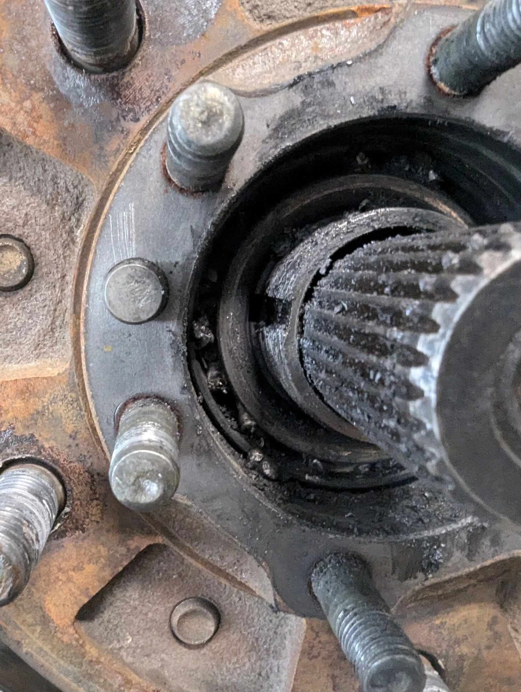

Story: I was driving to work today on the interstate around 75mph. Symptoms? Maybe a sensation that I thought was my calipers/brakepads kind of sticking when I'd go from a stop for the last couple of months (I just ignored this honestly) but no noise or anything else to suggest I had a bearing issue. Well on my drive, all of a sudden the truck pulled really hard to the passenger side, so I pulled over onto the shoulder. I got out, looked around, didn't see anything out of sorts but knew something was very wrong, also had a noise/squeal with it. I decided to turn around and head back home, probably about 5 miles or so. I made it all the way home, taking lesser roads/highways to keep top speed down. I pulled off the front passenger wheel and first smelled it, then saw it. I beat on the rotor for about 20m with my largest persuader, it's not coming off, that outer bearing is basically welded on now. To ebay I go to find a salvage knuckle and hub, and cruiserTeq for bearing rebuild parts. My wife started sending me ads for used 200 series.....

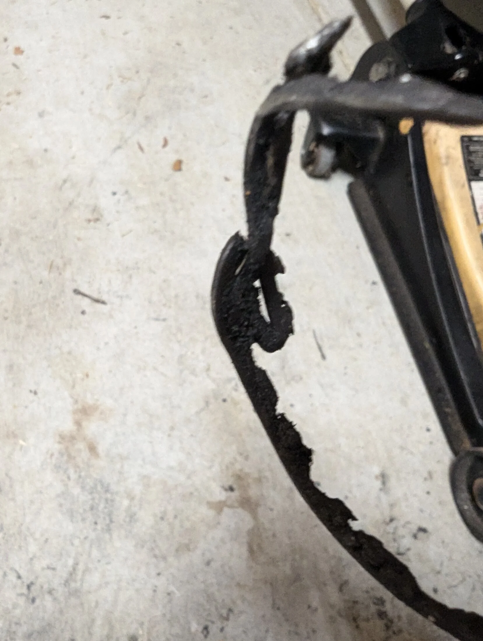

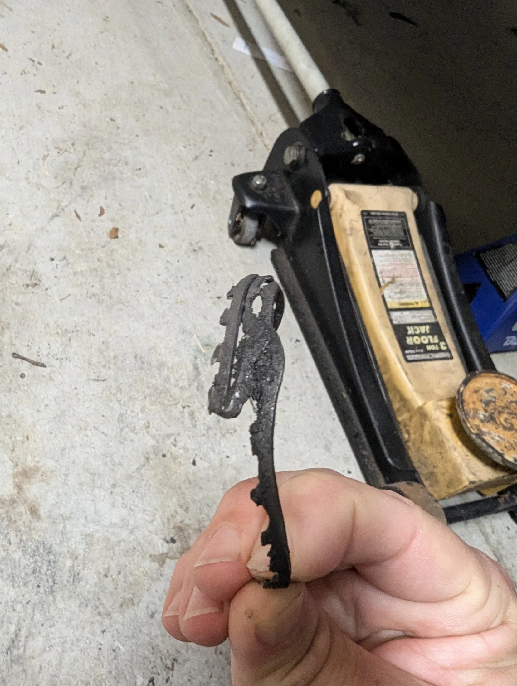

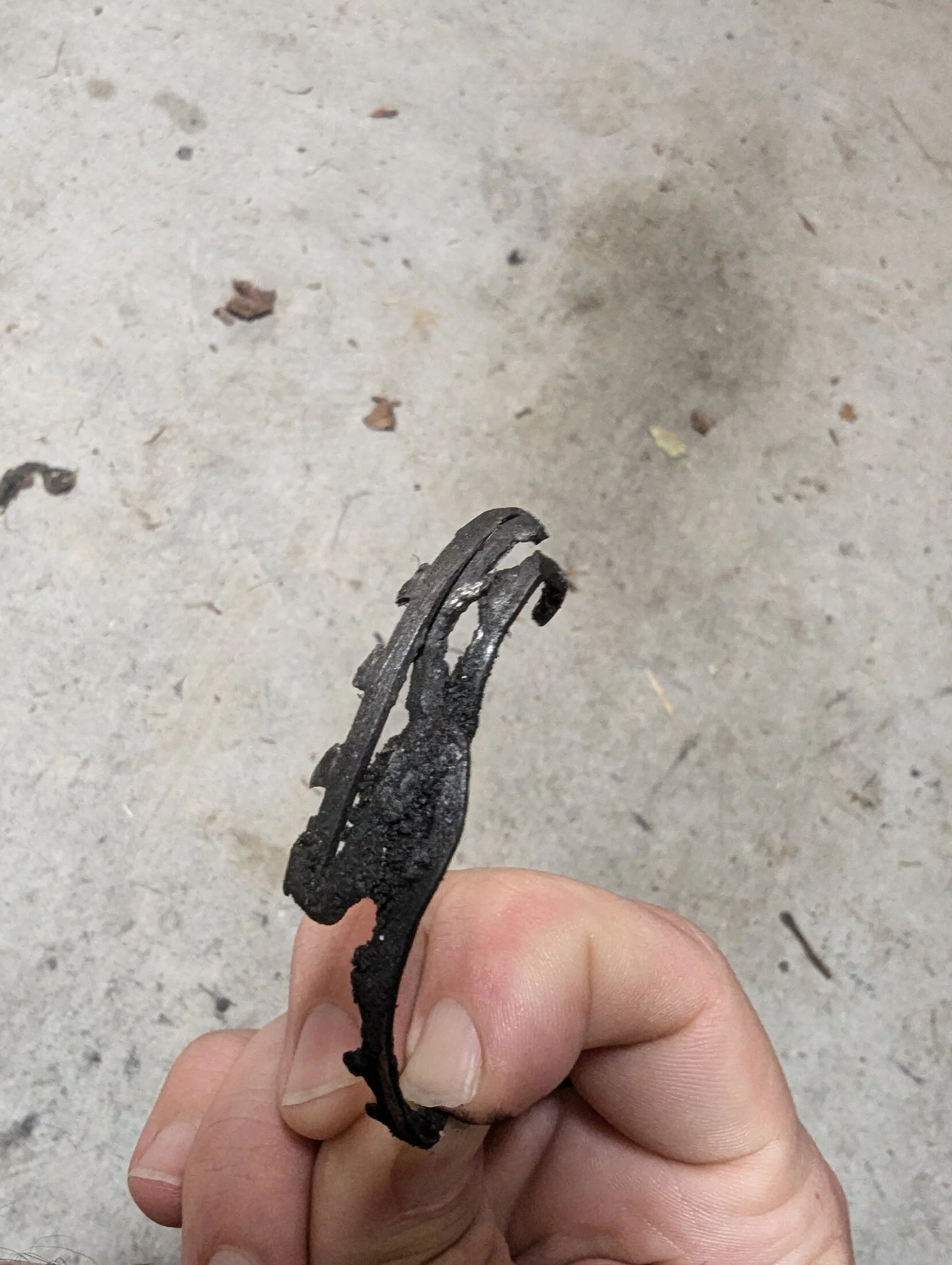

I'm trying to piece it all back together. I had to reboot my CVs recently, so I probably repacked them then. One interesting mystery was behind all that gunk, I found this piece of mangled wire/washer/something that was sticking into the outer bearing, or could have come out of the bearing. I'm scratching my head on this whole ordeal.
Pretty gnarly looking. That bit of metal is probably what's left of the cage (part of the bearing).

I'm normally pretty careful on all of my maintenance jobs but it's possible I screwed something up here. Not sure what though, I use my fish scale for pre load, I use bearing grease, pretty sure I packed them as good as usual. The brass bushing for the spindle bearing was pretty worn down which I've never seen before. It's possible I didn't grease that well at all.
It is quite possible that one of the bearing itself was faulty and broke down. Or perhaps the grease didn't penetrate the bearings completely. I really like this bearing packer to make sure I didn't accidentally leave any of the bearings dry: Amazon.com - https://www.amazon.com/Lisle-34550-Handy-Packer-Bearing/dp/B0002NYDYO
