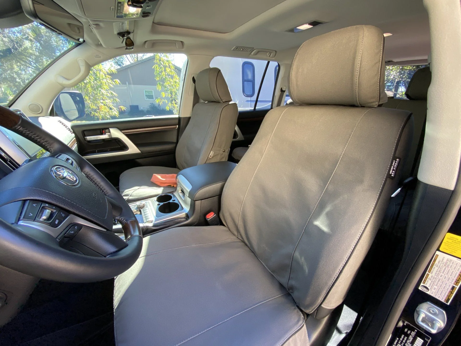

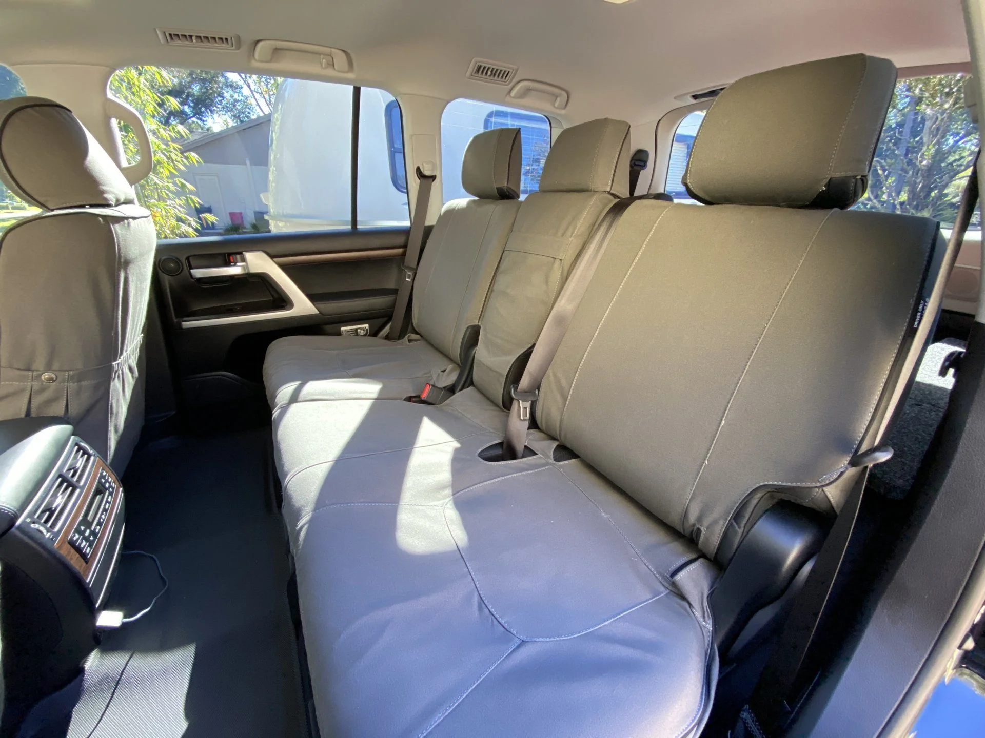

OK, it's a new day and with your help and less frustration it's done! Very happy with the look and the fit. Not inexpensive but the LC deserves the best!
A few extra notes: My 2015 does not have any lights involved, the 4 straps that are at the crux go under to the front 4 buckles, the 2 side straps get threaded under the seat and connect to the rear 2 buckles.

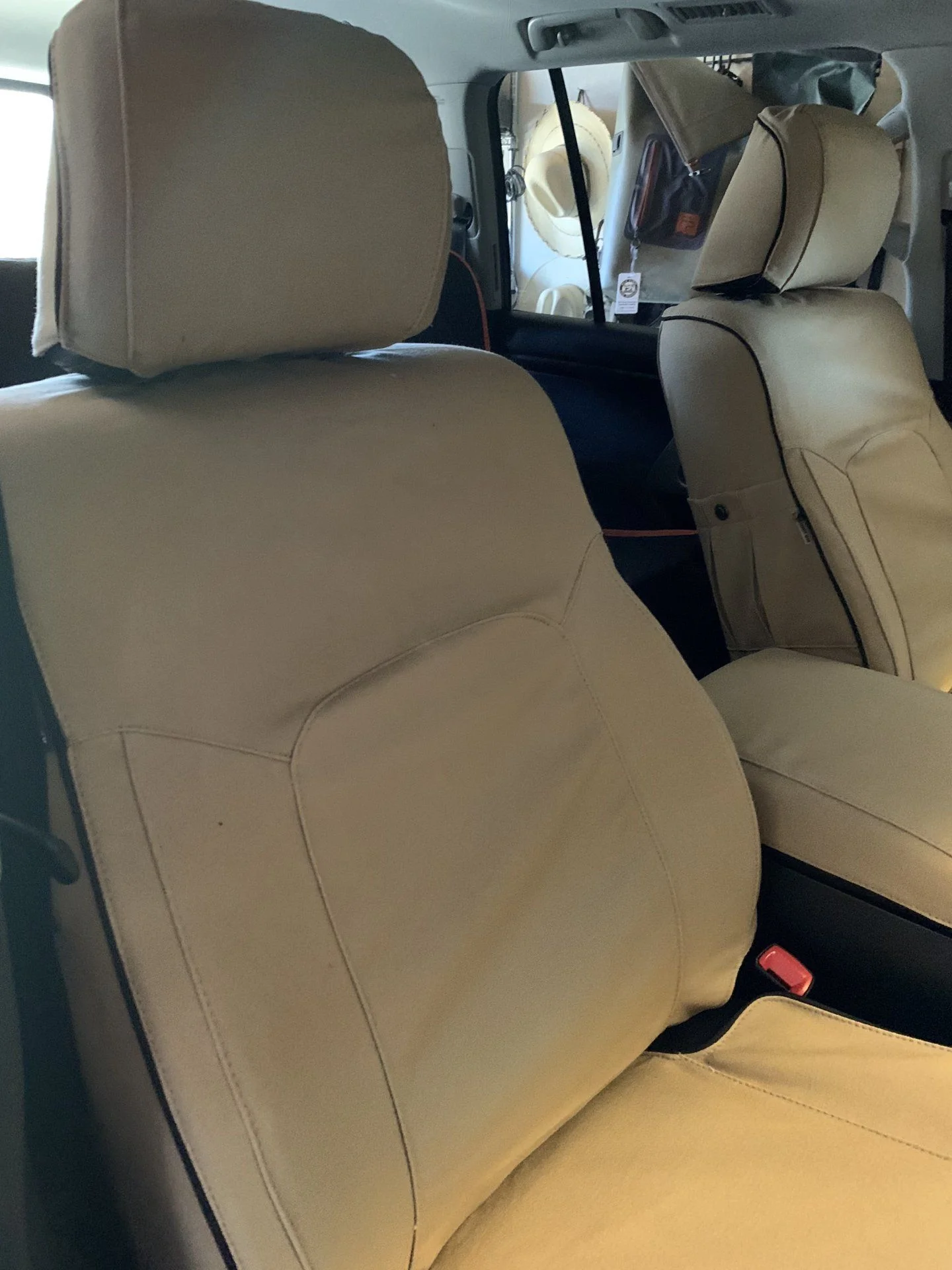

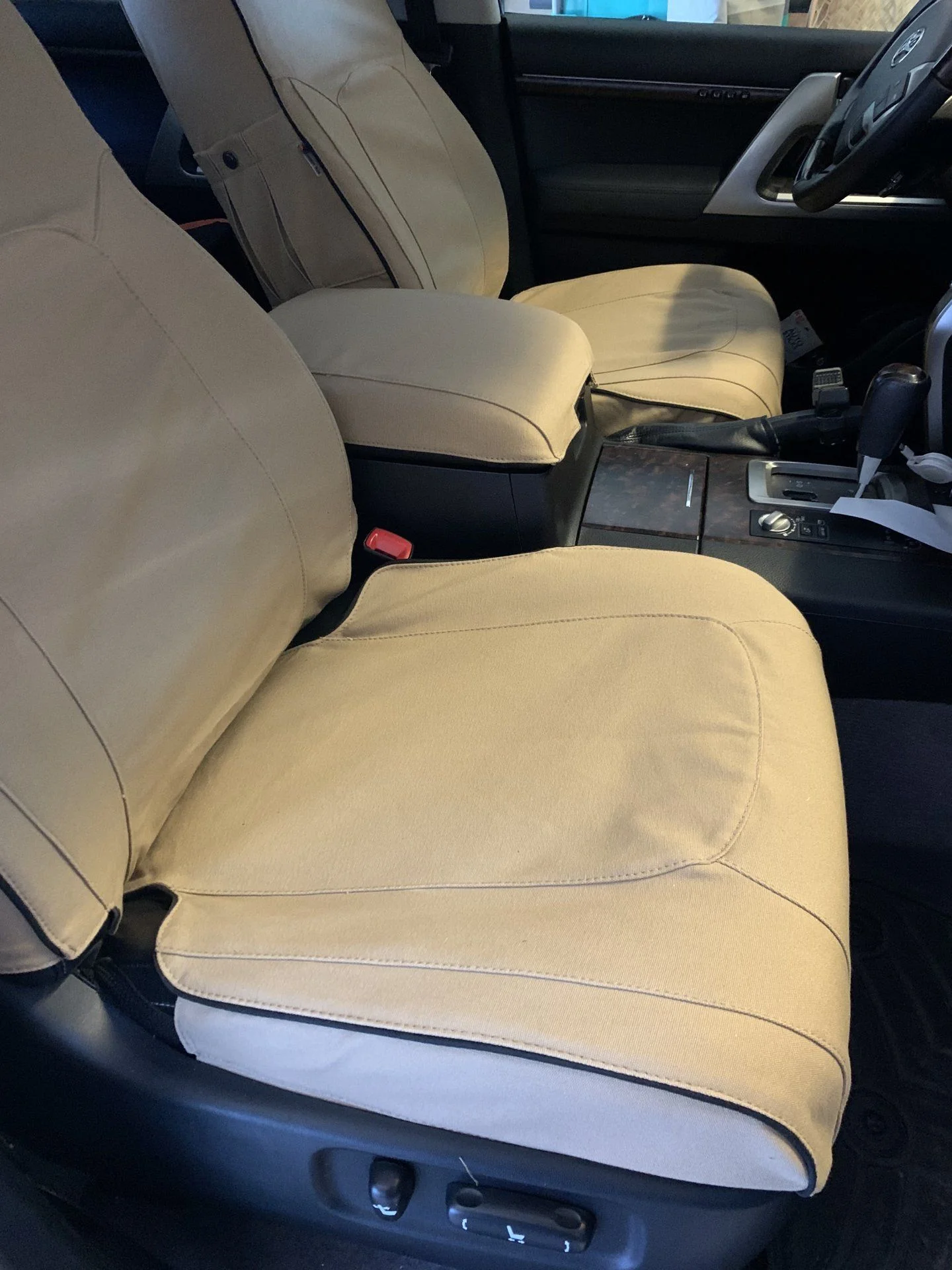

Finished product.
Looks pretty good from here!
