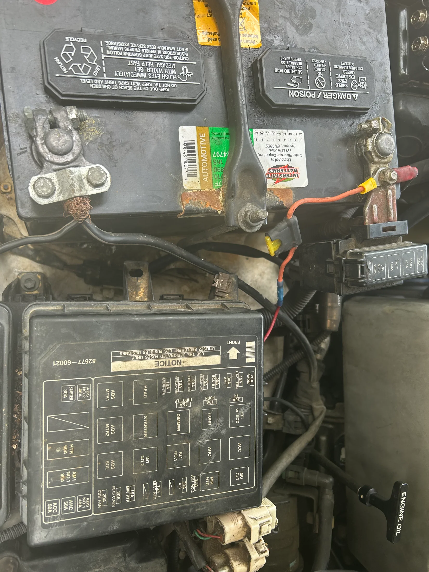

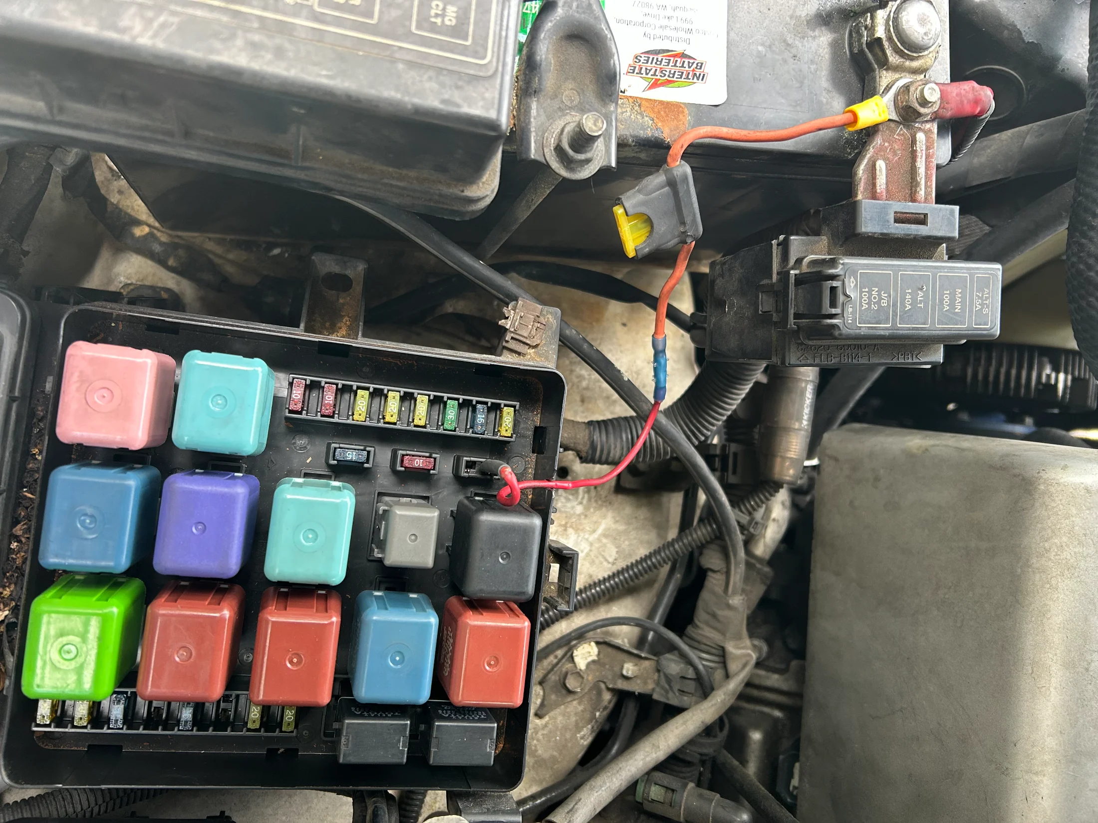

Hey All,
New to the group. I recently had the same fuel pump issue with my LX470. Local mechanic shop installed a new fuel pump and the 20A fuse kept blowing after installation. They completed the temporary fix seen in the pic which will hopefully work, but they told me I needed a new fuse box. My LX is the early 99 and requires the 82720-60022 part number. I can't find a new or used one anywhere and just wanted to confirm the 60023 is interchangeable with my year model before I spend the money. When I spoke to Lexus dealer they couldn't determine if the part numbers were interchangeable. I do have rear air if that makes a difference.
Appreciate any assistance.
Going through the same scenario right now! Per @Trapper50cal I ordered, installed and can confirm the 60023 variant is identical to the original fuse box I just removed from my '99 w/rear AC.
Even after the new fuse box, its still blowing the 20A fuse apart of the relay bypass kit...before the starter is engaged. More to follow...
FWIW, I purchased mine from japan-hideboo on eBay: 【NEW】Toyota Genuine Lexus LX470 BLOCK ASSY ENGINE ROOM JUNCTION 82720-60023 | eBay - https://www.ebay.com/itm/205122899505
It came with all fuses and relays EXCEPT: The EFI relay and the 3-ABS relays (which are a PITA to remove from the original fuse box).
HTH.
