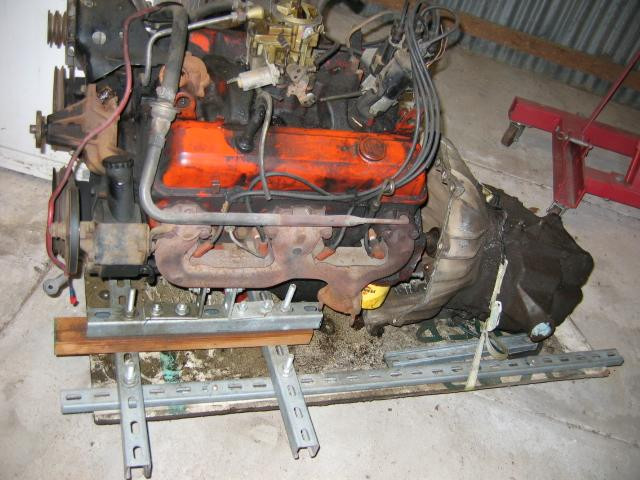

    Mine is made up of two dollies similar to the one pictured above joined together with a plywood deck....
    uni-strut makes it adjustable (and I don't have a welder yet). Its really sturdy and stable.
    [​IMG]
