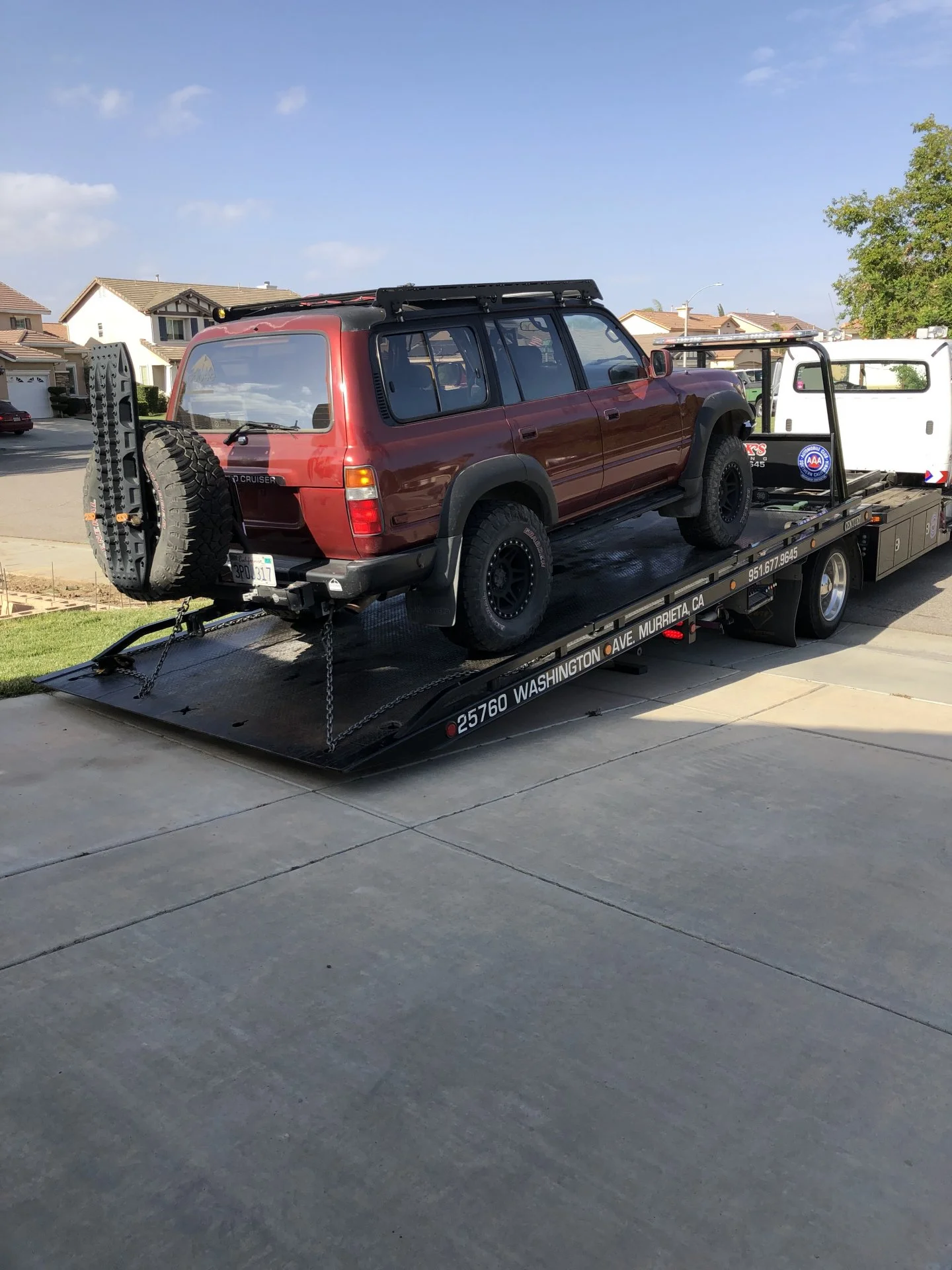

On a trip back from Prescott, Arizona the engine on the Goose Gear 80 blew. o_O I've been searching the mud forums on LS swaps (as well as others), but most seem dated. With the laws in California constantly changing I thought I would seek some fresh advice on the topic. My first thought was to put the LS3 e-rod CARB compliant long-block motor in but found it is only certified pre OBD II (95' and before). Looking at the BAR website the requirements are vague. The motor has to come from a donor car that is the same model year or newer and emit less smog than the motor it is replacing. It also must come from the class of vehicle.
What information I am looking for is what LS motor should I look to use in it and what cars or trucks contain this engine? I want this motor to get certified by the referee in California. I am not looking for a motor with massive power. Something in the 300 - 400+ hp range would be perfect. I would also consider the Cummins 2.8, if anyone has gotten it certified in California. Other ideas outside of these platforms are welcome, too. I am starting the journey on this project and all mud help is welcome. Thank you ahead of time to all of you who give advice.
