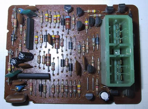

Where is the Emission Control Computer on my 60? Do these go bad and are they spendy to replace?
Background: I've been chasing EGR symptoms for too long now (bucking under acceleration). My EGR, Modulator, and VSV for the EGR system all check out OK per the FSM. But my rig still bucks unless I bypass the EGR. One test I do fail is at the bottom of page 3-16 in the FSM. If I increase RPM to over 1,500 and blow into port F, I don't get air from port E. Could this indicate faulty Emission Control Computer? Would it cause bucking?

Depending on the year, have you tried the fuel cut solenoid , the VSV's and cracks in hoses and reseated the electrical connections.
Yes they do go bad, I replaced one.
Behind one of the front kick panels, mine said 2F emissions right on it.
Mine (1985 FJ60) is behind the drivers side kick panel. It's inside a black plastic box that does say 2F emissions. Here's a picture of what's inside. Using the term "computer" is a bit of a stretch. Do a search. There are some threads about folks that have repaired theirs, but how to troubleshoot what's wrong is a little bit beyond me.

Do you mean at the computer? I'll give that a go when I get a chance.
Thanks! I was at a loss where to look.
