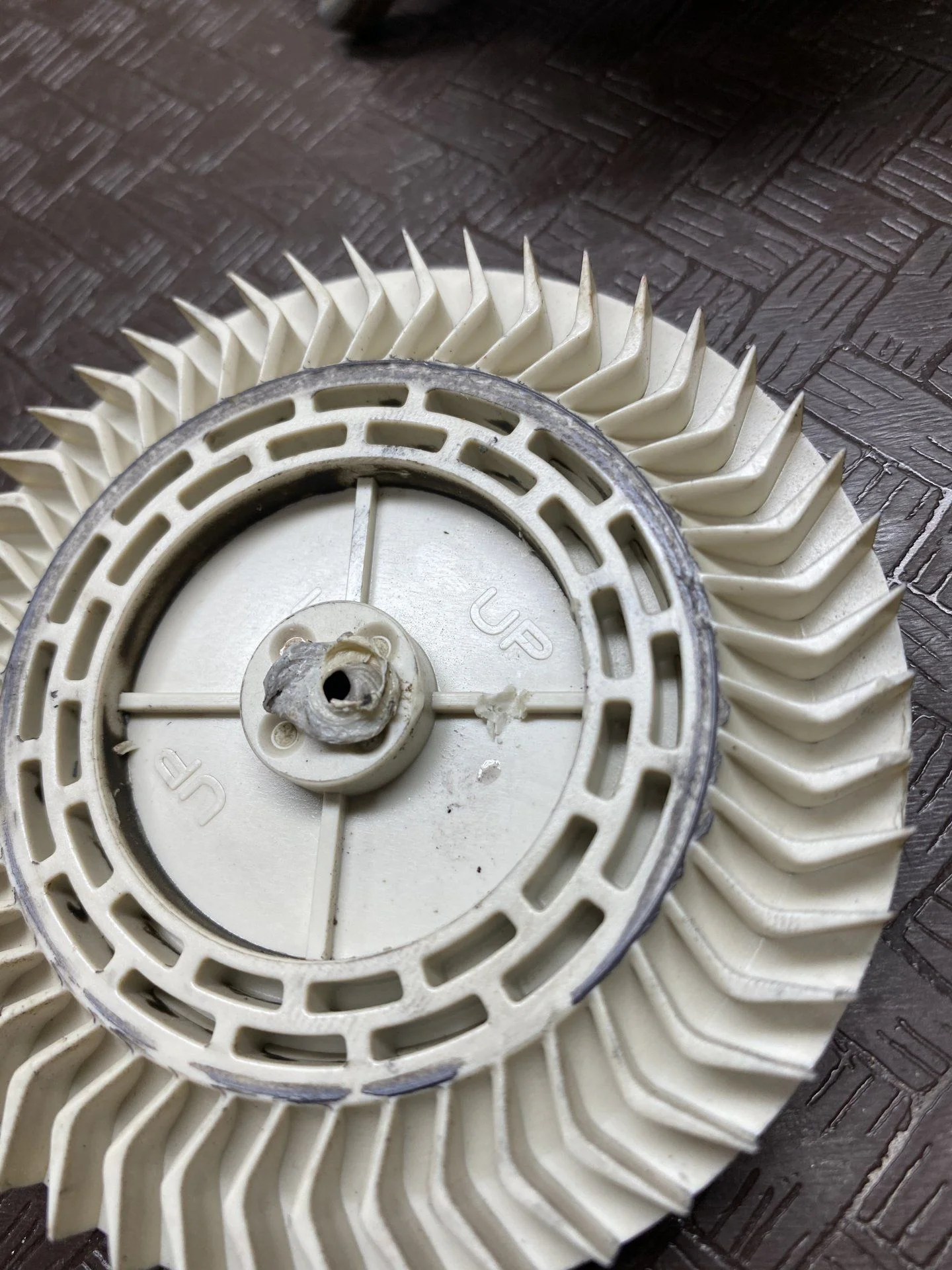

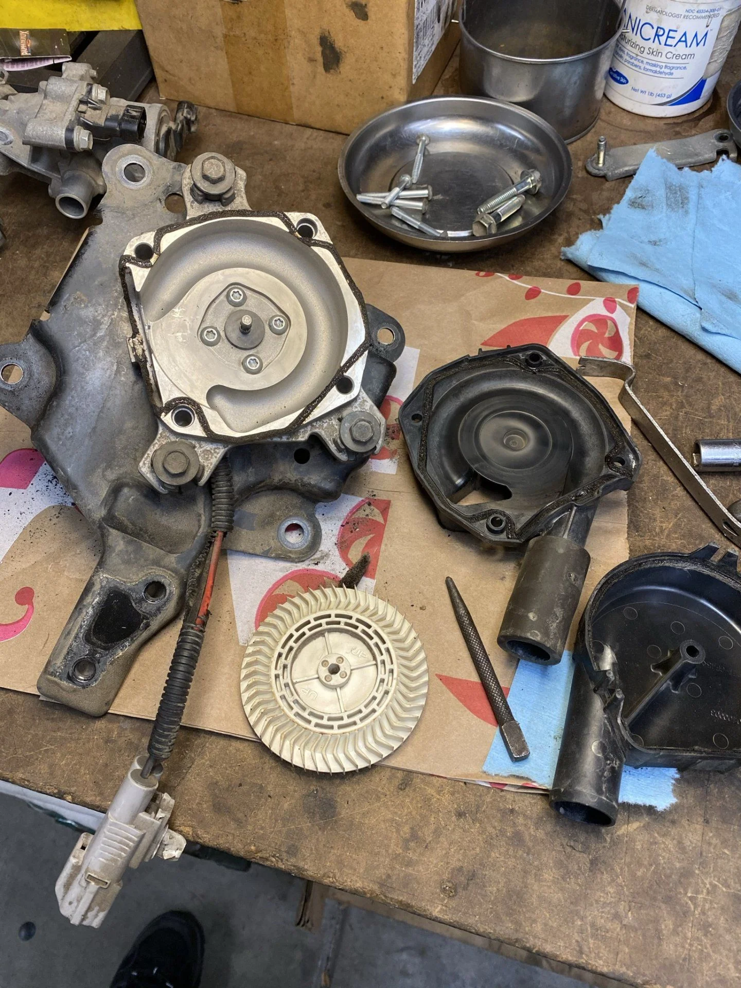

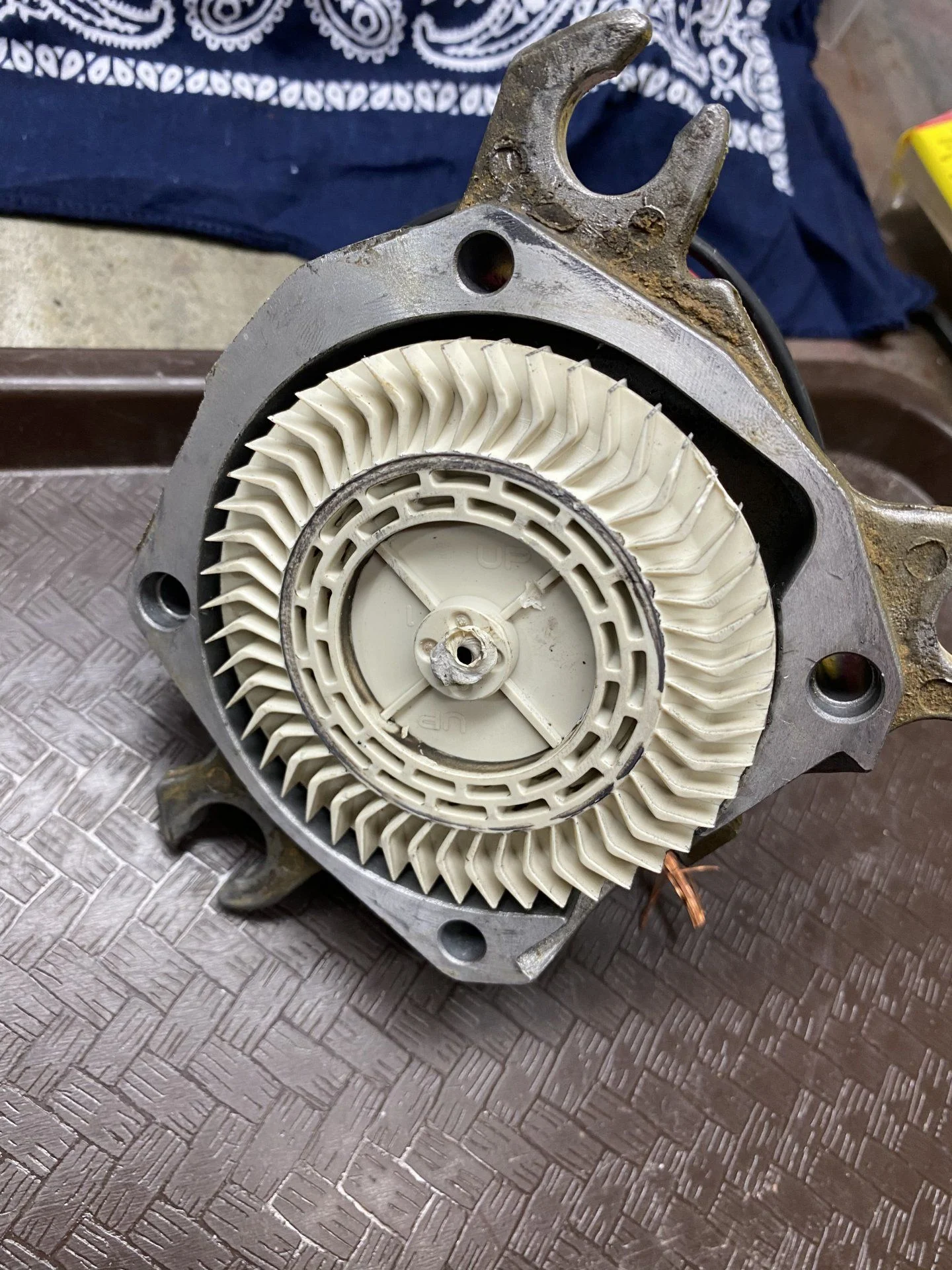

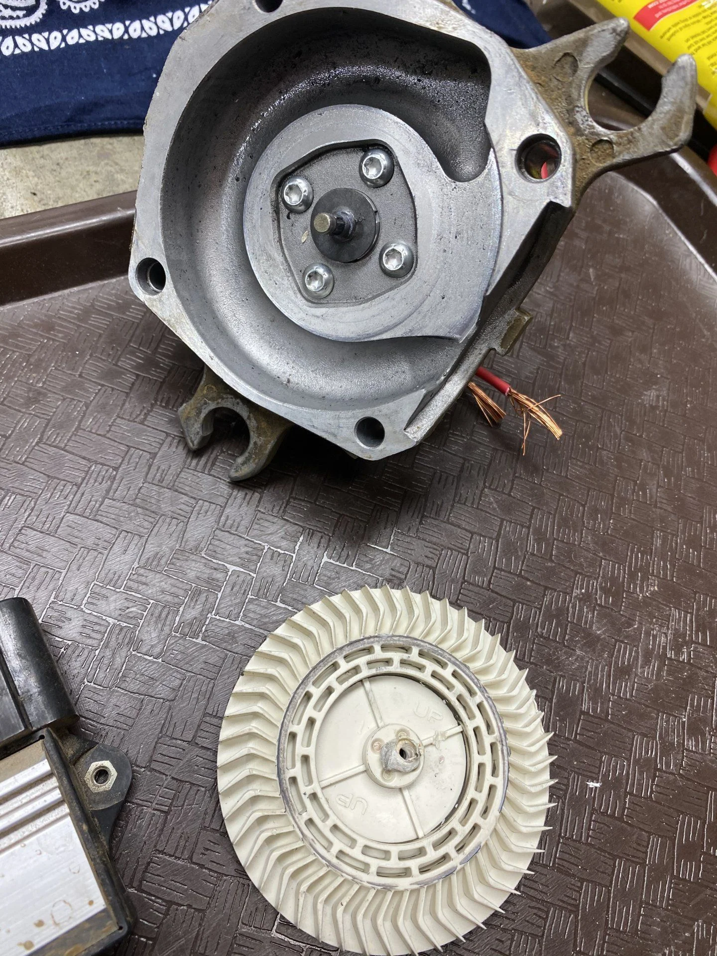

Ok, final diagnosis and parts required to fix...
There are two “control modules” (AKA fancy relays I’m told) under the hood that control this emissions equipment and two air pumps (I think). These pumps move air during cold starts into the exhaust stream to help cats heat up quicker and start working ASAP. Tech stated that at least one relay was bad, he ordered both in and swapped until pump stopped running continuously. That was ~ $750 to fix (only one relay was bad).
Relay swapped and it was still throwing codes. Checked pumps and found one that sounded crunchy when running, ordered that pump and replaced it. Codes clear and truck runs perfect.
if you look at the pump pic the plastic turbine part is melted in the center where the shaft must’ve slipped and melted the center. This is not a serviceable part and it was replaced. The control module is also sealed and not serviceable. I am happy with my dealership experience. They took two days but that was only due to waiting on parts. I live in Chicagoland and the control modules were in the regional warehouse but the pump needed to be “shipped overnight” so if you are gonna tackle this yourself I’d order the pump and both control modules to have on hand then return what’s not needed. Access to pump is good if you have an ARB front bumper and I have no idea where the control modules are located but the bad one that came from my truck is pretty clean and shows no indication of water intrusion.
Grand total ~$1,700 (including new wiper blades and power steering system check up). I left the receipt at work so I don’t have the full breakdown on costs but let me know if anyone cares that much. I am sure I could’ve gotten it done locally for cheaper or spent a few days tracking the problem and waiting on parts but I needed it fixed ASAP for a spring break road trip with the family this weekend. All is well but I have only put ten miles on it and two cold starts... so fingers crossed.

Please see pics for additional details
Odds are the drivers (you called them control modules or fancy relays) were fine and that hosed impeller was the issue all along.

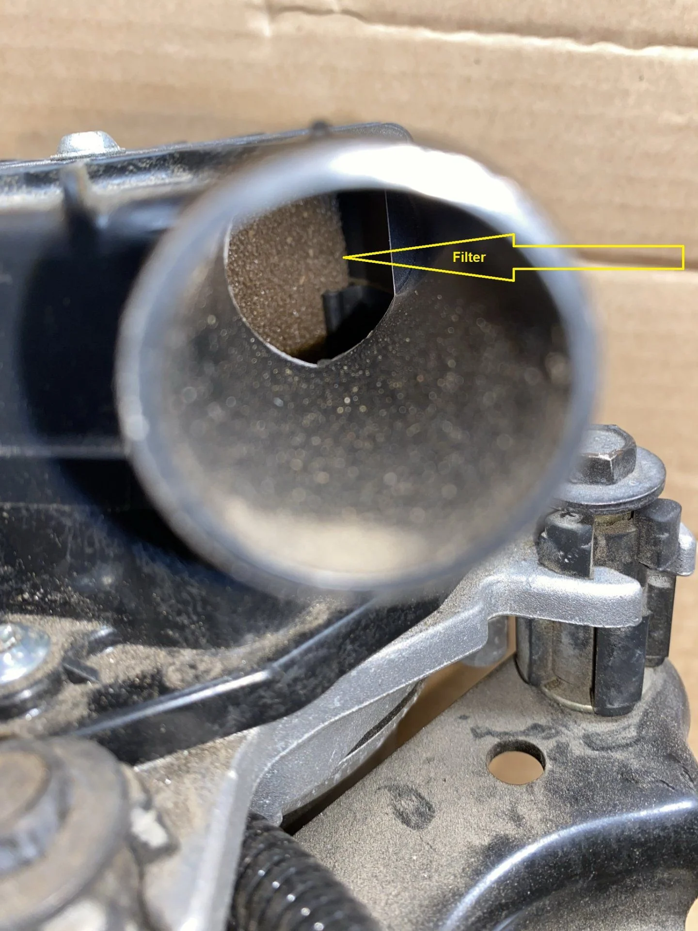

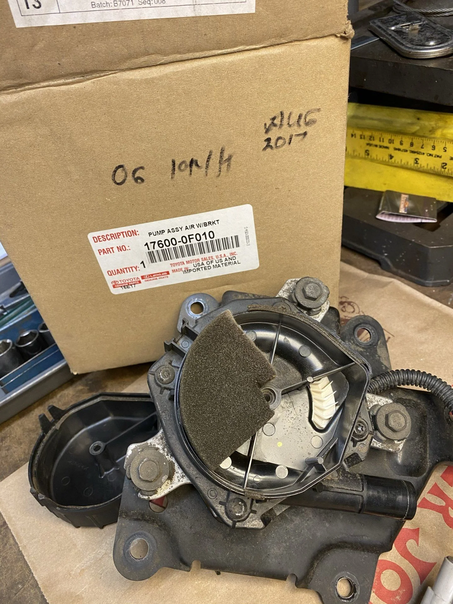

Interesting thread. Did your A.I pump have a filter?
I'm doing some researching on the 100 series, with respect to A.I system and all DTC set off involving environmental components.
I find very strange the pump would run IG off. As it is designed to run on cold start up only. Likely an example of new age engineers integrating systems. As we do have various system powered IG off, like fuel system vapor pump running hours after shut-down. Perhaps that is where hot lead with IG comes into play.
@GoISU Interesting you fan blade melted at shaft. My guess, is this in part due to, motor of fan run contentiously. They're designed to run high speed for short spurts (~90 sec). But even so, I suspect something jamb the blade from turning as motor ran. Than as the motor ran the shaft spun with the plastic fan stopped. Shaft spinning would create heat and that could melt plastic.
But if my theory of something jamming fan blade correct, what was it and how did it get in.
One thing I'm working on now in the 100 series, is a filter in these A.I pumps. I'm looking for evidence from others on missing filter. Is it missing? when and how. The how & why. Was it small rodents or just age, or environmental related disintegration. Why in some and not others.????:hmm:
Did yours have a filter?
Which I do not see in your pictures and to be honesty I've not look at the 200 series A.I pump.
Here's the 100 series A.I pump and filter.
