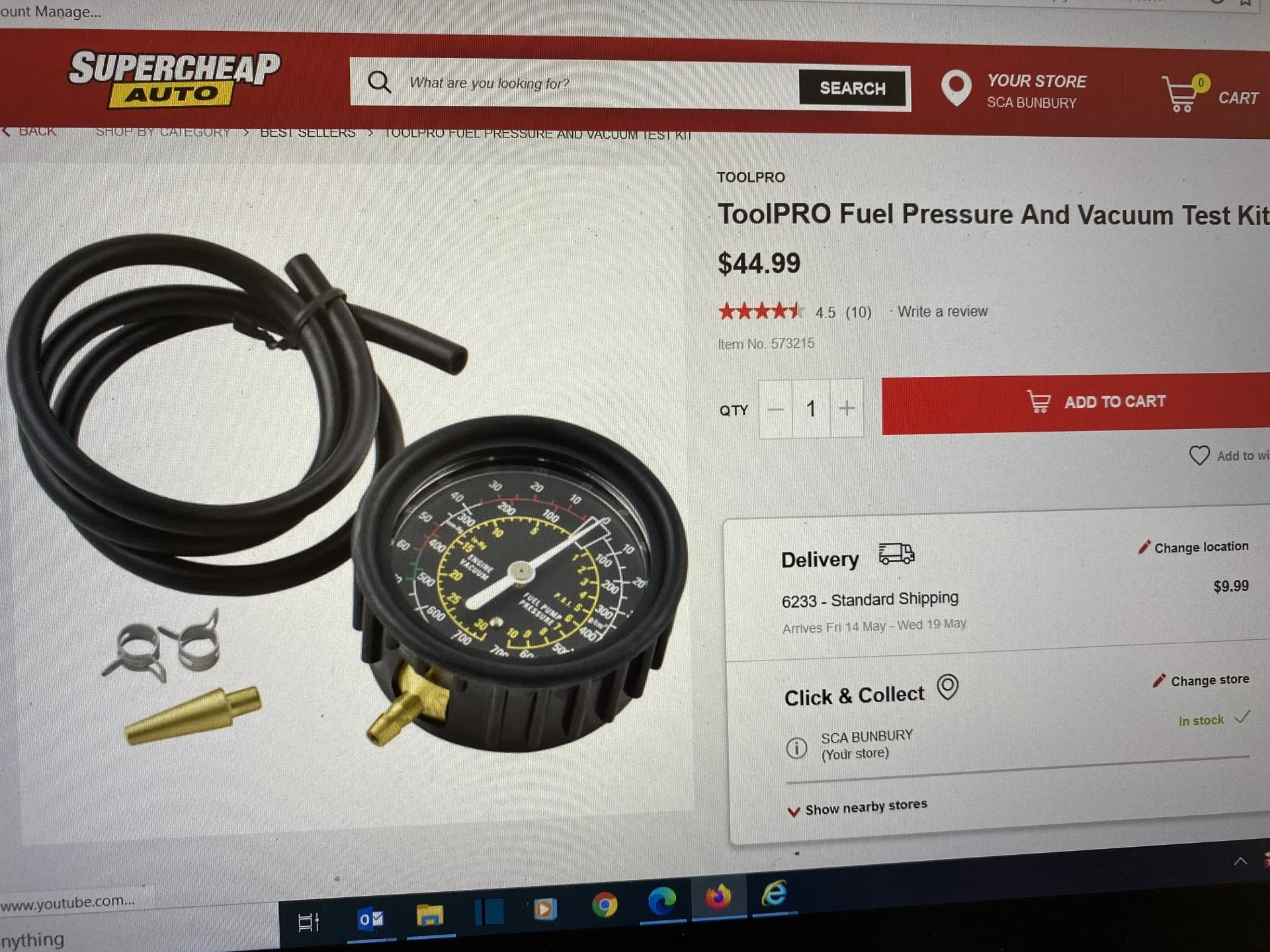

the gauge I got was way to high pressure so it was very hard to see any small changes. I might try again tomorrow. There was one thing that happened yesterday at about the same time that I noticed the boost pressure swing. The alternator had quit working, this morning I found a plug had come loose therefore turning off the alternator. Don't know if the plug was creating enough contact and then loosening enough to cause the alternator to come on/then go off due to the vibration?
Jun 24, 2014
517
Western Australia
Would this suit (up to 10psi)?
